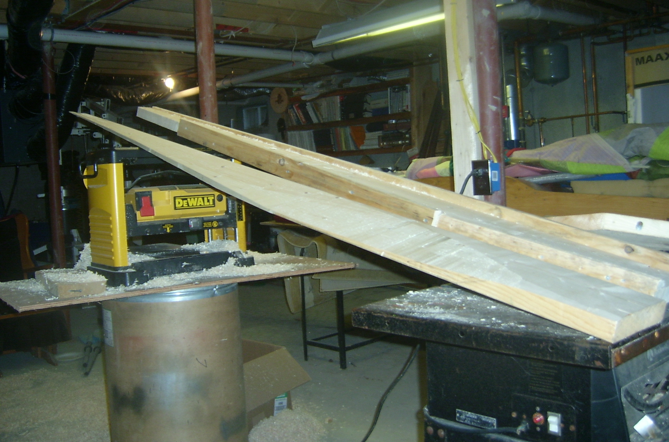

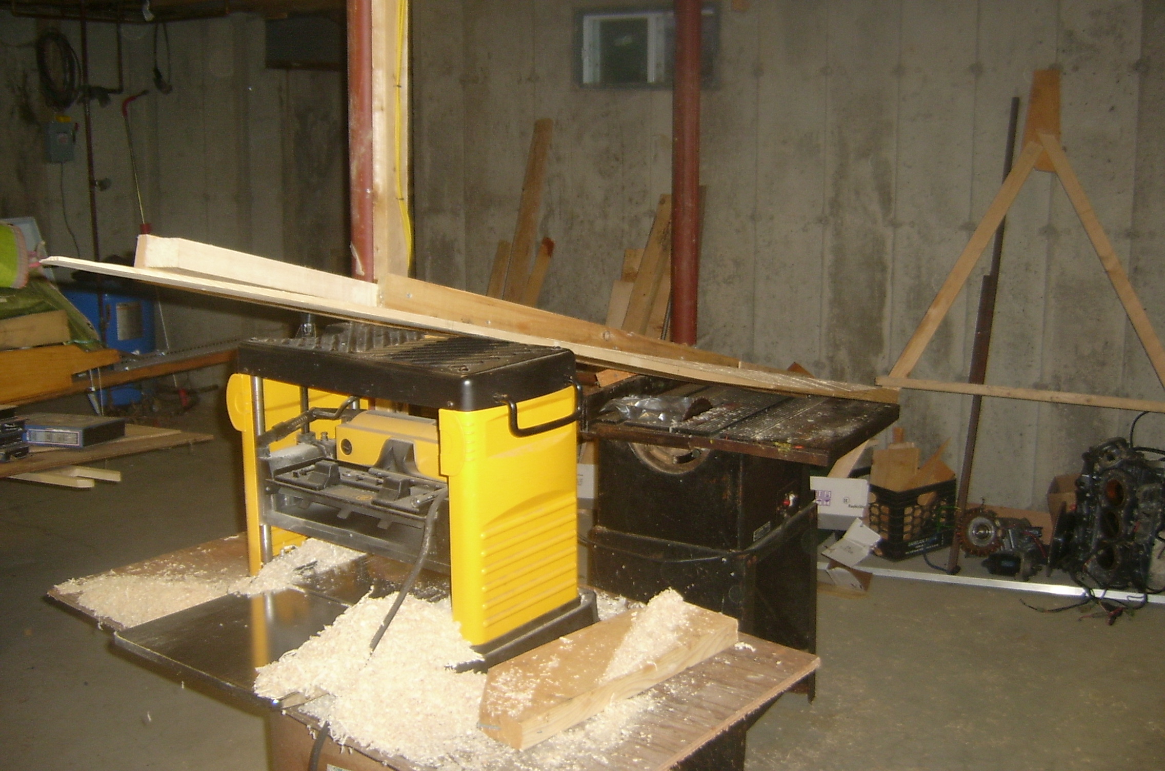

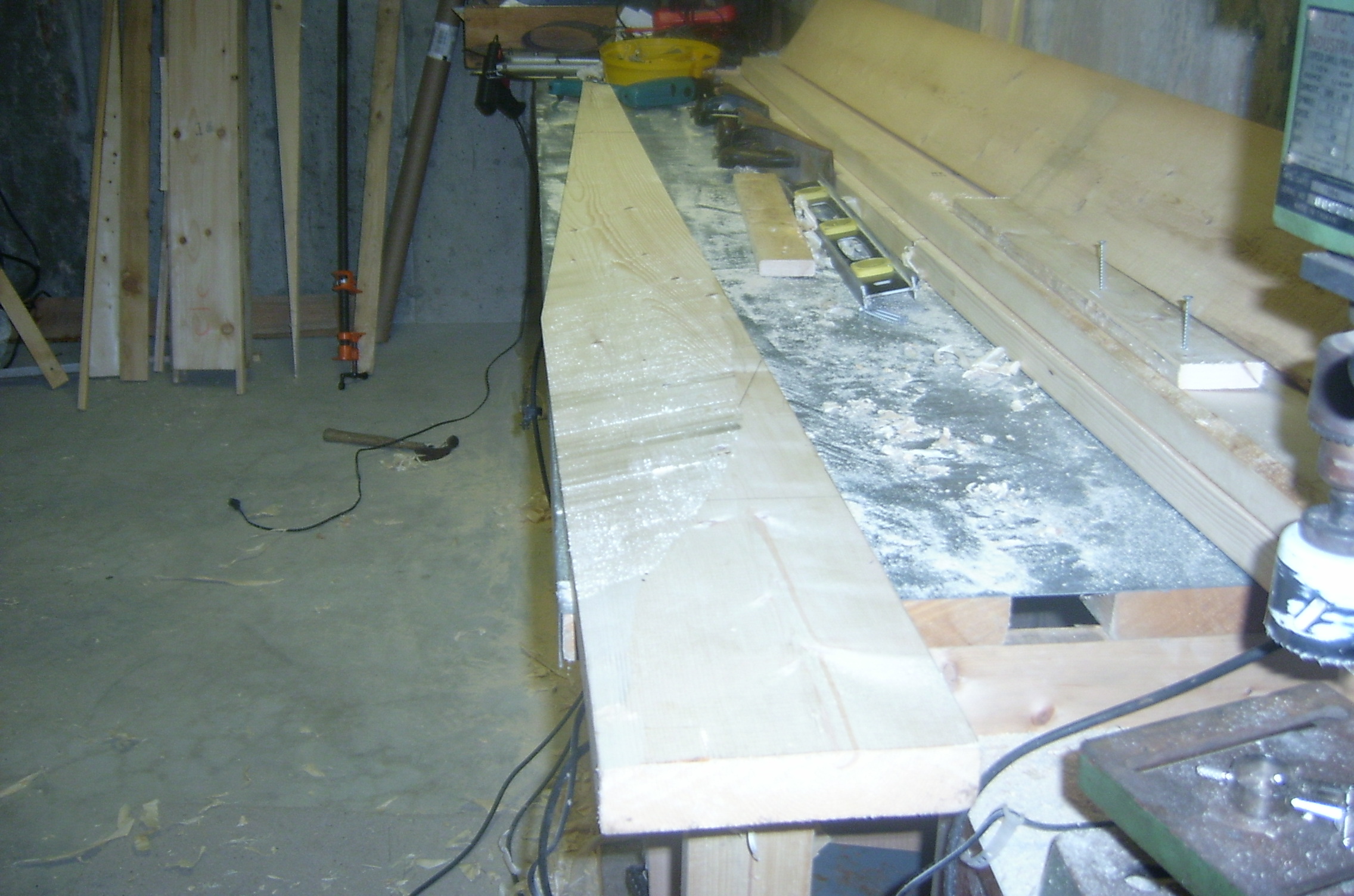

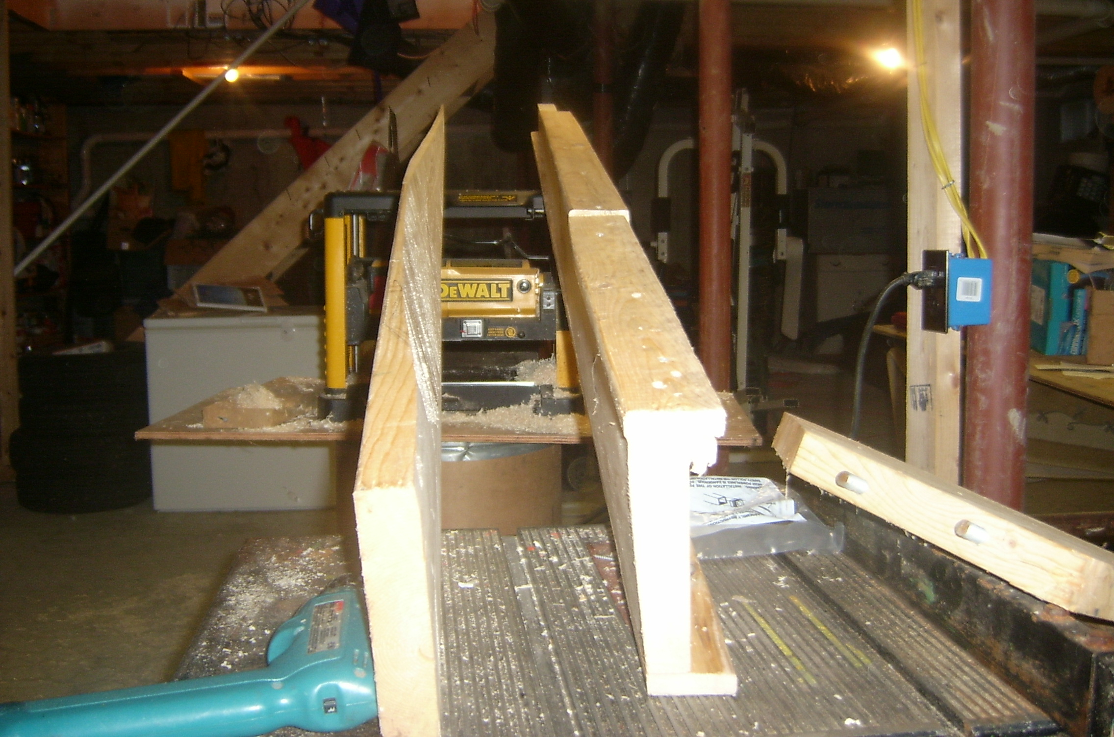

I spent most of the night in the basement with my dewalt planer annoying my wife while she tried to hear the tv. I made two sleds. One for the back and one for the front. The backside cut came out quite nice. When cutting the frontside my planer hangs up near the root area further away from the root with each cut. I could get about two thirds of the blade through the planer before I would have to start backing of the cutter head to allow the root of the blade to pass under the feed rollers and cutter head. I had to keep count of the amount of turns that I backed off and then add one turn to that amount for the next pass. Other than the root area not being deep enough the one blade that I produced came out quite nice. I'll try to get some pics on here for you guys tomorrow night.
« Last Edit: November 07, 2005, 08:22:59 PM by Propwash »
Propwash
  • Posts: 84
Re: blades
« Reply #12 on: November 09, 2005, 04:39:34 AM »

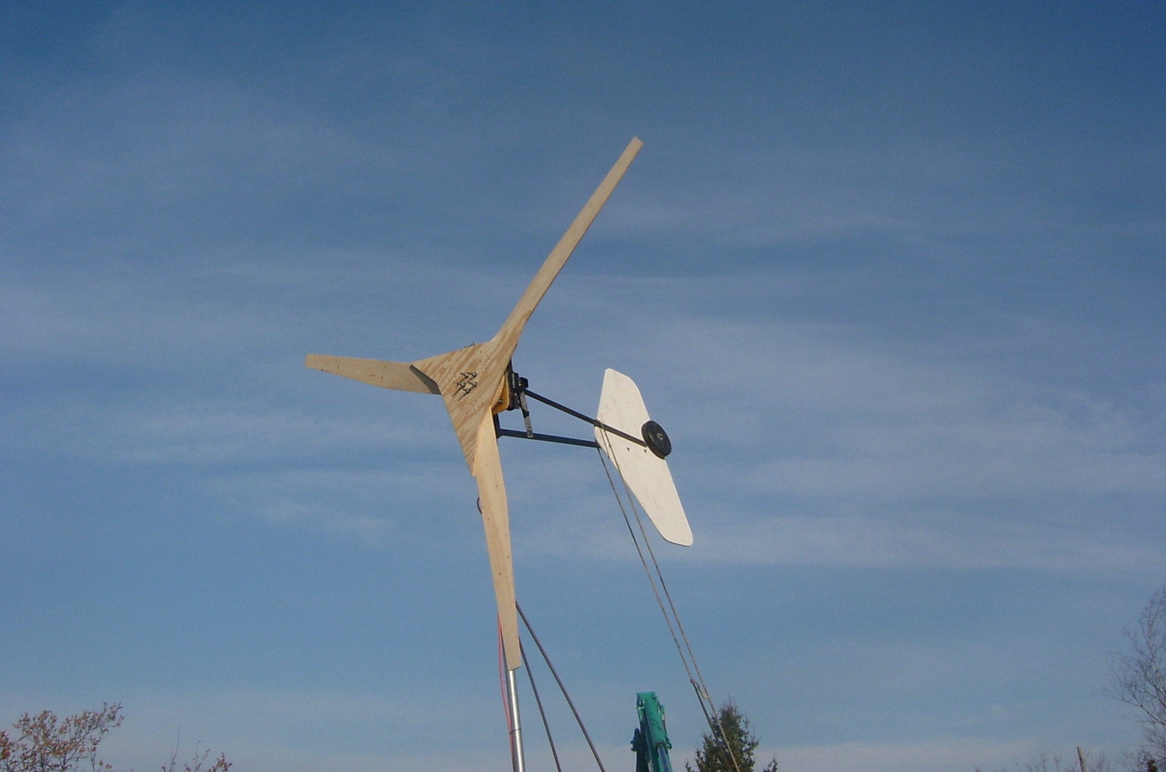

Here are a few random pictures of blades made on a planer. I left the stock 8' so I would not have a problem with snipes.

rotornuts
  • Posts: 537
Re: blades
« Reply #13 on: November 09, 2005, 10:05:27 PM »
That's absolutely fantastic. Count yourself as one of those clever folks.

I did take off one of the tables to keep it from hanging up so soon in the root area but it didn't help that much. The root area cleaned up quite quickly with a few swipes with a disc sander. I have not made a jig yet to do the trailing edge but I am quite sure that can be done as well. It is quite rewarding to watch a blade develop as it comes through the planer. I probably could have made two sets of blades by now by hand but this is much more fun. If my mill works out I'm sure my buddies will be needing some blades manufactured anyhow.
