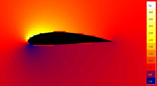

The _air_ doesn't propagate upwind, but a pressure wave does - otherwise how does the wind upstream of the turbine know to slow down?
See that blue bulge? High pressure, upwind (down the screen) from the blade.

The figure doesn't show the direction of air flow, so one actually doesn't know the direction of the incident air and the attack angle.  In any case, the pressure build up is slight.  You need to relate the situation to that of the wind turbine.  One could envision the area of high pressure as a wake that tends to move down wind between the blades.  Then it affects the following blade.  If some higher pressure is left on the windward side of the blade assembly, on average it would act as a whole to cause air to spill around the entire turbine.  It doesn't cause air flow up wind.  It would rob power.

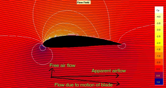

Sorry, I should have added more details. The apparent angle of the airflow is 10° (roughly deriving from a TSR of 6), and the angle of attack of the blade is 6°, giving an airflow in the image of 4° from the chordline of the blade.
The black lines are streamlines. The white lines are iso Cp lines. They help to clearly show the high pressure zone on the flat underside of the blade, which is pointing upwind (in the free air flow).
"If some higher pressure is left on the windward side of the blade assembly, on average it would act as a whole to cause air to spill around the entire turbine.  It doesn't cause air flow up wind.  It would rob power."
Yes, exactly. As I understand it, this is what causes Betz' limit. The more lift our blades derive from the wind, the more they slow the wind, causing more air to flow around the turbine instead of through it.

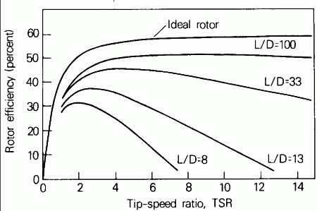

Tom is correct. It may be clearer if you think in terms of air mass velocity rather than flow. The pressure front upwind of the rotor disk slows the velocity at the rotor to less than the free-stream velocity.
In the ideal rotor (Betz limit), the velocity far downwind should be one-third the far upwind (free-stream) velocity. The velocity at the rotor should be the average of the free-stream velocity and the far downwind velocity, or two-thirds of the free-stream velocity. Hence, the slowing of the upwind velocity should be one-third of the free-stream velocity for maximum power extraction.
I don't believe I've seen Lift to Drag ratio (L/D) mentioned in this discussion. This is the single, most significant factor effecting rotor efficiency and I find it astounding that it is generally ignored by the DIY blade carvers. Arbitrary airfoils seem to be the order of the day.

GeoM - "There's another factor here.  You are trying to use a static situation to model a dynamic one."
Am I? In the image above, I was modelling TSR=6, hence the blade moving at about 6 times the windspeed. How is this a static situation?
GeoM - "So, you really need wind tunnel data for the dynamic case.  Which brings me to your curves.  It would be nice if you would tell everyone what they purport to represent."
The image above is from the JavaFoil simulation, which is about as close to a windtunnel as I can afford to get. It's supposed to be fairly accurate, though.

SamoaPower - "I don't believe I've seen Lift to Drag ratio (L/D) mentioned in this discussion."
Ah! Maths! OK, my program does take account of drag, but when I see Lift/Drag rations quoted, is the drag the Parasitic drag, the drag due to lift-in-the-wrong-direction (lift counteracting the required torque on the blade) or both combined?
Also, a very newbie question which I've been unable to find the answer for (I need an "aerodynamics for dummies" book): I've been assuming that drag (Cd) acts in the direction of the incoming airflow, but which direction does the lift (Cl) act in? At right angles to the incoming airflow, or at right angles to the chord line, or some other direction?
SamoaPower: given that the "Ideal rotor" is just a model and doesn't actually _have_ a TSR, why does its theoretical maximum efficiency drop to zero at zero TSR?

I haven't been associated with wind tunnel measurements so am guessing somewhat to answer your question. I believe that Cd represents total drag in the airflow direction. Of course, in wind tunnel measurements, the airfoil is held stationary and pressure measurements are taken at various points along it's surfaces. The coefficients are then calculated from these. Measurements are not taken from a rotor. I also believe that Cl is perpendicular to the chord line.
I think the answer to your TSR question is obvious, so I probably don't understand the question.
TSR = Tip Speed/Windspeed. For TSR = 0, Tip Speed = 0 (non-rotation). No rotation, Cp = 0.
I haven't seen the derivation of the ideal model but I do accept it. I think it must be based on the basic physics and doesn't include a physical rotor.

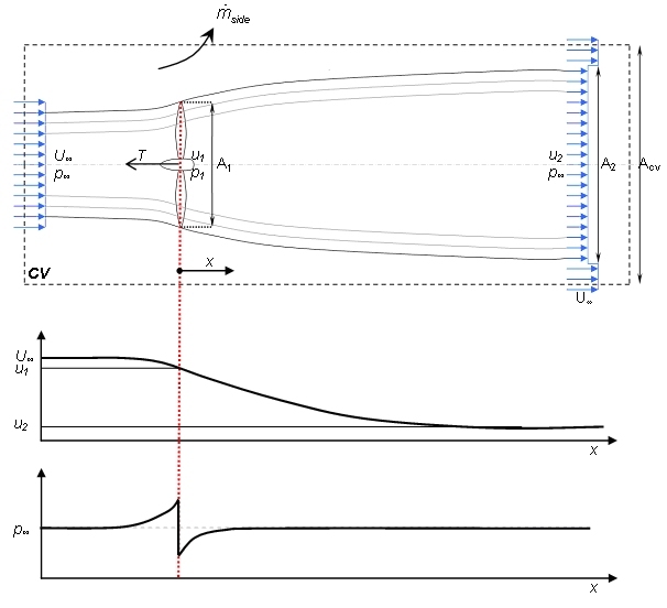

I think I've worked it out! I found this very helpful page:
Froude's Momentum Theory for an Actuator Disk
which derives the normal, actuator-disk model (which makes no reference to rotation or TSR). Then, at the bottom, it goes into the advanced model, which considers rotation in the flow. And, although the maths is scary, I _think_ I gathered that as the TSR drops, the turbine (regardless of its detailed design) needs to "spin" the air more to extract the energy from it. This leaves the wake behind the turbine spinning, which is an energy "leak".
So, in two words: rotational losses.  Odd that a faster-spinning rotor leaves less rotation in its wake, but that seems to be the case...
All of which suggests that a twin-rotor, contra-rotating design might be effective at very low TSR? Has _anyone_ ever bothered to build one of those beasts? I know 'planes have been built with contraprops, but I've never seen a wind turbine like that.
« Last Edit: March 24, 2007, 06:15:26 PM by TomG »

Yes, I think you've got it. Thank you very much for that link. I had written the velocity relationships in my notes some thirty years ago but had neglected to include the derivation. Your reference ties it all back together for me. I think equations 28/29 say it.
I was aware of the rotational losses (swirl effect) but had not really considered the magnitude at low TSR since such low RPM isn't very useful for electrical generation. I guess it's possible to reduce rotational losses but I'm not sure it's worth the effort for the same reasons.

I'm glad you decided to show the air streams.  That is more useful than the pressure per se.  If you rotate the blade counter-clockwise by ten degrees, you more closely show the moving blade.  Note that the air on the windward side moves smoothly without any wake along the blade in spite of the slight region of pressure build up.  So, it is possible that each blade is always operating in undisturbed air.  It's too bad we do not have actual velocity values.

The curve I was wondering about was the one that showed a sharp rise at the front of the turbine and a sharp drop at the back of it.  This looked like the pressure distribution one would expect at the center of a solid disk, but the label looked like a D.  It's a good idea to always tell what a curve shows.  Still more farther down.

I took a look at the link and my reaction is: Bull Sh**.  Well, maybe that's a bit strong.  I have no prejudice against theoretical analysis, but one should be skeptical about its application.
Let's take a look at the assumptions as they might apply to a solid disk or a wind turbine:
  1. 1-Dimensional analysis and disk is essentially a discontinuity moving    through the fluid
  2. Infinitesimally thin disk of area A which offers no resistance to fluid passing through it as frictional forces are negligible compared with momentum flux and pressure changes (hence can make assumption 5)
  3. Thrust loading and velocity is uniform over disk
  4. Far-field is at free-stream pressure but far up and downstream
  5. Inviscid (thus irrotational), incompressible and isentropic flow
One dimensional analysis?  Forget that.  That's wrong to start with since the air flow is deflected and flows around the disk.  The turbine as a whole isn't moving.
Only the blades are.  Two is obviously wrong.  Three is wrong because one is wrong.  Four may be nearly correct for a solid disk but is manifestly wrong for a turbine producing power.  Five may be a useful set of constraints.
The question of the turbine spinning the air behind it came up before in a discussion with Anthony.  I don't believe it happens, but it is something that could be tested in a wind tunnel using smoke in the air stream.  So could this idea of a pressure build up in front of the turbine.

I'm not going to go into those points one by one. Suffice it to say that those assumptions are what the VERY SIMPLISTIC model was based on. My whole point was that the very simple model doesn't make sense, so I agree with you on that.
Hence the need for the more complex analysis, which takes into account many more effects, including rotation.
"The question of the turbine spinning the air behind it came up before in a discussion with Anthony.  I don't believe it happens, but it is something that could be tested in a wind tunnel using smoke in the air stream.  So could this idea of a pressure build up in front of the turbine."
They both have been. See:
http://www.risoe.dk/vea-aed/numwind/results.htm - especially the first and second images.
http://www.aero.gla.ac.uk/Research/LowSpeedAero/images/lsawake.gif
And particularly clearly in
http://www.fluent.com/about/news/newsletters/02v11i1/img/a1i6_lg.gif
where the upstream flow lines (left) are straight and parallel, and the downstream lines (right) spiral around each other.
http://allentech.net/about/images/windtunnel-flow-280w.gif
Similar processes for an aircraft rotor:
http://rotorcraft.arc.nasa.gov/cfd/CFD4/New_Page/Pics/v22_rwake.gif
Small image, but you can _see_ the trailing vortices:
http://www.sbe.hw.ac.uk/research/flic/pics/fl01a.jpg
Anyway, if all that doesn't convince you, you're going to have to stand upwind of a turbine with a smoke-stick...
I'm not sure how to convince you that there's a high-pressure zone upwind of a turbine. Too tired, late at night. But if there isn't, then what causes 1/3rd of the wind to go around the turbine instead of through it?
« Last Edit: March 25, 2007, 02:05:45 PM by TomG »

"Some people espouse maximizing the ratio of the lift coefficient to the drag coefficient."
and
"A similar issue will exist for the ratio L/D."
What?
The second IS the first.
"... it has the effect of setting the value of the attack angle, which might not prove to be ideal for an actual operating turbine, which has to deal with a wide range of wind conditions."
Of course it establishes the correct Angle of Attack (AOA) (typically, 3-8 degrees). The polars derived from wind tunnel tests (hopefully done at low Reynolds numbers applicable to wind turbines) of a given airfoil, relate Cd to Cl to AOA which is what is need to properly design a blade.
There is an additional correction factor needed to account for the blade aspect ratio but you need the AOA to calculate it.
What constitutes a less than ideal AOA for an actual turbine and what are the wind conditions you are concerned about?
"What values of L/D work well for an actual operating wind turbine?"
Refer to the chart in an above comment. It depends on what value of Cp you are willing to settle for. If the average DIY rotor has a Cp of 0.3 and if there are practical ways to improve that to say 0.45, wouldn't you want to do it? An L/D of 100 is good to shoot for.
Higher L/D isn't the only way to improve Cp, but it is the most significant parameter and is not difficult to implement.
"The situation is made more complicated by the fact that people really give up trying to match the blade characteristics to the apparent wind toward the root."
And rightly so. The area of the blade inside the 20% radius contributes little (4%)to the rotor power output. This region should be more given over to the structural requirements of the blade.
"... perhaps you should write a computer program for some of the common air foil profiles to see what attack angles would give the best ratios of L/D over the entire blade length for say a TSR of 7."
Why reinvent the wheel? You seem to be approaching the problem backwards. The first step should be to research the published, documented airfoils suitable to wind turbines and obtain the polars for low Reynolds numbers. From these, the AOA for best L/D pops out.
I hope you don't mean by "common airfoil profiles", the arbitrary airfoil-like shapes that seem to be used by the majority of the DIY rotor makers. There is no way I'm aware of to predict the performance of an arbitrary shape with any degree of accuracy. Wind tunnel testing is required.
I think that perhaps, you may be confusing AOA with blade angle when you talk about "over the entire blade length". Blade angle and AOA are different animals. There is only one AOA for best L/D, for a given airfoil, and that is true regardless of the blade radius station.

To further clarify, blade angle is that angle between the airfoil chord line and the plane of rotation of the rotor.
In a well designed blade, the blade angle will vary with the radius because the speed ratio varies with radius. This is the blade twist often referred to. The blade angle is not equal to the AOA except coincidentally. The blade angle will be both greater and less than the AOA depending on the radius and TSR.
The AOA is the angle between the chord line and the apparent wind. Best L/D is obtained at a particular AOA, for a given airfoil, and does not change with blade radius as long as the correct AOA is maintained.
If the AOA is increased to about 12 degrees, the blade will stall and the Cp will drop considerably.
This confusion of angles happens often judging by what I read here.
« Last Edit: March 25, 2007, 06:18:21 PM by SamoaPower »
TomG
  • Posts: 70
Re: Blades slowing the air down
« Reply #31 on: March 25, 2007, 07:35:41 PM »
Ah, very good. I've been calling blade angle "angle of attack" and AOA "apparent angle of attack". Thanks for straightening out terminology.

I think we need to get back to fundamentals.  Certain force measurements were made of air profiles in  wind tunnels.  If memory serves me right the forces were measured in the direction of air flow and at right angles to it.  I don't know how that relates to your "polars", but for the airplane designer those are two of the the forces that he is interested in.  The blade designer, on the other hand, is interested in the net force on the blade in the direction of rotation.  TomG asked about the direction of lift.  In going from raw data to a model such as that involving the lift coefficient and the drag coefficient things can happen.  I don't know if that's the case, but, if the lift as calculated by the lift coefficient is at right angles to the apparent wind, then the component of lift in the direction of rotation will increase right up to saturation, even though the blade angle relative to the plane of rotation can become negative.  The fraction of lift in the direction of rotation stays constant and becomes independent of the AOA.  A similar situation exists for the drag, as the fraction of drag in the direction of rotation also would stay constant.  The net force driving the blade is the lift force minus the drag force.  So, really, when you talk about maximizing L/D, you really mean maximizing the ratio of the component of lift in the direction of rotation divided by the component of drag in the direction of rotation.  And you do this for all points along the blade.  Finally, Flxv = .59xPr - Fdxv, where Fl is the component of the lift force in the direction of rotation, v is the speed of the blade section, Pr is the power available in the air stream, and Fd is the component of the drag force, all measured at radius r.
"The area of the blade inside the 20% radius contributes little (4%)to the rotor power output. This region should be more given over to the structural requirements of the blade."
I disagree with this.  As I see it the problem begins more likely at 50% radius by failure to keep the proper twist.  Once the AOA exceeds the saturation angle, drag increases greatly.  So, not only do you not get any power from the air, but you put power in due to the drag.  One other thing.  A 33% increase in power implies a 10% increase in wind speed.  So, this whole discussion is pretty academic.
