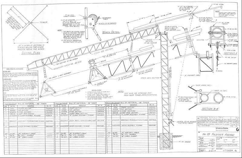

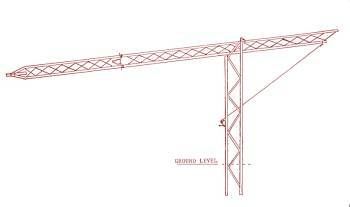

I am in the process of building a tilt-over tower  ( not tilt-up ) and have a couple of interesting links:

he uses pipe not unlike yours, I am more into the Rohn type design that I have seen the hardware for a 60 foot unit not far away.
I posted a few diagrams:
http://i145.photobucket.com/albums/r203/scorman1/Wind/antenna_tilt1.jpg
a real engineering spec here:
http://i145.photobucket.com/albums/r203/scorman1/Wind/rohntiltover.jpg
the trick to not bending is simple and as shown in the first thread ....you need a  1/4 inch cable attached below the turbine near the top, to a anchor at the pivot point and a standoff somewhere in the middle ...sort of like a suspension bridge or crane cabling
the tower should simply be supporting a static compression load ie the weight, and guys take the lateral load from the wind pushing sideways if it is not freestanding
the tiltover is made easier if there is a hefty counterbalance weight near the ground, so that the winch is doing very minimal work ie the whole assembly is "balanced" on your pivot tower
