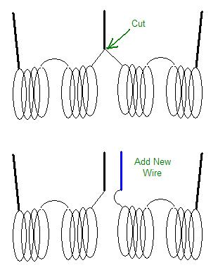

So its trash time of the month and i decided to scrap the small motor i had and look for a larger one to convert. I found an induction motor off of a old compressor. Here are the specs. Emerson motor. 115V, 7amp, Rpm 1725, Cyc 60, PH 1, Temp Rise 50C cont.
So again I'm trying to figure out how many poles to install into the armature. I'm still going to use my 1"x1/2"x1/8" neodymium magnets. I have 20 of them and can stack four down the side of the armature. There are 32 stator plates and 8 coils. Did some reading of the last post and have to say its alot of great information i need to go through. But few questions if you guys can help me out. Is this motor worthy of conversion? and any help with designing how to install the magnets into the armature. How many poles? ect. Tomorrow is my only day this week that i'll be able to access metal working tools.

Re: Questions on Converting Induction motor
« Reply #9 on: May 20, 2008, 08:42:55 AM »
For 1725 to 1775 RPM (anything around there) it gets 4 magnets (or groups).
NSNS is important.
"Found" makes it sound like nothing to lose but a couple bucks on inexpensive magnets, and some time.
I use 24 hour cure epoxy to hold them on.  A lot of guys like JB Weld.
Best guess.
Find where the wires enter the coils.  I expect there are 3. One will join with 2 coil wires.  Snip one, and add an insulated extension.
http://www.otherpower.com/images/scimages/2050/forGuruji.jpg
This will make 2 sets of coils.  Add a bridge rectifier to each set.
Then see how it works.  That's what I do.
Don't expect much with those small magnets.

« Reply #10 on: May 20, 2008, 02:38:21 PM »
« Reply #13 on: May 20, 2008, 03:05:25 PM »
Each pair goes to the AC inputs of that pairs bridge rectifier.
The bridge's outputs are paralleled.  + to +.  - to -.
That makes 2 wires.  The + from the bridges goes to the battery +. - goes to battery -.
