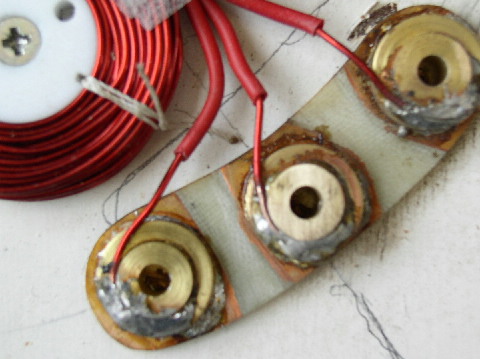

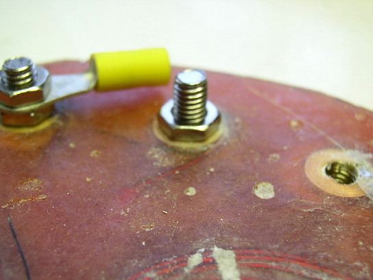

I had a look at your page and noticed that you were bringing the coil wires out as 'tails'.  I considered this a weakness when I made mine and was worried that I would easily snap them off where they met the casting, thus ruining it.
So I made these......
which when cast into the mold and finished off looked like this.....
I've found it a much more robust fixing.

« Reply #7 on: March 31, 2009, 05:57:28 AM »
I like it.  As Yul Brenner sort of said, "So it is shown; so it will be done."
