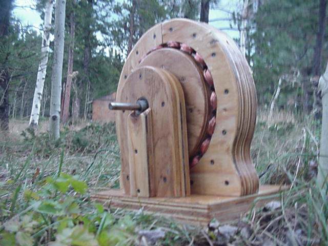

I made one of those once...
half of the stator even had iron/epoxy cores  :D
seriously... can't wait to see what you come up with Chris - again, I and lots of others are grateful for all that you contribute here (well.. maybe not all.. but most of it!)
Holy crap, Dan!  Now I know why Louisiana Pacific ran overtime for 5 years to keep up with the demand for plywood   ;)
Chris

Stator core is ready for a test wind to see if I got enough room for the coil legs.  If it's too tight I'll have to machine the holes bigger.  This thing should only require 35 turns with 18 coils so I think it will fit.
(Attachment Link)
If it works you should increase the stator stack length and get longer magnets... it'll probably shave a few turns off each tooth....
