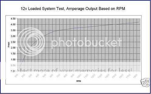

Here are some better pix of the rotor. I see that, although there is a 3-4 degree pitch at the tips, the leading edge is not parallel to the plane of the rotor. I'll try to remedy that by slotting the mounting hole or fabricating some 'crutches' to bolt the blades to which, in turn, will mount to the hub.
I tested the cutin more carefully this wwekend and it's 12.8 Voc @ 160 RPM. I suspect, as you say, that's too slow for the ECM as wired. Is it correct to aasume that if I wire it series/parallel (parallel three of the former six coils with the other three in each phase) that the cutin speed would double? I have a little DC/DC booster module [ Attachment Invalid Or Does Not Exist ] that begins to boost at 9.5 VDC and has adjustable output by turning a little multiturn pot. This gizmo purports to be able to pass 150W, but heats up a bit at 5A when I connect its input to a battery and its output to another semi-discharged battery. I don't know about the volts/amps deal as far as the ECM and the gadget are concerned. I (sort of) get that excess voltage over cutin voltage is (magically) converted to charging current, but, I sense that there's a range beyond which there are diminishing returns.
So, if I rewire as I mentioned, what should I shoot for with the booster [ Attachment Invalid Or Does Not Exist ] ? I'm guessing that the power of the blades at any given RPM is the factor I need to watch. Since the gadget/gizmo is adjustable, should I just fire it up and watch the RPM's - taking what power there is without 'stalling' the blades - until the ECM's unboosted output hits cutin?
Thanks,
Rick

In the pictures, the leading and trailing edges look rather "square".
A big improvement would be to bevel the trailing edges.
Rounding the leading edges will help too.
