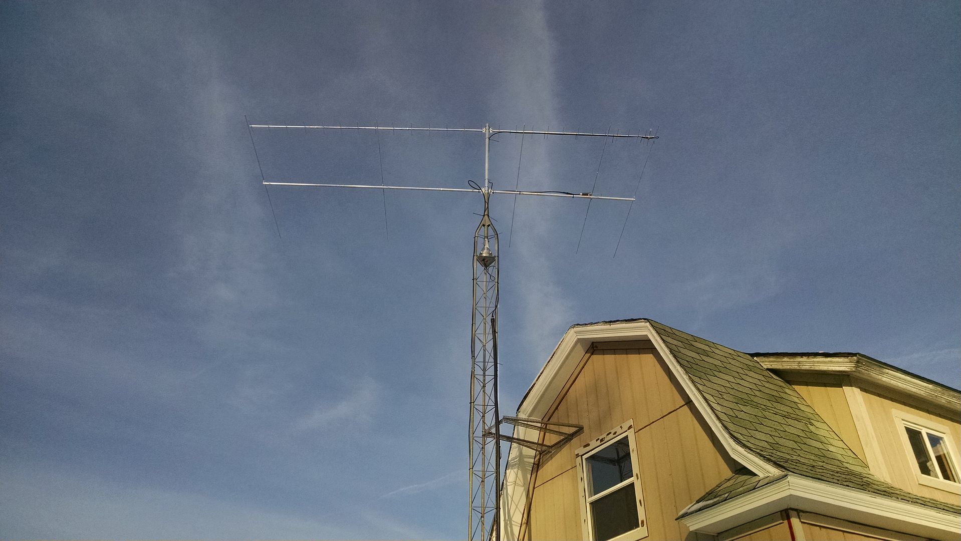

I have been working on getting this tower done for a month now. Lot of cabling, building antennas, getting things mounted, tested and finally getting the tower up and running. Tower is a very heavy duty 32 foot crank up. The H frame is 2"OD .25 wall 6061 aluminum tubing. Antennas are 20 feet long and all cable is hardline which is a pain to work with!
Initial testing over the weekend was very very good! Worked a bunch of meteor scatter contacts(bounce signals off the ionized meteor trails) with the longest 1100 miles. Also tested the tracking on a couple of satellites and it worked well!
Rotor does azimuth and elevation so I can point at the moon. Main reason I built this antenna system is moonbounce communications where I use the moon as a passive reflector. Frequency is 144mhz(2 meter ham band).
Also put up a 29 foot tower for 6 meters and 70 cm(50mhz and 432mhz)
Been a lot of work this summer between the new garage and the tower rigging!

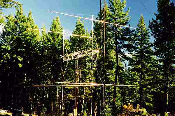

Moonbounce is a lot of tinkering, a lot of building, technical challenges etc and that is why I do it!
EME is not something you just do and it happens by chance.  I got three successful EME's in September on 6 meters working in partnership with a station in Norway.  We used JT9 on wsjtx software, I used a nine-element (all elements driven) dipole array with three elements at 1/4 wave spacing front to rear driven successively at 90 degrees out of phase, and stacked three high at 5/8 wave stacking.  The station in Norway used two 9 element yagi's stacked at 5/8 wave.  We ran about 800 watts of power.
My dipole array is useless for other normal communications because the front lobe off it is like a flashlight beam.  If I point it at you - only a few degrees off and the signal misses you.  The beam is so tight it will just about set trees on fire on the horizon.  Like Mary said, it takes a lot of tinkering and building - I spent most of the summer with the analyzer adjusting phasing lines, phase spacing and stacking to tune up the array.  I worked with another station about 110 miles away in Rhinelander for the tuneup.  And then when the day comes the moon has to be visible at both locations (which means only at moonrise into Europe from the US) and weeks worth of preparation and work last about one minute each way for each successful EME contact.  And even then it takes a lot of luck because the surface of the moon is not all that smooth and tends to scatter your reflected signal.
We were using only a 20 Hz pass filter on the receiver front ends for a 16 Hz wide signal.  And the timing has be precise, +/-60 ms, sync'd with an atomic clock between the two stations.  Almost 100% of the amateurs doing EME on 6 are using linux to drive the rig because Windows isn't accurate enough and does not use the Unix Epoch clock for timing.  Few people are doing EME on 6 because of the path loss and technical difficulties.  But it was still a lot of fun.  Our next attempt will be in February, working with the same station in Norway, and in concert with another station only about 4 miles from me that has built an experimental 6m wireframe parabolic reflector.

That's why I went with the dipoles instead of yagi's.  Stack up three elements on a driven array at 1/4 wave spacing, with each element driven 90 degrees out-of-phase in succession and the f/b ratio is VERY impressive.  Another station only 5 miles away transmitting at 100 watts can't be heard on the back side of a three-element driven array.  The phase cancellation, once tuned to perfection, is 100%.  And the whole thing is only 10 feet long, front to back.  But it's 23 feet high once you add two more three element driven arrays at 5/8 wave stacking height to get the azimuth angle down tight.
You can't just turn that array - it has to have azimuth tracking as well.  And to get maximum ground gain on the ground plane radials laid out in front it, pointing east, the bottom elements have to be precisely 19.6 feet from ground.  So from ground level the whole thing is 43 feet high.  I welded an old satellite tracker to the end of a 20 foot long piece of 4" x 11ga pipe and set it in concrete.
Phased all-driven arrays are very hard to tune.  I used 75 ohm RG59 for the phasing lines, feed the junction box with open wire parallel feeder, and you find variations in VF on lengths from the same roll of cable.  And then you get it perfectly tuned, the temperature goes down, the Velocity Factor goes up and it's out of tune again.  In February when we make our first set of attempts for the new year I'm sure I'll be out there in 20 below with the analyzer tuning up spacing on the elements to match the VF of the phasing lines at sub-zero temps.
And all that work for about one minute of glory that there's only about a 10% chance of being successful at.
The other station I'm working with that built the wireframe reflector, and I, are going to try simpler EME, station to station when the moon is a little higher in the sky.  I can only tilt my array 30 degrees so even that has a pretty narrow window of opportunity.
But it's still fun, and a nice departure from working HF all the time.
When I go over to Steve's place sometime I'll take a photo of his wireframe reflector he built.  It's pretty big, made mostly out of 2/4's for the framework to hold the dish movement.  And he made the framwork for the dish itself out of light angle and 3/16" steel rod with several microwave screen reflectors laid in it.  It's a pretty impressive antenna, made mostly of parts gotten from Menards, except for the microwave reflector screens which he got salvage off a microwave tower someplace.  Took him all summer to build it.
