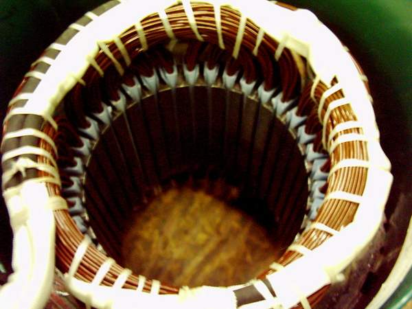

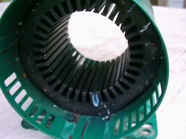

the next step is to strip the stator of wire and insulation. this can be accomplished by a few methods at home. cut off the opposite connection end as close to the laminations as possible. chemical strippers to remove varnish is a little dangerous without proper equipment. you can heat the stator to 300 degree faranheit in the oven which will soften the winding and help in the prying process to get the coils out, or you can be patient and tug and pull at a few of the wires at a time till you have it all out. be careful as possible not to damage the machined surfaces of the frame and laminations.
things to record while stripping:(assuming this is a 12-10-8 concentric winding)
#1 look at the motor lead wires and record how many magnet wire conductors are soldered to each lead. if more than one, use a micromater to see if they are the same size or not. record the size of each wire (with the enamel removed from the wire).
#2 assuming that this is a 12-10-8 concentric wound motor, you must now count the number of wires in each of the coils from the 3 different coil spans. if this is not of the 12-10-8 style winding, you will use the 1 turn method, but you should still count the number of wires in a coil slot. after you have counted the wires, divide them by the number of magnet wires soldered to the motor lead wire and record the guage of the wire. you now have the number of turns in each slot and you now know what is called the (SLOT FILL). SLOT FILL IS HOW MUCH TOTAL CIRCULAR MILLS OF COPPER THAT ARE CONTAINED IN THE STATOR SLOT. another note, if the turns were different in all 3 of the 12-10-8 spans, add all turns together from the three counts and divide by 3 to get the average per coil turns.
#3 you will now have to purchase new slot insulation and coil wedges. this material is available from any motor rewind shop. i suggest to use what is called "DMD" insulation which is a 3 ply material, dacron, mylar, dacron. the wedges are the same. ask for DMD 3-5-3 which is .011 of an inch thick.

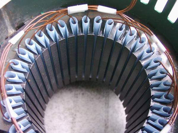

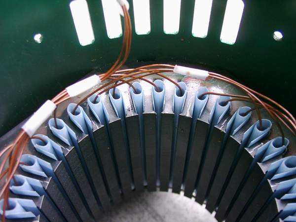

here is a pick of the 2 hp stripped stator with one piece of new insulation inserted.

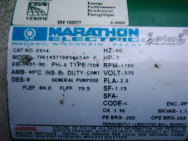

i will use the 2hp conversion that i have done for the examples. the 2 hp was originally a 575 volt motor. i stripped the stator and used the one turn method. if i had taken the readings with the original winding, the method would be the same, only with different input values, but i would have ended up with the same new data that i needed in the end.

now i cannot make a coil with 27.34375 turns. so i round of to 28 turns. this will give me a cut in voltage of 14.336 volts, which is even a little better. the lathe test @300 rpm with the completed winding gave me a voltage of 21.75 volt, which would be 14.5 volt @200 rpm. SMACK ON!

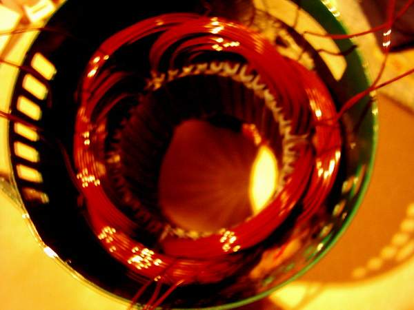

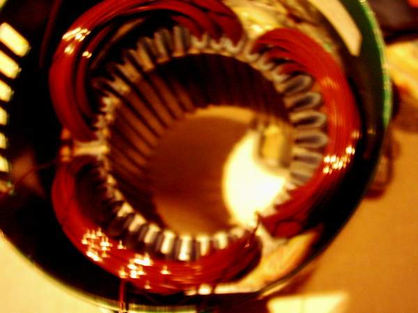

"80%" src="http://www.otherpower.com/images/scimages/253/1_turn_test_winding_1.JPG">
pic of the one turn test winding
another view
