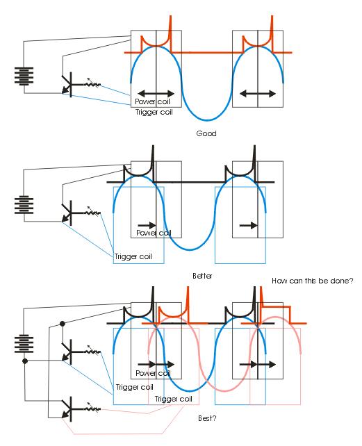

« Reply #10 on: September 23, 2004, 09:06:39 PM »
I was just kidding, when I said no one was interested in this project. Feed back has been very positive, all along and help has been great.
Here is the current motor circuit of Permogator III and proposed modifications:
Right now, I used the top set of 8 coils for the trigger. They are aligned directly over the bottom set, so as far as alignment, and that is like Bedini, but his trigger windings are on the same coil. I don't know the reason for that, but he uses a diode to isolate his trigger, whereas I don't have to. I do think his idea of a second winding to carry the power off to a battery charger is a neat idea. That way, the output gets to carry the cemf pulse, while my output coils are separate.
The middle panel is my next project. I'm going to remove one of the trigger coils from Permogator III and replace it with a coil the same size, only with filled with 32 magnet wire. The present hole will be enlarged to a slot and the coil itself will be in another slot where its position moved so I can advance it and then secure it in place. My wife voluteered to wind the coil on her sewing machine. If this works, I hope to double the speed. Then install another trigger as an afterburner. Then we'll see how fast she can go still limiting the power input to 4 AA batteries.
If I double it again, that should get me pretty close to the target. But that is to be seen, and I'm not predicting anything.
So, can someone describe how a circuit could be constructed to obtain the effect shown in the lower right hand diagram?

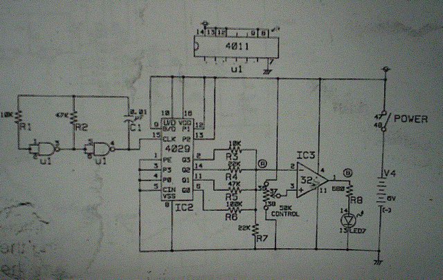

I use this circuit to control futaba RC car servos manually. I do have to replace some of the capacitors and the variable resistor, some fixed resitors too. This changes the freq parameters, then the circuit can communicate with the servo quite reliably.
 For your application you may have to use some creativity to make it compatable, this circuit represents the basic building block of PWM control, and possible syncro-
IC3 is an op-amp or LM-324, IC2 is a -4029, and u1 is a -4011.
Have fun
JW
