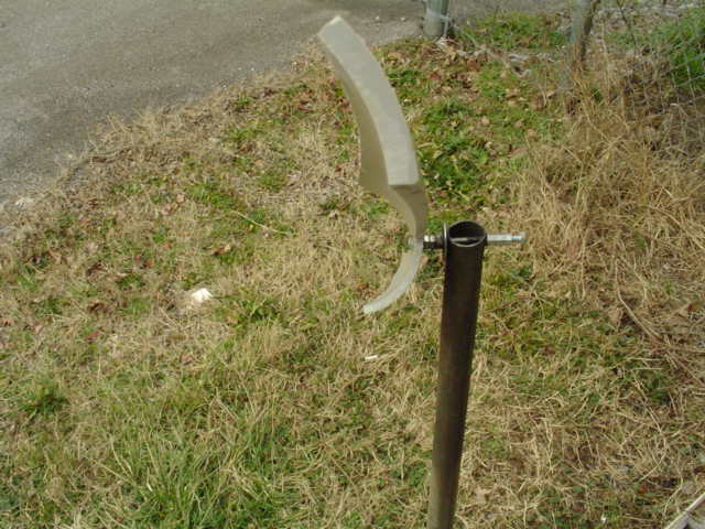

I would like to see some pics of your ZubWoofer blades too, and some details like.
Blade length
Pipe diameter
I have a ZubWoofer bolted to a TV mast and tied to my fence outside. I love to watch it spinning. It's a 42 inch blade made from a 4 inch pipe. A 40° hub angle and a 7° tip angle. It's not hooked up to anything, it's just proving a concept.
I have obtained a syrup barrel from the Coca-Cola bottler next to where I work. It's about 20 inches in diameter and 4 feet tall, plenty thick and hard. This will be my next Blade Project and will probably end up driving my wind genny which is now about 95% complete. Well it's really finished but I have to fix a little mistake causing my airgap to be to small, about a 3 hour fix.
http://www.fieldlines.com/story/2004/4/4/164552/3003
Good luck and keep us posted to your progress . . .
« Last Edit: January 06, 2005, 09:41:18 PM by wooferhound »

« Reply #5 on: January 06, 2005, 09:45:27 PM »
I had ment to include this picture with my last comment...
« Last Edit: January 06, 2005, 09:45:27 PM by wooferhound »
