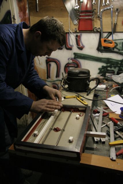

The following is a serie of pics of our first attempt. Before any serious work we built small scaled laminator just for the purpose of learning, choosing the right materials and experimenting, without any expenses (just 30 $).

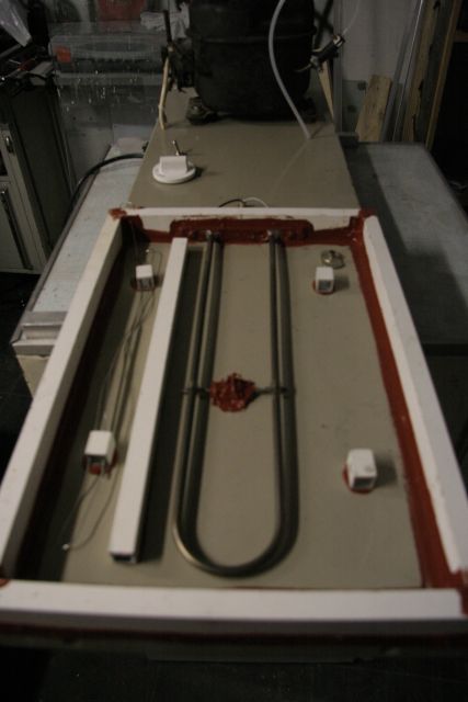

This is our construction yesterday, when we assembled it. We got to quit the work for one day because silicone needs some time to become harder.
We are using ceramic tile in this model instead of copper plate. Hope it'll work.

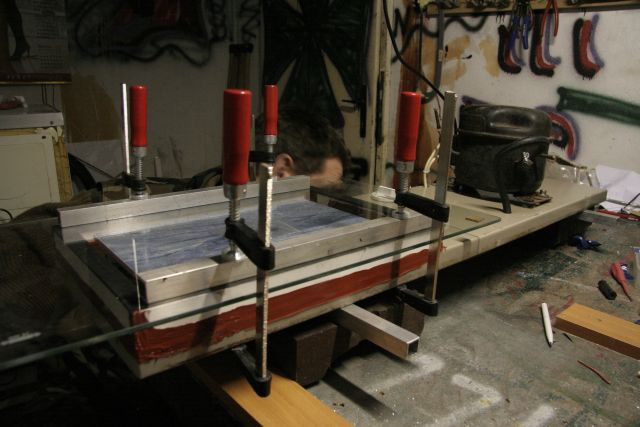

First try of closing the lid. We put tempered glass instead of top chamber, just to see what's happening in there.

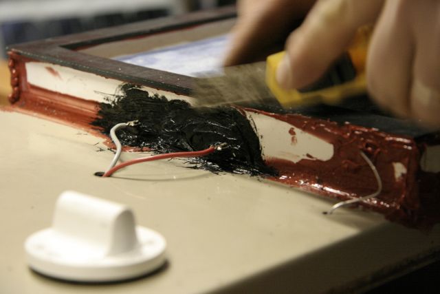

Yesterday, before we quit the job, something goes wrong. Holly smoke was released from the heater. I know it's hard work to put it back inside. I think that was because the silicone was wet, and make contact (shortcut) between heater contacts.

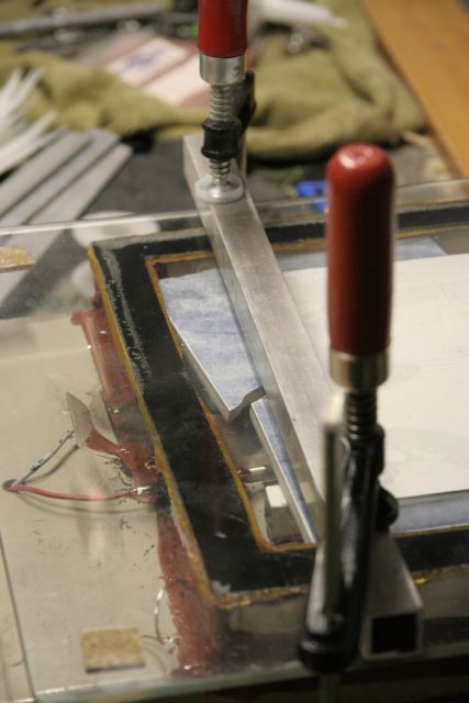

This is me putting some grease on the rubber sheet used for sealing the upper glass. The grease is some 30 years old military grease used for cannons. Still good, it seems.
When we tried to put the inside space under vacuum, we realize lot of leakage between the glass and the rubber seal. With grease that was solved.

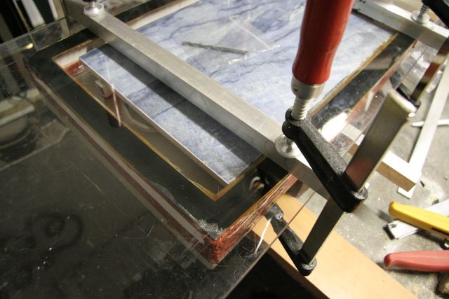

This is machine under work, with plastic bag inside. Inside the bag is a drill bit, to test vacuum it. We hope it will work.

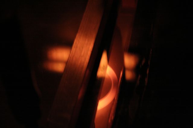

The heater on the run. We set the thermostat on 180 degrees, but it's ordinary household type. Not sure how accurate it is.

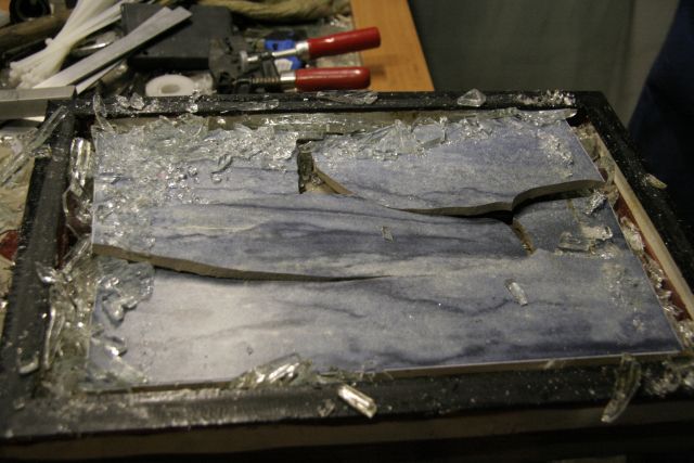

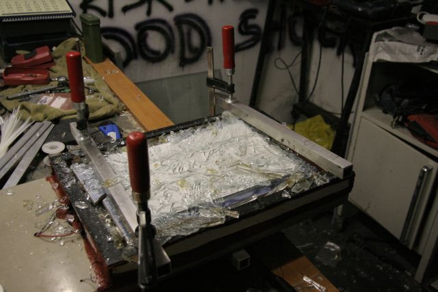

After about 5 minutes and 100 degrees achieved we heard the crack, and the tile was broken. As the inside test glass with sheets was totaly up with the upper glass, we let it all that way, hopint it would laminate.
Another 5 minutes , and just after I said we should terminate the process, we heard large BANG! The glass goes apart. We're lucky it's vacuum inside, so it really implodes, not explodes. Now to se what we have in there.

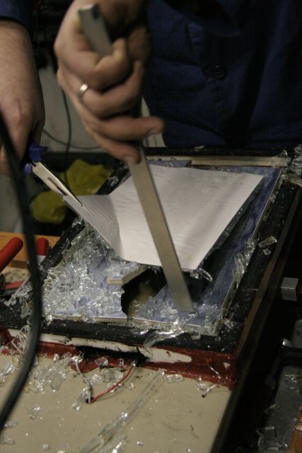

Taking the laminate out. Before this we had to remove all glass parts. maybe it was better idea to set the laminate layers opposite direction, so we could see the entire process thru the glass. TEDLAR (upper sheet) is non clear.
This is the ceramic tile. We thought only one crack was happen. It seems more was on the scene.

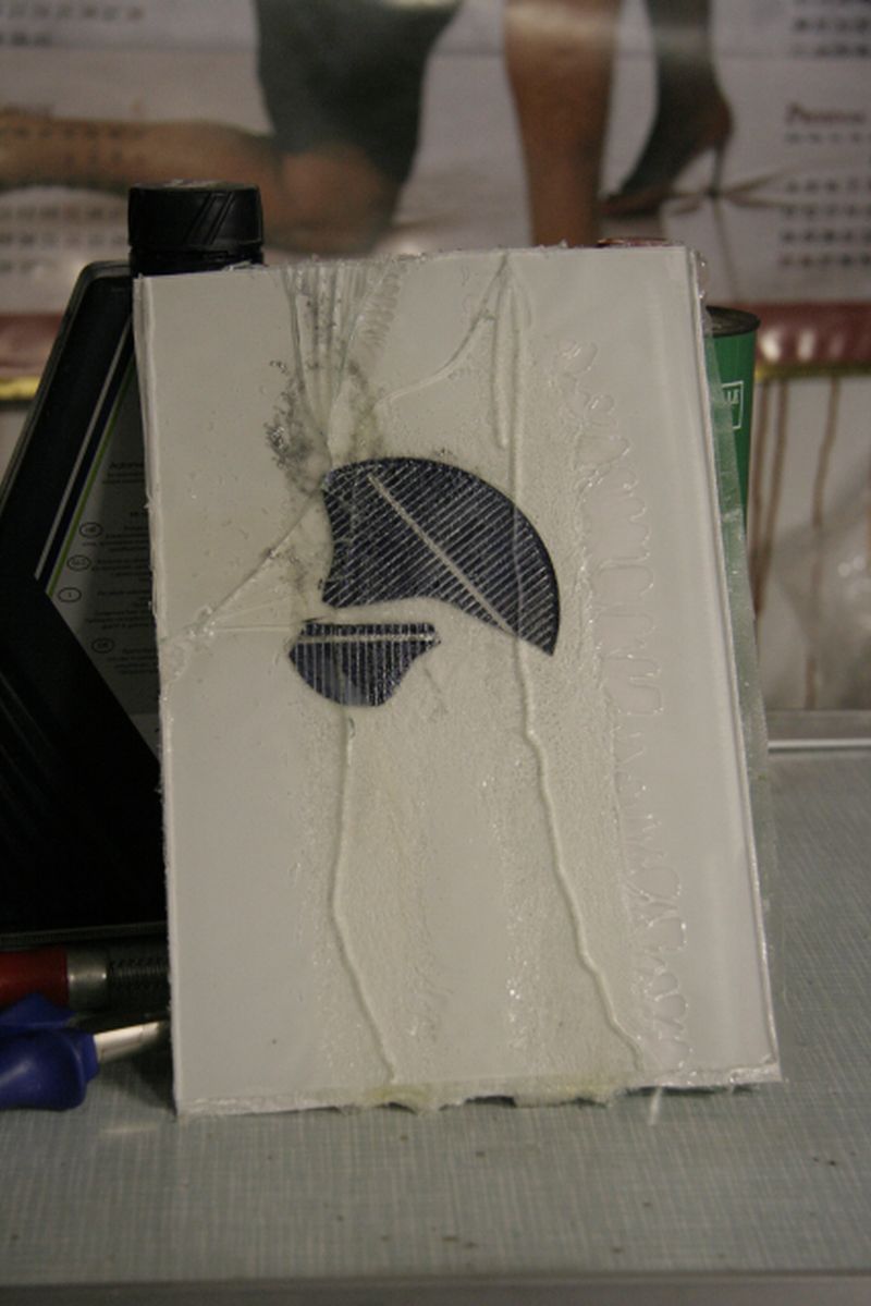

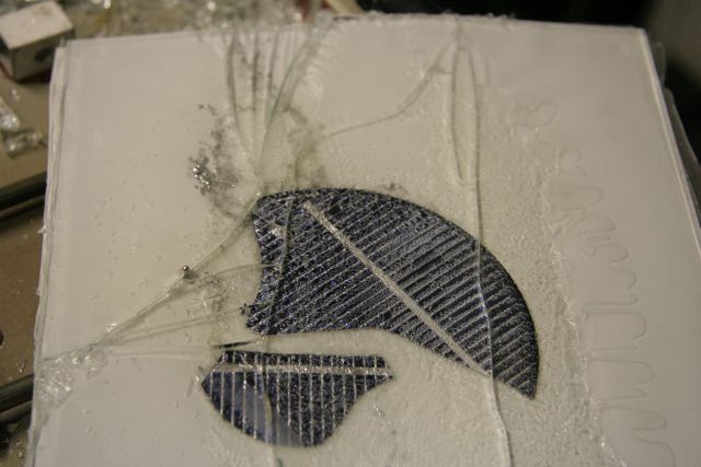

This is other (true) side of the laminate. It can be seen that wacuum even pulled the tin from the cell (two pieces of broken cell). It seems that temperature was too high. Also, we can see too much cured EVA film above the heater. They just were too close.
On the right, near the edges is visible how good it was laminated. Unfortunately, as the glass breaks, air comes between the laminates and spoiled the thing.

Neat project, I know that with kilns, you have to cure the ceramic at a lower temperature to remove any moisture prior to heating it super hot to remove any moisture that may have accumulated in the material.  Since your ceramic was close to the heating element, the bottom probably experienced extreme heat which could have caused any tiny amount of moisture trapped inside to vaporize and build up pressure.  This would be amplified by the fact that the chamber was under vacuum.  Also, all of this would be in excess of the stresses induced by uneven heating and resultant expansion of the material.
My thoughts would be:
  • cure the ceramic at a lower temperature and slowly heat
  • if possible add distance between the element and the ceramic
  • I might try a metal lid with a small peice of glass, like the high temperature glass fitted to the windows on old space heaters here, or pyrex.  fitted as a window, and thick enough to handle the vacuum forces for the area of the window.  A large flat panel of glass would have to be much thicker to handle the same forces as a smaller window.
-a more accurate way of measuring the temperature of the chamber may be needed, and heating more slowly/evenly is likely required. If even part of the chamber gets to the point of melting the solder from the front of the cells, the whole panel will be ruined.
Even thought the particular experiment did not get the results you wanted, it seem to have showed that with a few minor modifications it is most likely possible, and that is a great thing.  Rich

I forgot to mention that we used ordinary green-glass for testing the laminate. I just wish I ordered some tempered glass pieces for this purpose. Maybe all would go better. But we have some learned lessons, and on the wall of my workshop is written: No risk, no fun!.
Today I'll try to find some steel plate (at least 6 mm (1/4") thich to put under the laminate, and find the way to support lower housing plate to keep it from getting upper. Vacuum bring it all the way up and pressed the heater to the tile, and than laminate to the upper glass.

I'd do something to greatly reduce the power of the heater.  You don't need a giant red-glowing bar to achieve 180 degrees, especially if you're willing to spend more time on each lamination than a factory machine on a high-volume production line.

Yes, we are thinkong of that, but if you look into the comercial laminators, they use 15-16 heaters in the 1mx2m area, in total of approx 8000W. I know time is important to them, but what type of heater to olook into and to get max temp (surface of the heater) of max 200 degrees?
