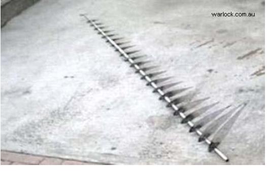

Re: Surf board like blades , revisited
« Reply #4 on: February 01, 2006, 12:04:54 AM »
This is what i'm shooting for..
thanks Mike from warlock.com.au
« Last Edit: February 01, 2006, 12:04:54 AM by willib »

I see what you are doing, though it's not what I first thought you meant.
So your not cutting an entire blade out of foam then laminating the blade with fiberglass? Instead it looks like your building a hollow blade with spars like an airplane wing, is that right? The Arrow and the fiberglass mat are all that's running the length of the blade then?
My thought was that you were carving the blade out of a sheet of insulation same as carving one out of wood. I will try that later.
I been wanting to build a surfboard type sail boat this way. Laminate the insulations together and cover with fiberglass. I think it would be fun to take to Canada next trip for on the Montreal river and others. I have not had time to build it though. Sort of a cross between canoe, Kayac, and sail boat. With a small trolling motor for no winds or up stream power.
Foam can be very strong itself when thick or covered, and it's very light weight.
« Last Edit: February 01, 2006, 04:59:27 AM by nothing to lose »

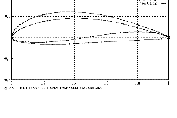

« Reply #13 on: February 01, 2006, 06:12:30 PM »
Thank you all for your sugestions. :-)
Thanks to paradigmdesign and the pic he posted in the first surfboard-like blades,i have 39 of 48 stations printed out and ready to cut.
http://www.otherpower.com/images/scimages/4937/airfoil_sections.jpg
To make a 8 foot dia. triple blade prop , i need 48 one inch stations ( the thickness of the insulation).
in the program below
http://warlock.com.au/bladecalc-abstract.htm
i have the following information,
Num.Blades=3
TSR=6
efficiency=0.4
Blade radius 3.9 Feet.
With some work i was able to take paradigmdesign's 20% airfoil and enlarge it to 18 inches long , actual size..
which is as far as i want to go,... 28 " is just too much..!
I had to put clear foil on the screen and trace it out in sections..
thats about where i am now
« Last Edit: February 01, 2006, 06:12:30 PM by willib »

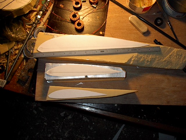

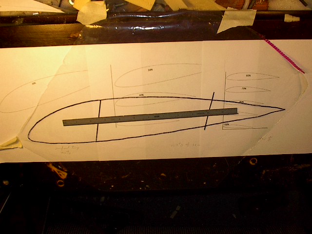

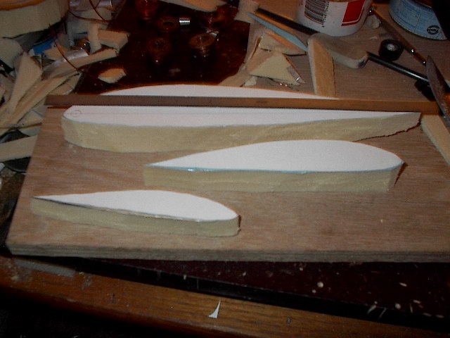

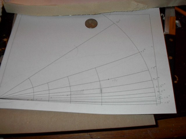

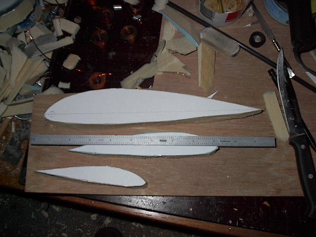

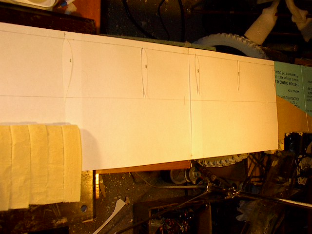

Surf board like blades update
« Reply #16 on: February 02, 2006, 10:31:53 PM »
I decided to make the blades 10 foot dia.
and five inches per station , 10 stations..
There is a drawback to doing it this way , its soooo tedius....
anyway i hope it turns out ok..
The five sections on the top , are half way from the root 50% of the length of the blade..
the ones closer to the camera are 60%.
the diagram is to let me know the distance between the start and end of the station,so i can make the transitions a little easier
This is a rough cut out, of the 18" chord section @ 42deg.  It has to go down to 10.8" chord length ( the next station) @ 23deg , in about 5" if ya know what i mean.
 i am going to carve the second blade a little differently, since the two sections that i just finished ( and the 70 to 100% ones) are thinner than the thickness of the insulation , why not carve them in a regular fashion, and save the section method for the thicker part of the blade....
« Last Edit: February 02, 2006, 10:31:53 PM by willib »

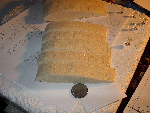

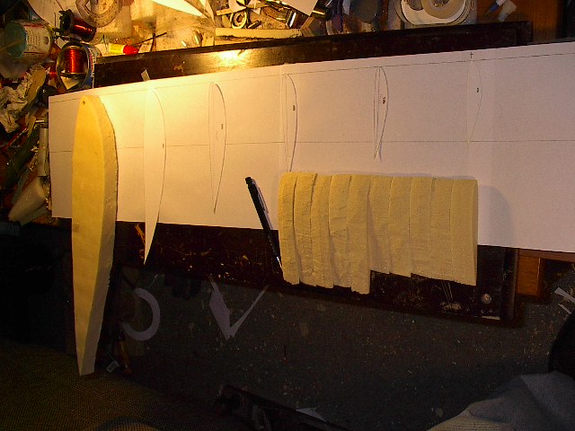

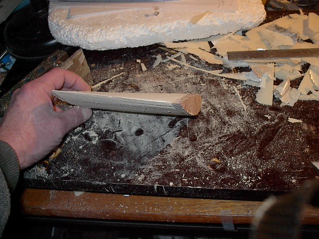

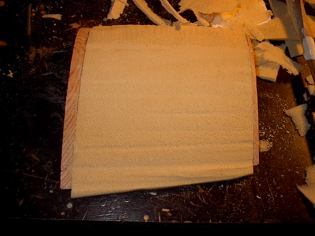

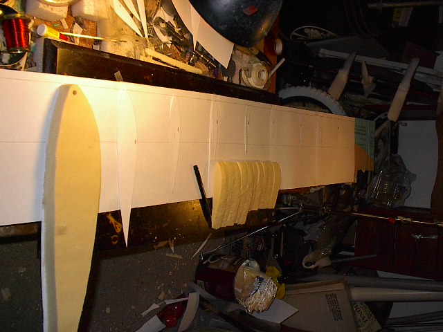

New pics
« Reply #24 on: February 05, 2006, 04:09:03 PM »
I havnt got to far but this is what i have ..
Great news ! 70% of the blade can be done with just a single slab of foam.
to update all of yall they are going to be  50" radius ...
With that largest section having a chord length of 18" @ a 42 degree twist..
Here i've layed out the middle of the blade
a look back tward the root
a look tward the tip,
Well thats it, so far

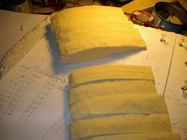

« Last Edit: February 05, 2006, 04:09:03 PM by willib »

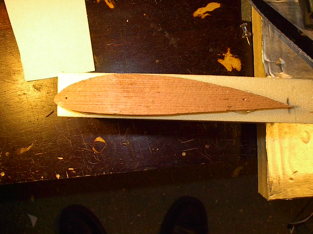

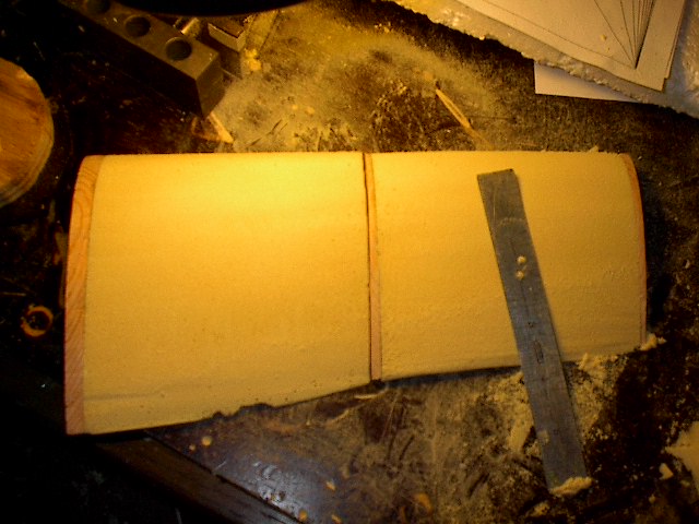

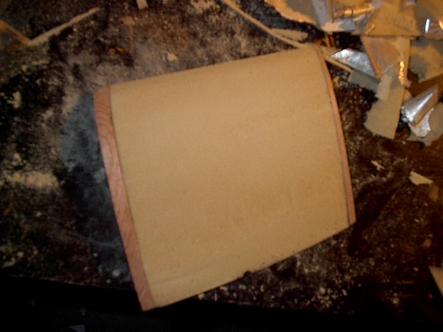

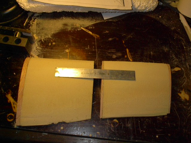

one section done
« Reply #25 on: February 06, 2006, 09:57:51 PM »
« Last Edit: February 06, 2006, 09:57:51 PM by willib »
paradigmdesign
  • Posts: 249

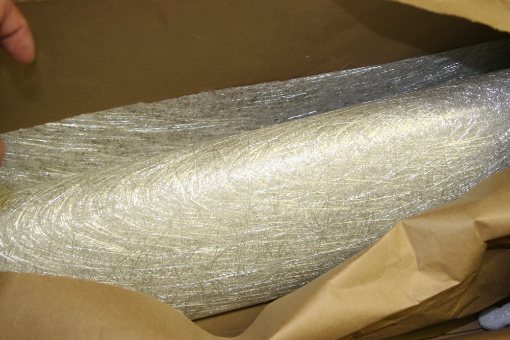

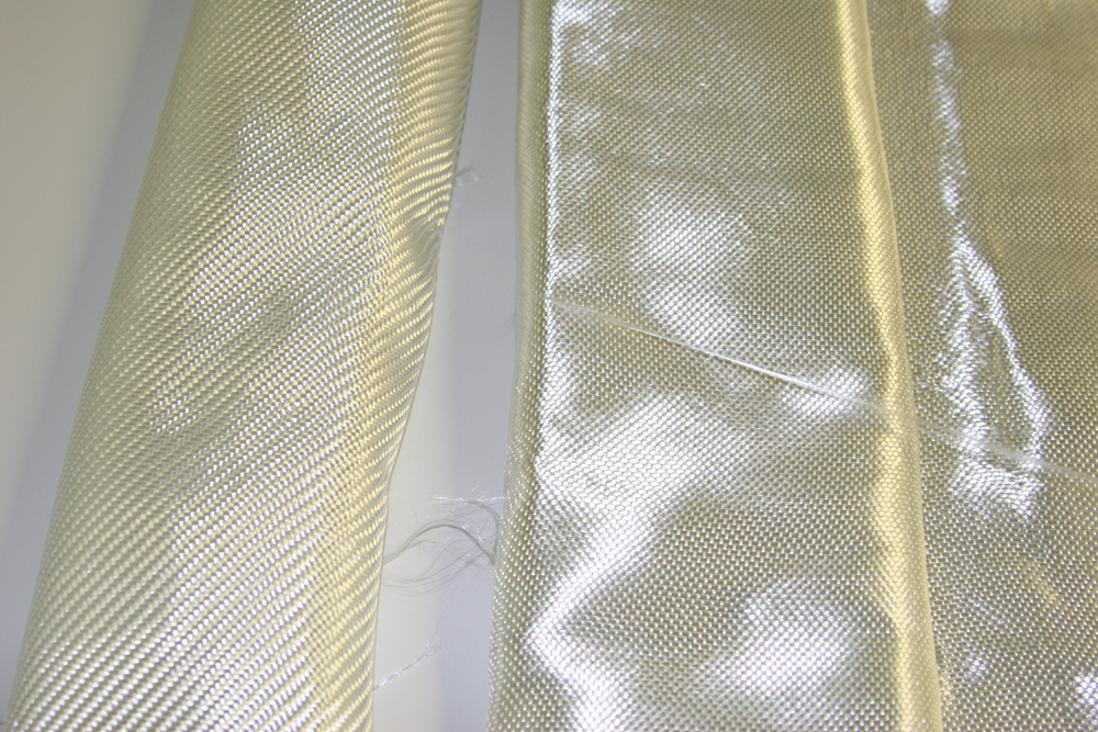

Re: one section done
« Reply #26 on: February 07, 2006, 12:20:37 AM »
There ya go!  That is they I have been making mine, and I can see that it seems to be working for you too.
I still can't belive you are doing this all by hand (I would have gone insane).  If you give me a list of the sizes and angles that you want, I could fairly easilly give you another file with more segments in it.  It only takes me a few minutes.
Have you put any thouhgt into the glass you will be using for the skin, and the spar?
I would recomend 7715, a unidirectional, and 7725 a 0/45 degree fabric, and maby some chopped strand inside to blead off stress.

« Reply #28 on: February 07, 2006, 12:55:41 AM »
Once i finally got the ends glued on and , in the right spot, it only took about 45 min to an hour to shave that off.
That section i just did is the 50% to 60% section of the blade and there is only three degrees between the end stations, the hard part i think will be near the root because there is 23 degrees between the the first one ,18" chordlength and the  the second one ,10.8" chord, but  we'll see .
as for the glass , i allready have some , it seems to be a standard 90 degree weave .
the spar i am  undecided at this point if or not to use one..
« Last Edit: February 07, 2006, 12:55:41 AM by willib »
Two sections done !
« Reply #29 on: February 07, 2006, 05:33:29 PM »
this one took a lot less time to set up ,and still about an hour to carve..
the new one is on the right..
« Last Edit: February 07, 2006, 05:33:29 PM by willib »

Thanks for the offer of more stations , i think i have it <;-)(i think ?)
I've got the blade diagram pasted out on the wall.

« Reply #31 on: February 08, 2006, 01:46:35 PM »
  1. is a unidirectional fiberglass fabric. <--mostly for spar
  2. is a bi-axial fabric, 0/45 degree bias. <---mostly for skin
You can find out more about them at fiberglast.com, but if you are going to buy, I would go to fiberglasswarehouse.com
It is funny you asked, because my shipment of 7715, and 7725 just came in today, I will upload some pics later.
The spar goes on the inside of the blade skin.  If you look in the doc. that I uploaded about Resin Transfer Molding, they go through the whole process very well.
It is a long read, (I've read it about 10 times) but the information in it is great.  The whole process that I have described to you previously, is basicially from there.  They do a couple things differently, (I am not using resin transfer molding.....yet), and they went with a different x-profile that I did.  Also they are building a 20k blade, and I am building a 10k.

« Reply #32 on: February 08, 2006, 03:04:13 PM »
on the image with the two fabrics, the one on the left is the 7725, and the one on the right is the 7715.  Notice the difference in pattern of the material?
the 7715 looks like regular fiberglass cloth, but actually 95% of the fibers are oriented in one direction.
The other pic is just my 10yards of chopped strand matt
