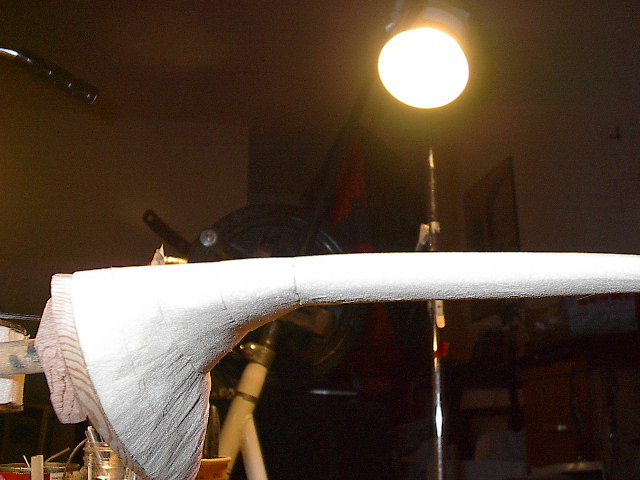

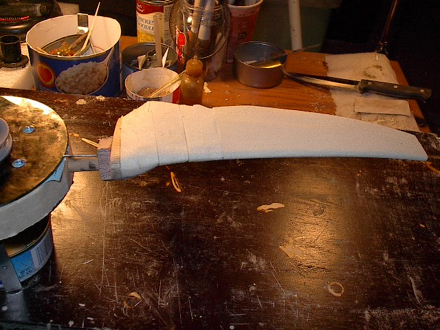

one done , sort of
« Reply #36 on: February 09, 2006, 09:41:36 PM »
i decided to make a small one to test everything out , and i must say when i tested it in front of a fan , it was pretty impressive, for its size..
i couldnt figure how to get the best pic of this so most of them are of the inside , this shows the angle the best..
http://www.otherpower.com/images/scimages/2965/IM001416.jpg
http://www.otherpower.com/images/scimages/2965/IM001418.JPG
http://www.otherpower.com/images/scimages/2965/IM001420.JPG
http://www.otherpower.com/images/scimages/2965/IM001421.JPG
« Last Edit: February 09, 2006, 09:41:36 PM by willib »
Re: Surf board like blades , revisited
« Reply #37 on: February 09, 2006, 10:19:56 PM »
Oh i havnt finished sanding it yet or glassed it yet , i just couldnt wait to test it..
« Last Edit: February 09, 2006, 10:19:56 PM by willib »
