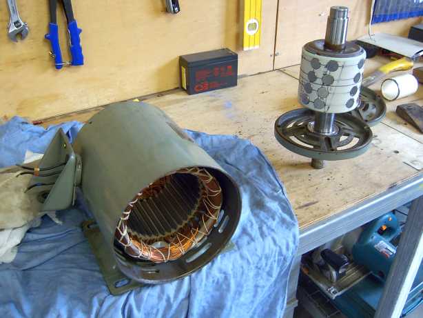

The unit is a Japanese made Fuji Electric 3hp (2.2kW) used 3phase
Induction motor. Looks like a nicely built unit. Spins freely and is a
breeze to dismantle.
The plate shows it is a 4 pole 415V unit. It's a 36 slot, and I will be
using the existing windings after bringing out three more wires for
Star-Delta selection.

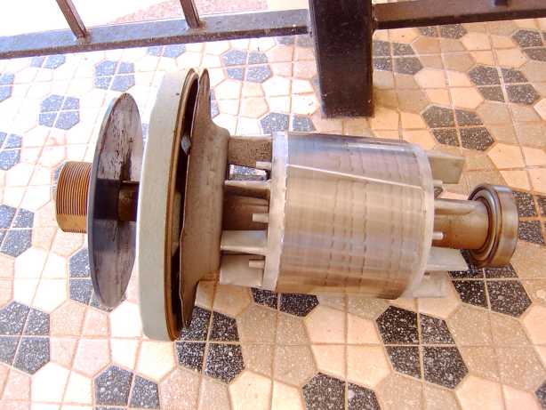

The rotor pulled out. It came with about a 125mm (5 inch) pulley
attached, and I think I might use that for the final installation.

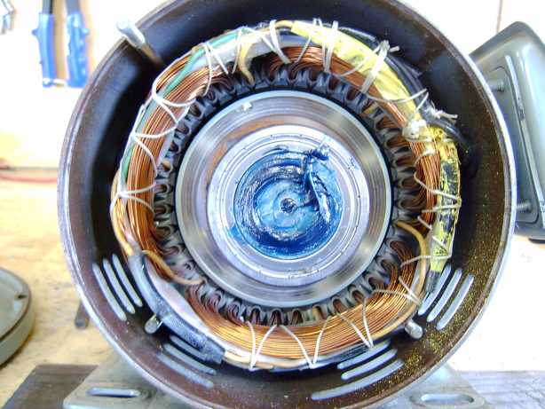

Stator with rotor removed drying in the tropical summer sun. I gave
it a good hose out, and scrub with a tooth brush as there was some
muck in it.

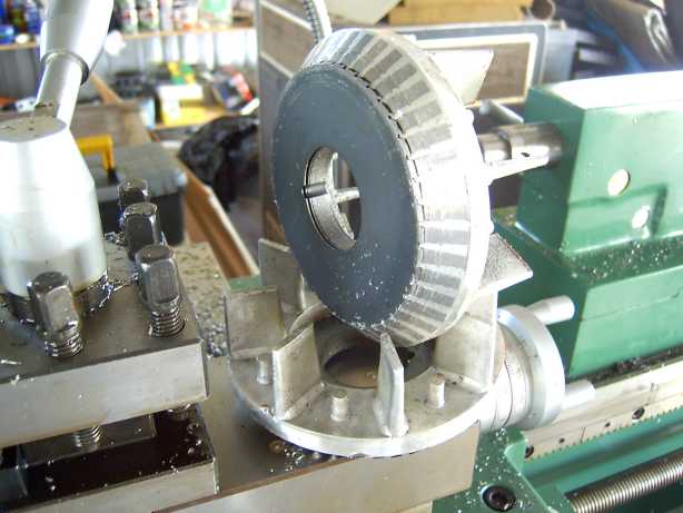

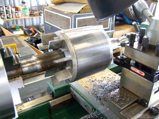

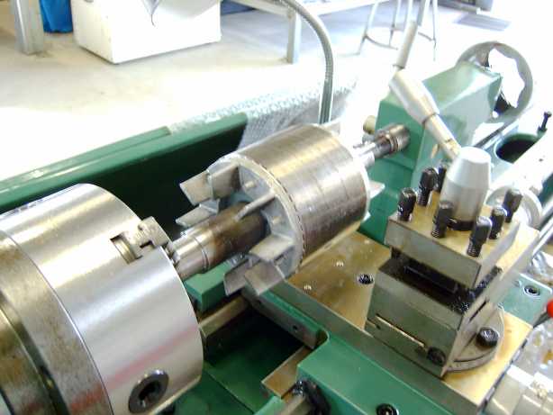

I bought a 2hp metal lathe, and had to test the rotor in it. Even before
I had unpacked it properly and put it up on its stand. :)
The first pass revealed a nice shiny rotor. I'll be using the 48 of the #18
19mm x 12.7mm (3/4 x ½ inch) Neo's from www.forcefieldmagnets.com.
So I have to machine a good deal of material off the stator to make it all fit
back together.

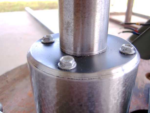

But I hit a little snag. I had to take off so much material, that the alloy fan
ends came off, taking about a dozen laminations with them. I thought that
was curtains for the rotor, but I had a think about it over lunch.
I dug up some 50mm (2 inch) fine thread metal screws, the kind used to
attach a steel roof to steel battens. I found a 3.97mm (no idea in inches)
drill bit and put pilot holes into the laminations. I then oiled the screws
and put them in with a decent electric drill. Four screws into each end, a
quick spin in the lathe and I was back in business :)

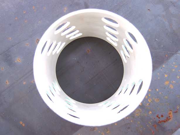

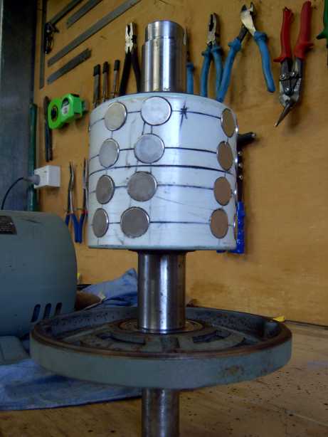

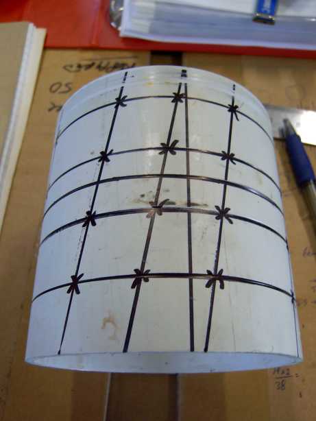

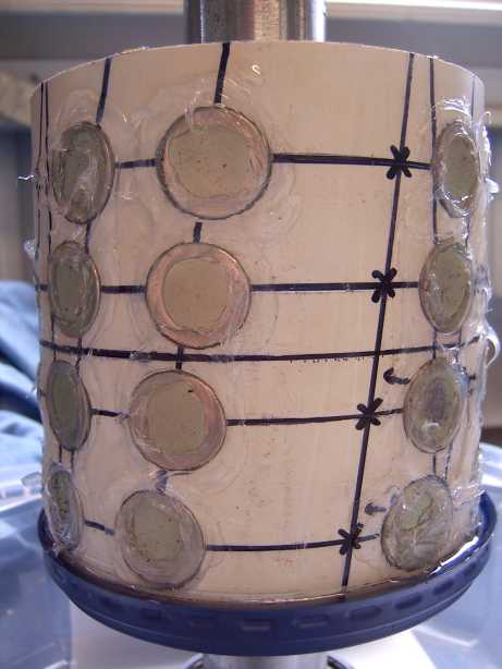

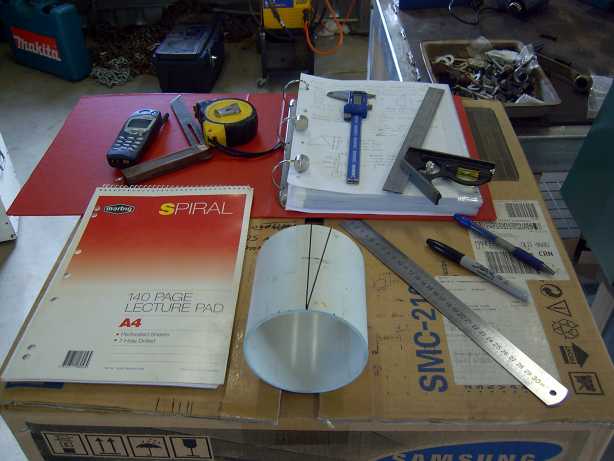

Next step was to start making a rotor cage for the magnets. As this is a
36 slot motor, it requires a 10 degree skew on the magnets. I studied the
diary postings by Zubbly in order to figure all of this out. I am but a hack
compared to the likes of Zubbly :)
The cage is a piece of 100mm (4 inch) domestic water supply pipe.
Although not as high tech as an aluminium or fiberglass cage, it worked
well and cost nothing.
Initially, I had intended to use 3 x 4 groups of magnets for each pole.
But checks showed it would have been too much of a squeeze, and not
enough distance between opposite poles causing possible cancellations.
So its now 2 x 4 groups of magnets for each pole (32 magnets total).

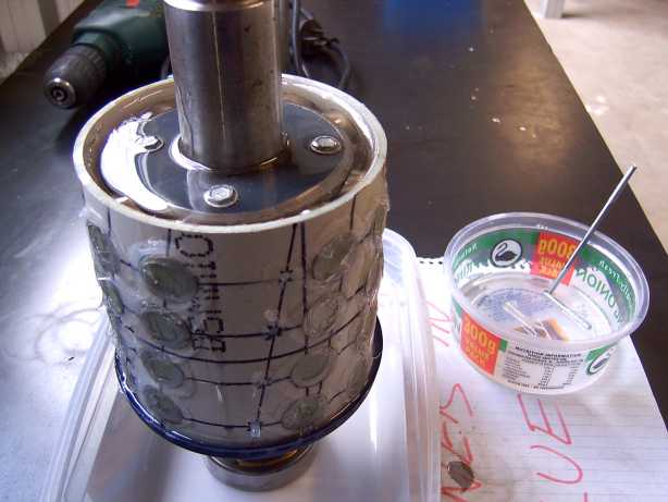

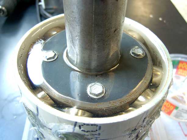

This is the part that worried me the most. Epoxy day. An old food
container lid was a nice fit for the bottom of the cage. And silicone
was used to plug and seal everything. You can see a little bit of leaking
epoxy that the lid caught. I put the rotor back into the lathe once it cured
and machined off any bits that were sticking out.
When I first added the Part A and B epoxy together, it was like trying
to mix oil and water. So I quickly cut a piece of arc mesh down to form
a stirrer and put it in the electric drill. By keeping the "stirrer" deep
inside the epoxy, I was able mix it together in less than 30 seconds and
stop bubbles from forming. The rotor was stood up using one of its
bearings pushed part way onto one end. An ice-cream container formed
an emergency spill container. ( I keep all my food containers these days).
The round magnets allowed all the air bubbles to escape very nicely.
The epoxy completely covers the heads of the screws I had to put in too.
Just to be sure, I ran an orbital sander on top of the shaft for a few
minutes to bring out any last bubbles. It took about 1 hour to show any
sign of curing, and it felt very slightly warm to the touch. I hope this
slow cure will make for a very strong bond.

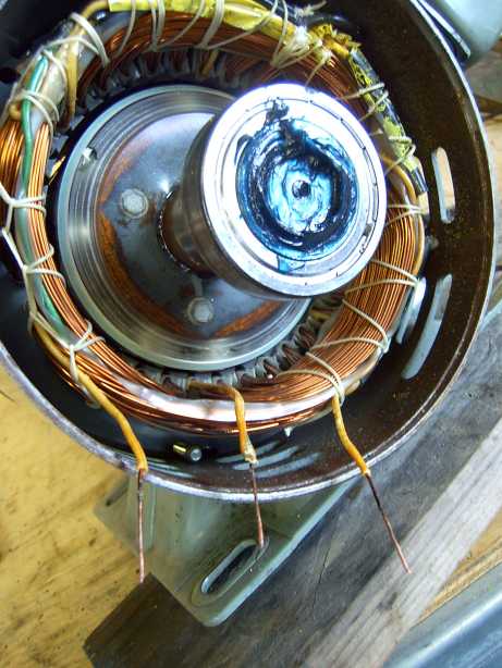

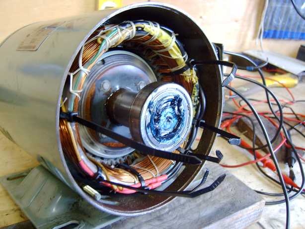

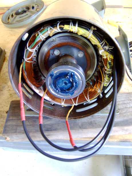

And after a week of curing in the tropical sun, I put the rotor back into

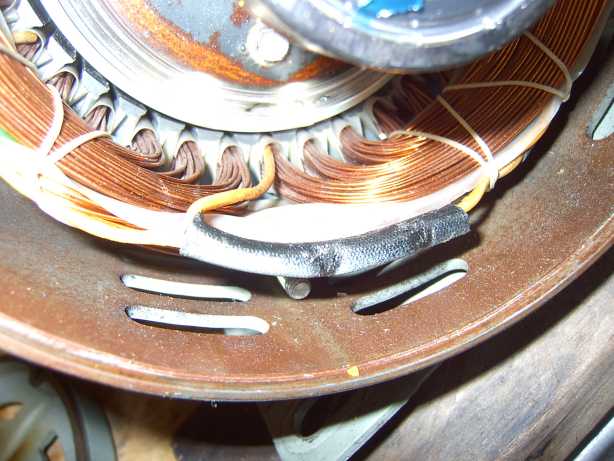

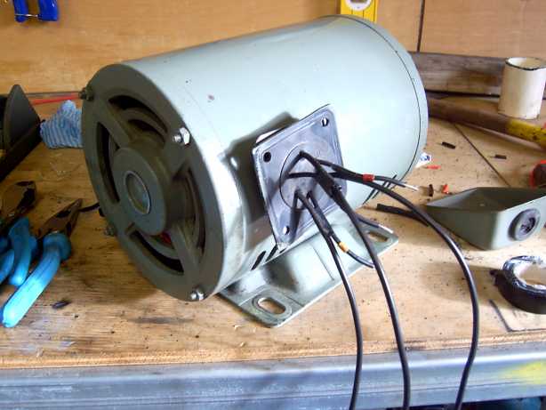

the stator with new bearings. At the bottom left corner of the stator you
can see the internal connection point for the star wiring. You can see
the three yellow wires going into it.
A close up of the star point connection in its black insulation.
A few snips and it was open and ready for new wires.
Each wire was cleaned back with fine wet-and-dry sand paper
and then with alcohol.

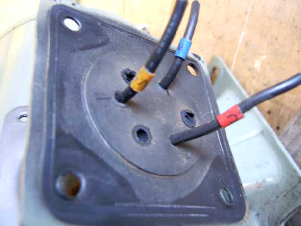

Three new holes were drilled into the rubber cable grommet,
and the wires fit tight.
Three new 4mm square double insulated wires, and double
heat shrink connections.
And neatly tucked in, ready for securing into place.
As any Electrician will tell you, cable ties can fix anything.
Hell I know multistory buildings that are held together by the
humble cable tie :)
And the termination box with six wires now coming out. I also later
extended the existing three short wires to make termination easier.

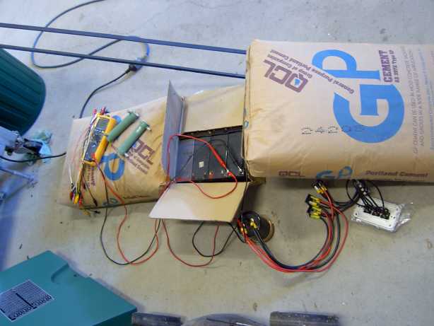

I setup three single pole switches to change between Star and Delta
while testing. The three bridge rectifiers are 1200V 35amp International
Rectifier GBPC2512A. I chose the high voltage units in the hope they
will survive an open circuit voltage condition a little better than the
usual 400V types. The big capacitor is a 400VDC 4,700uF beast from an old
heavy duty 1500VA UPS. Did I mention cement bags are a multi purpose
tool ?

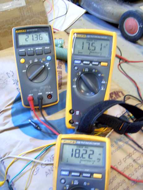

At about 540 RPM in Star into 8x 12V 7Ahr gel cells, all about half flat.
The lathe motor strained under the load, so I only ran each test for about
5 seconds and then let the motor cool off for 5 minutes.
Left meter is showing about 21 amps DC.
Right meter is showing about 17 volts DC.
Bottom meter is showing about 18Hz, which translates to about 540 RPM.
Which all up is about 350watts.

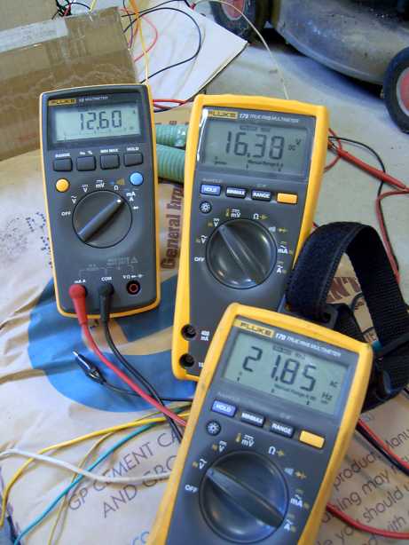

At about 650 RPM in Delta, we see about 190watts.
Left meter is showing about 12 amps DC.
Right meter is showing about 16 volts DC.
Bottom meter is showing about 21Hz, which translates to about 650 RPM.
I did some tests in Star mode with the motor shaft in the lathe chuck.
It  was dangerous as there was no real way to secure the motor from
the start jolt. For your info, each stator coil is about 6ohms.

That's a very fine documentary.  Did you happen to take any pictures of the finished rotor, after cleanup?  How did you get the silicone off of everything?
Did you have any problems re-inserting the rotor into the case, ie the magnets wanting to pull the rotor over to the laminiations?

I'm in the process of converting a similar motor as yours (3HP/2.2kW, 4 pole, 380V). See my diary.
One thing I notice that your rotor is relatively short, compared to its diameter (short & stubby; mine is taller/more slender. Was thinking at first this was a USA-thing until I realized you're from Oz).
I Like the idea of using caulk to prevent epoxy seeping through any small cracks (have had this happen on numerous occasions with other projects). Caulk could be a perfect solution, since it's usually easy to peal off again.
The lathe is exactly the same as one of mine, I think :) (but mine is over 10 years old). Turned down the rotor of my 3HP a few days ago (wouldn't even think about doing it in that small lathe, BTW. Used 'the big one' for that. It was terrible. The steel laminations (transformer steel) has a lot of silicon and this makes machining dreadful. Lots of spark, noise, red glowing carbide inserts, etc.etc. Took about 2 hours to fully turn it down, after which I could remove the remaining laminations by hand (I wanted just the axle).
As far as skewing goes (here we go again...). Did you mark out those 10degrees on that plumbing tube? Because your skewness looks like a lot, probably 10 degrees. Please check out my diary too about my pondering the skewing question.

OK, answers to questions:
Slingshot, - See pics below.
The silicone just peeled off like a banana skin. It seems to be
the way to do it. I made a sort of rounded nose on the drive end
that I hoped would make insertion into the stator easier. I put
thick welding gloves, lined up and let 'er go! Was far easier
than I thought. Once in, trying to get the bolts/holes to line
up was fun, but by using the motors own weight offset on a block
of wood it wriggled in.

It might fall off at this rate :) Keep in mind I'll be extracting power
via an MPPT. Hence the "resistive" load testing is closer to my final
requirements & calculations. It will also switch Star/Delta for best
performance. Low RPM with high torque is my main guide. I like it slow.
Dinges - Not sure why the rotor is "stubbier". I know that even after
loosing about 10mm of laminations and ends, the magnets just barely
poke out a few mm past the stator laminations. Maybe it was made that
way to have more torque as a motor ? Like a bigger engine flywheel ?
Silicone/Caulk also allows for um... a poorly drilled magnet hole :)
The lathe is small compared to... a bigger one, but one must start
somewhere. I use cutting coolant on the tip and job which makes it all
quite a refined affair. Yes, I can't bite off huge chunks of steel
without breaking stuff, but that's not my style - I lathe to clear my mind :)
10 degrees of skew - yup. Looks like more, but I think its the black
pen on white tube that makes it look that way. As per Zubbly's design.
Most motors here have 6 wire boxes too, not sure why this one did not...

um, I kinda screwed up on figuring how many mags I could fit on the rotor.
As you saw, I went from 3x4 rows to 2x4 rows. Performance seems at least
close to yours though. Calculations - not my strong point. I seem to be
better able to make a mental guesstimate and wing it. I probably could
have used 1/2 inch mags and packed them in. I think I was trying to keep
them within the tooth spacing and stator length. Oh, and magnet cost. Its
about +AU$100 to ship them to SkippyDingoLand here on the banana boat :)

I have the same problem as yours, of not being able to fit as many magnets on as I would like. One solution is to 'offset' the magnets to each other; for example, you now have 2 rows of 4 magnets. Perhaps 3 rows, with 4-3-4 magnets would fit, with the middle row with 3 magnets offset a bit w.r.t. the outer rows. Even with this trick I can't get 3 rows in my conversion. Another idea could be to use slightly smaller magnets in the middle row. AFAIK, there's no law that says all magnets should be equal size. So perhaps the wasted space between magnets could be filled with smaller magnets.
This 2nd trick I won't try with my first conversion, but might be of use to other potential motor converters.

I wonder Dinges, if say tall thin rod like magnets would be worth
a try. Example the #16 or #26 rod magnets from Wondermagnet.com.
1/4 inch dia. x 1/2 inch long -or- 1/8 in X 3/8 in long.
They would need a thick walled cage to hold them straight until
epoxy had set. Or a precisely drilled nylon rotor bush pressed
onto the shaft. If each hole drilled was so tight you had to
mechanically press the magnets in....  hmmm. Got me thinking.
Each magnet would be so close to each other that you could almost
cover the entire pole.
Should be easier to handle - less blood and four letter words.
The small magnets are cheap.
Nylon is easy to machine.
Would save on epoxy.
Interesting...
