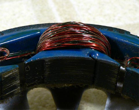

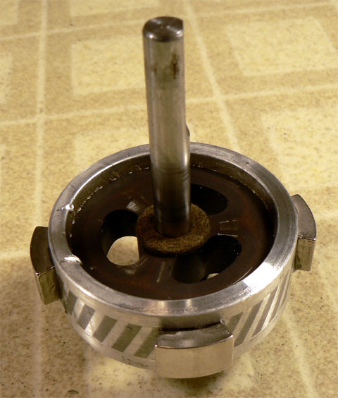

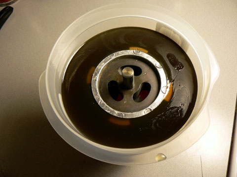

« Reply #6 on: December 24, 2006, 08:12:03 PM »

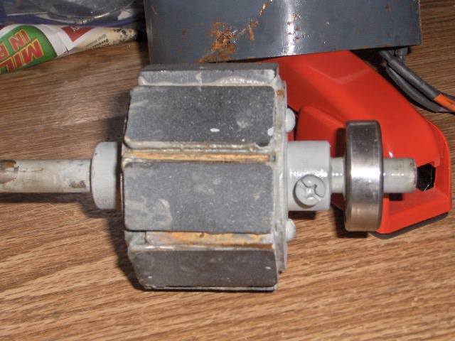

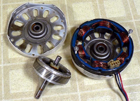

Here's the motor as it comes apart.
Here's the multi-sized winding.
Here is what I was originally thinking of to use the quarter inch by quarter inch mags in one of these motors.
After drawing it & having it on screen to play with, I am thinking that the 1.25 X .562 X .125 mags might give a better field. They would cover the stator segments quite well. If those who know could give any pointers on this...
This looks to me to be about the best setup to be had with this motor short of using curved mags.
« Last Edit: December 24, 2006, 08:12:03 PM by Spdlmt150 »

Re: Dec 24, 2006
« Reply #9 on: December 24, 2006, 09:14:42 PM »
This is a true 6 pole motor. I suspect the multipol windings may be useable. I would think its a 3 speed. This means it was wound posable with 3 wires in hand. Low speed uses coil #1 med speed uses coil #1 plus coil #2 high speed uses coil #1 + coil #2 plus coil #3. High speed would have all 3 coils in perelell.
I use the slightly larger version of this motor and just seperated it into 6 indevidual coils, then you could wire it star. Use 4 magnets and its a 3 phase pma.
It was originaly made to operate from 120 volts or 20 volts per coil. In the star configuaration 2 coils in sires would be 40 volts then acount for the losses in star the voltage would be 68 volts. As a pma operating a low rpm and with 4 magnets the voltage will be much less but quite usable maybe on a small scale?
« Last Edit: December 24, 2006, 09:14:42 PM by Jerry »

RP
  • Posts: 722
Re: Dec 24, 2006
« Reply #16 on: December 25, 2006, 11:37:27 AM »
In the close up image of one coil you can see the "shaded pole" on the right side of the pole shoe.  This little extra pole hanging off the side has a single shorted turn of thick copper or aluminum wrapped around it hence the lump seen in the blue paint.  The shorted turn on the shaded pole is there to create a slightly out of phase magnetic field which causes the motor to rotate in one direction when under power.
You want to cut that loop of wire since it causes a loss in a generator.  You don't have to remove it completely, just "open the loop" but cutting the copper wire with a Dremel or even a chisel (carefully) on all of the pole shoes.
« Last Edit: December 25, 2006, 11:37:27 AM by RP »
Re: Dec 24, 2006
« Reply #17 on: December 25, 2006, 06:53:20 PM »
I've been converting AC induction motors going on 5 years now. With the 36 slot the cogging is not bad with 6 magnet poles. But the 6 slot motor with 6 magnet poles allmost requiers a pipe wrench to turn the cogging is so sevier.
I use 4 magnet poles in the 6 slot 6 pole motor. This makes for a true 3 phase pma.
The coils may then be configured in a # of diferant ways. Star, delta, sires, perelell, sires/perelell and Jerry rigged.
With 4 magnetic poles the armature may be spun with ease with thum and forfinger.
Heres a couple pics of a 2 in hand stator during coil rewinding.
« Last Edit: December 25, 2006, 06:53:20 PM by Jerry »

Re: Dec 24, 2006
« Reply #20 on: December 25, 2006, 09:34:30 PM »
Not quite as rushed now. All this is for 4 magnet poles.
I don't believe the 1/8 x 1/16" will do much at all. The 1/16" is too thin. The 1/8" will have a lot of losses and are hard to get together to amount to much surface area. If you decide to go with the tiny magnets, leave the factory wires and reconnect them as in my diagram in the link I posted above. I have a feeling you will need all the turns you can get. They can be changed later if need be.
The 1.25 X .562 X .125 will have a very large effective airgap. It may help with the cogging, but the output will suffer. And the magnets are SO wide it may cause cogging... I'm not sure about that one.
The 1/4 x 1/4 should be OK if all 9 are used.
I don't think there is a common flat magnet much better suited to this than a 3/4 x 3/4" and 5/16 or 3/8" thick.
I only have a few in various stages of completion, or lack there of. Pure 'Jerry Rig' works best on most with factory wiring. Delta output is less. Star output is lowest for 12V because of the resistance (do not be fooled by the high open voltages).
An amp at 12V is easy with the factory wire and fan blade, given some Good Wind.
If I ever get around to rewinding one, I'm going to try 130 turns per coil (tooth), test it, and connect it Jerry Rig or Star to suit my needs.  A single degaussing coil from a TV or 15" monitor would be plenty of #20 or #21 wire.
Do not get too carried away with 'better neos'.  It can cause cogging in these.  My best guess is the flux leaks to the other coil laminations after the intended lamination is past saturation.
http://www.fieldlines.com/story/2006/8/23/144336/344
Having access to good machines, it could be worth looking for a motor like this...
It is almost the same size, but far thicker, and with much heavier wire (2.5 ohms per coil by the meter).  1/6 HP 115VAC 6.2A.
It may be a decent cantidate for the 1.25 X .562 X .125 magnets, standing up and stacked a few deep. It is from a vent fan of some kind. Semi common.
Stuck rotor with 4 curved magnets, but it shows some of the good stuff.

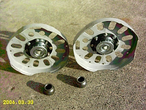

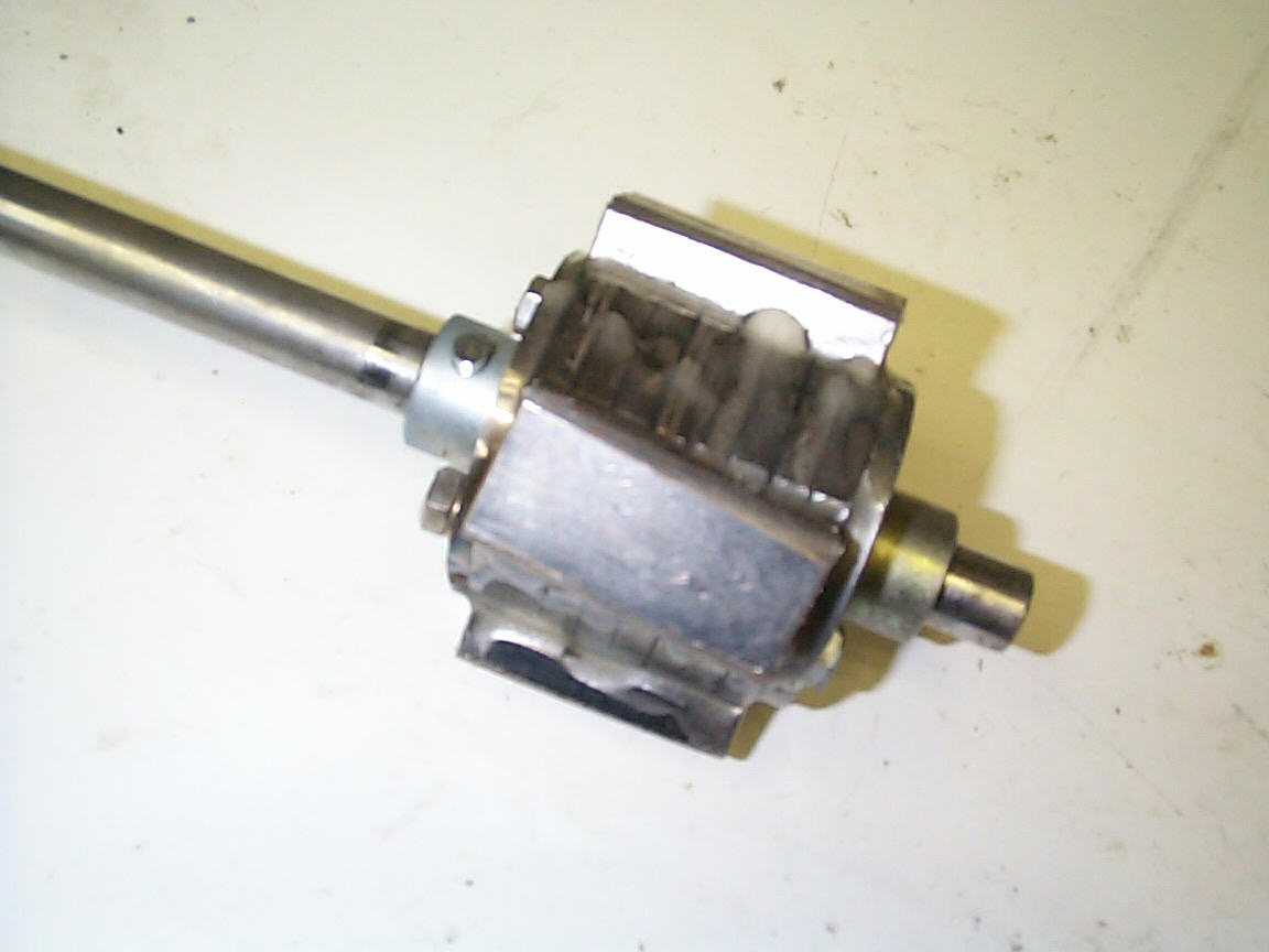

Here a couple pictures. This first will be an 8 pole motor. I built the armature totaly from parts found at Lowes. I just wanted to see if it could be done.
The shaft, the bearings, large metal washers cut to octigon, 8 of the $1 ceramic magnets, glue and some gray paint.

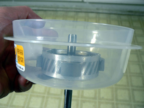

Here is a simular 4 pole armature using the 1"X2"X1/2". Notice the scewing. This could be done with the ceramics also but very littel output. First pic is armature in motor stator.
Now the armatur.

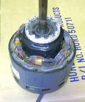

Now that things are slowing down a bit....
Since I didn't see any simple way of removing the shunt without damaging the windings, the wire is now removed & the stator will be rewound. I expect that rewinding will provide higher output than the original windings in the motor.

Is this the Lakewood that you said you have two of?
If so you might consider stacking the laminate stators and wind them as a single (longer) stator.  This assumes that you can cobble it all back together into a single frame.

I have two in hand, and I think possibly another 5 coming. I had thought about that. The way the motor is assembled, both end caps sandwich the stator. Doubling the stators could be done, but the shaft isn't long enough to make it.
I am thinking the 1st one I am going to shoot for keeping it close to original.
After that, I think 3 of these stators stacked & rewound, with a from scratch armature with some longer magnets could have quite a bit of potential.
« Last Edit: December 28, 2006, 07:51:28 PM by Spdlmt150 »

Thats why I like the one with the stuck rotor. The stator is ~1.85" thick (my Lakewood stators are 0.5"). And comes with heavier coils.
The diameters are all about the same, but the ends are much heavier.

As I am back to work now, I also have time to tinker. One of the lakewood fan motors went to work with me today. First the armature was turned down to fit 4 neos with a .015" airgap. The mags are now glued to the armature, and will be poured in fiberglass resin.
The shunts were completely removed from the stator. I used a grinder with a scotch brite disc to skim them down, and then a small punch to knock the remaining copper piece out of the slot.
There is a bit of cogging with the 4 magnets, although I wouldn't expect any output in low windspeeds and the cogging isn't severe enough to keep things from breaking loose at a moderate windspeed where this small gen could actually create power. It can be turned by hand, although it certainly doesn't free-spin. The image below is a video clip 263kb of the motor being spun with the armature in place. It is still on the original bushings.
The next thing happening is plasti-dip to recoat the stator. The rotor will be poured in fiberglass resin. Providing the resin sets overnight, it will go to work tomorrow to be turned down. Bearings will be coming soon.
Progress is a wonderful thing to see.

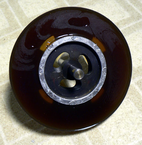

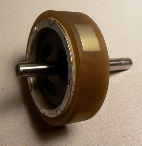

The armature of the lakewood is now poured. I had an idea which I wasn't too sure of, so I didn't post until it proved out. Here's how it goes... First, the magnets were superglued in place. A cheap plastic food container ($2 at Kroger) was drilled to allow the shaft to go through. I hot glued the face of the armature to the bottom of the container to keep the fiberglass from getting on the shaft.
I was primarily concerned about the hot glue giving loose & letting fiberglass pour down the shaft. It leaked very slightly, but not enough to make it to the shaft.
Aside from wasting a little fiberglass due to the large diameter, it worked flawlessly.
The cured shaft went in to work this morning, and got turned down. The gap from magnet face to stator tooth is .02" There is .01" fiberglass over the top of the magnets. It looks kinda like a new age roller skate wheel.
I am now coating the stator with plasti-dip. It is a little thinner than I expected, so I am spending a lot more time than planned putting multiple coats on. Pics will come soon.
« Last Edit: January 06, 2007, 02:45:24 PM by Spdlmt150 »

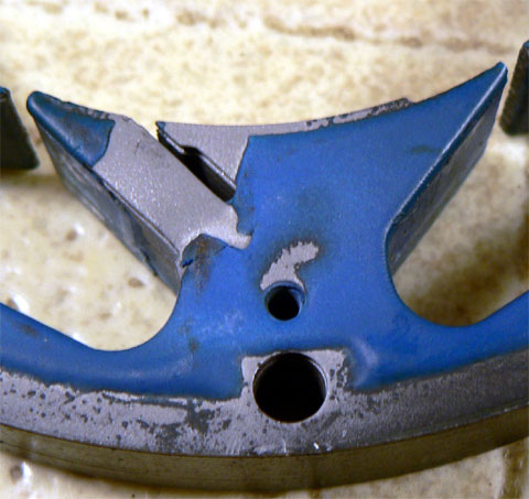

So much for the plasti-dip. It seems to peel & split too easily. My first wire wrap shorted to the stator, so strips of good old electrical tape are now working well. The first test coil on the lakewood is 225 wraps of 25 gauge. 2.5 ohm resistance. Using a craftsman drill to drive it (rated at 1200 rpm) it is showing 7 volts. There's enough current to throw a spark when shorted. Am I thinking right that with 4 mags, 2 poles in series producing current, I would have to run 550 wraps per pole to get the 12v cutin below 600 rpm?
It is starting to look like all six poles would be required to produce any amperage, and with a .5 inch thick armature & stator and the wide stator segments this isn't going to produce much of anything.
Any ideas?
