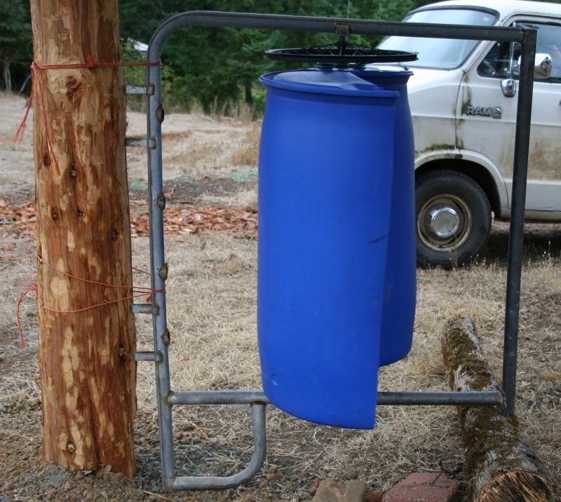

So there's the frame for my vawt. C- work if I'm the judge but it didn't come out too bad. The vawt spins well and that's what really counts.
You know how they say, "measure twice, cut once"...I didn't really measure at all. Oh well...
Somehow the height came out exactly perfect - in order to fit the vawt in I have to slide the bottom bolt in first and then the top requires just the right amount of coercion and force to get it in too. If the nuts ever come off somehow it should wobble (not really) but not fall down. ;)
The width is a bit more than I needed, with about 1.75inches clearance on either side, give and take.
Of course I had a bit of trouble welding the thin-wall tubing because even on the lowest setting my welder wanted to put holes in it. I did a lot of practice welding on some scrap pieces though. I think it came out ok for someone that's never really welded much before.
I still need to decide how I'm mounting it to the pole and I need to weld on a couple of reinforcement tubes so the frame doesn't move/twist in the wind. I need to paint the frame too so it doesn't rust out at the joints. And the air compressor still needs to get mounted as well, of course.
At this point the whole thing weighs just 37lbs and I'm still expecting the entire thing to be 50lbs or less. And the only reason I really care is 'cause I'm gonna have to haul it up a ladder at some point, which should be an exciting experience.
Anyone want to guess at what the frame use to be?...should be pretty obvious. :)

air-lift water pump. You can't see it in the pic but the well is just a foot or so this side of the log in the lower right.
Bike rack, good call. I think I'm gonna hack the tube on the right off and square it up a bit better...the more I look at it the more crooked it looks.

Sorry, it's wasn't a bike rack...
I was a bit dopey last night - long day and lots of ibuprofen for my back. I meant to say that calling it a bike rack gives it more character than calling it the "frame". Thin-wall tubing wouldn't be good for a bike rack anyway since you could get a dull hacksaw through it in a hot second.
I'd give a hint but I want to milk it. Still accepting guesses. ;-)

Pretty Cool,  I am guessing the frame is a cattle gate?

I hope its not part of a guard-rail at a IRS building!
Just joking. It looks alot like tail pipe for autos to me. Can't wait to see that Big Bear in action.

Ding ding ding, we have a winner! I guess I owe you a drink now, eh? :)

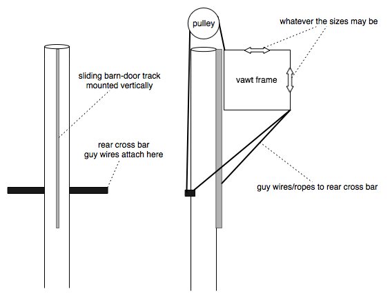

how about this for a mounting .
put a pulley at the top of the pole .
use some of that track and wheels  used on big sliding shed doors
but mounted vertically
now you can move  the mill up and down as you do design changes and repairs.
« Last Edit: September 17, 2007, 10:52:36 PM by electrondady1 »

That would be too slick! If it was a square pole and you planned on using guy wires that's a down-right perfect solution.
I don't think my pole is straight enough but maybe I could shim the rail. I wonder what 16ft of that rail costs...probably not terribly expensive. I'm gonna have to look into it because that would almost be too handy.
I'd need to figure out a good way to keep the vawt from moving side to side though. Guy wires would be the obvious solution but I can't tie 'em to the ground. Not only is it too close to our circle-driveway but my animals would love to use the wires as back scratchers. I could sink an eye-bolt into the nearby tree and run a guy wire to that but I don't think it'd help much.
Maybe a triangle at the top that it could latch into. Even if there's no latch, exactly, if it fits snug that should work. And then I could mount the pulley to that bit of steel. Hrmmm.
« Last Edit: September 18, 2007, 08:52:15 AM by feral air »

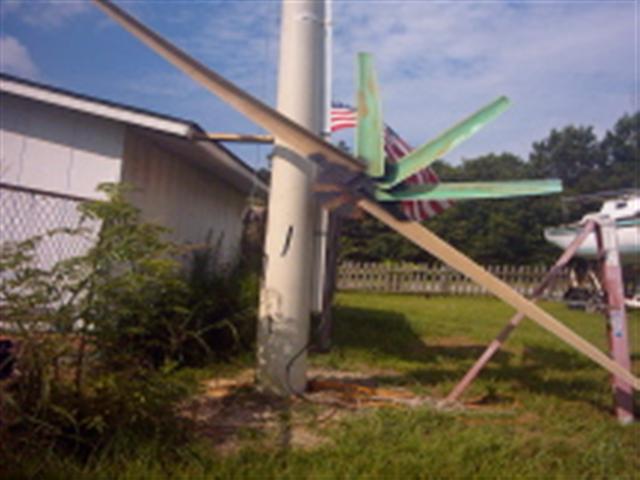

    this is the way i did it. pepa
« Last Edit: September 18, 2007, 09:47:37 AM by pepa »

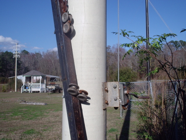

pepa
  • Posts: 461
Re: PB-Vawt Update
« Reply #14 on: September 18, 2007, 09:55:53 AM »
   forgot to mention that lows building supply has the track at about a buck a foot, rollers extra. pepa
« Last Edit: September 18, 2007, 09:55:53 AM by pepa »

my track setup is made for a machine that rotates but it would be easy to build his carrige to rap around the sides of the tree with room only left for the taper of the tree to the bottom. the track will have to be well secured to the tree as well and the only side movement would be the space allowed for the tree taper and that only on the two sides. i used 1/4 x 2' flat bar stock and molded it around the pole and welded to each side of the track at ten ft. sections with an extra strap at the bottom of the carrage. it should not stress that size tree but if high wind comes let it down. this is the picture of the bigest thing i have had up so for with no problem. the blades are 20' and 10', pepa.
BTW he could a set of wedge shape pieces for the carrage to stop on at the bearing points and it would be very secure, just a thought pepa.
« Last Edit: September 18, 2007, 02:45:21 PM by pepa »

i think you could weld/bolt, the wheel carriage and  mounting backets to the rectangular frame you made .
those doors are very heavy and that carrage is very strong.
i don't think the wind load from a 12 square ft swept area would deform the track enough  for it to get free
if the mill is balanced there should be little oscillation.
it may deflect slightly during a change in wind direction.
because your pole is "bent"(hey, nothing personal !)
you may need to make the track all one piece (weld)  and attach the railing so that it would be able to run vertically , even if it needs to kick out at the bottom
then just make up support brackets of what ever length is required.
