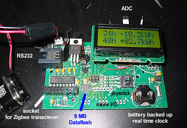

I'll send what I have once I start logging. That's part of my "charge controller" and I have a head start on that since I'm using an existing hand held controller to do the job.
http://www.otherpower.com/images/scimages/6527/ccITW_01.jpg
I've had to make a few mods to the board. The base design used a graphic display and used all the ADC lines as data ports to talk to it. I swapped that out for a text display that can be controlled with 4 bits; you can see at the top of the display were I sliced the 4 ADC lines out of the ribbon cable (and a couple of unneeded control lines as well.)
The board has a lot more features than I would have put in "the $5 charge controller" but they were already there and it's nice, for once, to be starting with proven electronics!
I haven't decided yet whether I'll be using the battery cables as shuts or do current sensing with hall effect sensors but so far the shunts are working great on the MPPT controller so I'm leaning that way.
- Ed.

I see you built a Watt meter.
Do you have any info-schem for it?
Thanx
J
« Last Edit: January 11, 2009, 05:29:01 PM by jeffbirkle »
elt
  • Posts: 328
Re: Toasted my new MPPT booster
« Reply #48 on: January 12, 2009, 07:47:01 AM »
Hi Jeff,
There's no schematic, I just wired four LEDs and an Allegro ACS752 to the tiny AVR. The Allegro chip is a 100 amp hall effect current sensor; they say that the newer ACS756 is preferred now.
http://www.allegromicro.com/en/Products/Categories/Sensors/currentsensor.asp
... cost about $5 USD from Digikey.
