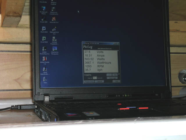

I came home to see this on my PicLog.
Today's collection is over 3.5 kWhrs, and it's not even 7PM!
I'm thrilled!
Upon seeing this, I unplugged the horses' water trough electric heater from the grid, and plugged it into my "Wind" outlet.  I installed that last month, specifically for this purpose.  Hehe I get to use it already.
With a 1500 watt electric heater draining the energy, it won't take long before I should stop and switch back over.  For now the 400-600 watts are almost keeping up with the heater (which has a 50% on/off cycle).
Observant folks shouldn't get upset by the RPM reading - that's the erroneous data that come from reading AC directly.  The noise "doubles" the frequency.  I'm just as likely to see 500W at 500 RPM as I am to see 500W at 1000 RPM.  Pretty easy to filter out later.

Up to about 4.7 kWhrs now.  Yippee!
The wind is slightly abated, now.
Seems the electric water heater won't heat water if the temperature is above freezing - so it only dumped out 0.22 kWhr before the thermostat kicked out.  It skimmed the top off the batteries, so the voltage is back down in the 28's, but rising again!
