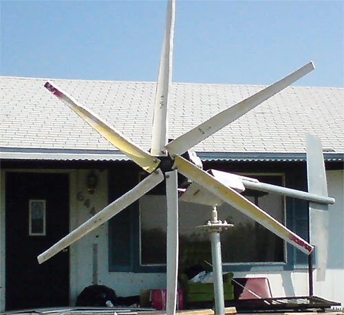

  It is charging though slowly. And the voltage of the battery seems to be jumping around. I have only been charging, I haven't used off the batterys at all because I wanted to see how long it would take to charge up. My last log which was at 10:45 last night was at 12.5v. Which is .16 higher than when I started. Of coarse I have only been putting between 1 to 5 amps into the batts. And it is a 225AH battery so I can expect to be charging for a long time. I'm very happy to be in the black though. I am a producer in minority.
  The thing that I am worried about it the vibration it gets right at cut-in. It is so smooth and quiet up to then and it goes to shaking. Looking at it, it doesnt seen to be moving a whole lot but you can see it vibrate. When it gets to about 2.5a it starts to smooth out some and by the time it gets to 5a its more of a hum than a vibration.
  The vibration starts so high I dont know how to ballance it. I thought I did a good job of sanding the blades and smoothing the leading edges. I cant convince myself to go up and take it down so I'm going to go up there and batten down as much loose stuff that can raddle as I can.
  Today the winds are low but tomorrow they are calling for 30MPH gusts. I wish I knew how to ballance it better. But I digress, Instead of talking to this computer I should be out petting the batts. Absolutely beautiful weather here today, 80's winds 5 to 10.

That "vibration" you hear at cut in is pretty normal to one extent or another it is there on every turbine I have flown. If it is smooth and not some gross shaking it is unlikely a balance issue. I consider it the sound of power being produced. I think of it as a "burring" sound. A quick and dirty test of this theory would be to remove the load momentarily and see if it goes away. If it goes away with no load you know it is not balance. Careful, it might spin up very fast with no load so try it in mild winds with minimal power draw.

Vibration at around cut-in is normal for 3-ph alternators,
and single-ph does it the entire time after cut-in.
I don't recall ever having that much vibration with a brushed DC motor.

  Well I tell ya, we had a slow stint in the wind yesturday. I pulled her down and went over everything. All seemed to still be good and tight. The pole had a little space where the yaw bearing slides down into the tower pipe, so I ran a self tapper threw the inner and outer pipe. That instantly solved 80% of the noise. I think it was having a resonant frequency thing with that little bit of slack.
  Also I noticed one of the blades was a little out of plane, so I worked on bending that back into plane. I did pretty well. When I get down and look at it on edge it is lots closer. The same blade had a little bit of outta-twist that I worked on twisting back.
  Today when ramping up to cut in, on threw, and past the vibration was nearly completely gone. But when slowing back down under cut-in it would do the same bobble but not nearly as bad. We had some real good wind today, I saw 10a on at lease two occasions. We had a new record high temp set here today 96deg.

Good find, remember that vibration is still there and is now furiously working at finding the next weakest link, keep an sharp eye out : (
