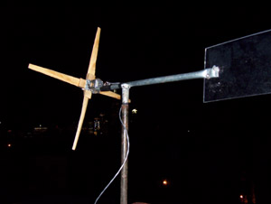

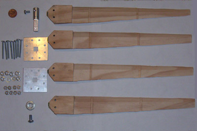

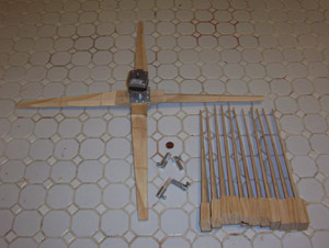

A while back I posted about the blades.  I put one set together about a month ago and connected it to a NEMA 17 stepper motor.  The stepper motor contains a magnet rotor and it is two phase.  This configuration does not require brushes.  I do not know the operating voltage of the motor but I would venture that it is not too high based upon the results.
Below is a picture of the hub components I put together.
I coated the blades liberally with linseed oil, soaking them through for the most part.  I decided on using a 4 blader because I was concerned that there would not be enough start up torque from these as a 3 blader.  I made the blades from 1 by 2 inch stock, and that is thinner that what the blade designers call for in a 3 blade set with a reasonable tip speed ratio.  The shaft adapter that attaches to the motor was made out of 1/2 inch round stock aluminum.  the generator end was bored out to .2 inches.  That was a mistake on my part for the stepper has a .185 inch shaft.  I added more set screws which worked for this one, and that problem will be corrected on the next batch of these.  The set screw hole was bored with a #21 bit and threaded to accept a 10-32 thread.  The blade end of the shaft adaptor is milled to a .34 inch square on the outer 1 inch to hold the rotor disks (squares in this case) and the blades.  The end is drilled with a #7 bit and tapped 1/4 inch 20 threads per inch.  The Rotor Disks are actually squares which I milled from 2 inch by 1/8 inch stock on my mini-mill.  I made two holes per blade to bolt the blades through and a square .34 inch hole in the middle to fit the shaft adaptor.  I hit that lightly with a file to square the corners and make it fit as it was usually a tad small and the corners were rounded right off of the machine.  The assembly was put together and the blades lined up, I snugged up the bolt in the end enough to hold the blades and lined them up as best I could.  I then tightend the end bolt a little and drilled the blades on my drill press with a 9/64ths bit through the existing holes in the rotor disks (squares).  I then bolted each blade on with two 1/8 inch screws 1 and 1/2 inch in length, held with a washer and nut. I later added additional washers in an attempt to balance it.  I never did get it perfect.  It has a slight vibration at higher speeds.
Below is a picture of the mill on my roof on the test stand that has been its home for a month or so now.
The stand was made using a couple of ten pound weights that came free in the basement of a building I purchased.  The pole is a 3/4 inch schedule 40 pipe and is about 4 feet in length.  The pipe is welded to the weights at the bottom.  The pipe is topped with a piece of 1/2 inch EMT welded into the pipe sticking out another couple of inches.  The Mill is mounted on a piece of 3/4 inch EMT which has been smashed in a vise at both ends and a little in the middle and attached to the top of a piece of 3/4" galvanized pipe with a washer welded to the top of it.  The pipe over pipe bearing is well greased with axle grease.  The tail is made from a piece of scrap acrylic, and the stepper motor is clamped to the EMT with hose clamps.  I made two bridge rectifiers out of scrap 4007 diodes and soldered them together.  I simply taped this assembly to the 3/4 inch EMT for the testing and soldered the leads to the motor and to the wire carrying down the DC.  The lead wire is allowed to rap around the tower.
I had tested the assembly before I put it up and found that at approximately 60 rpm it only puts out just under 3 volts or so.  The test turbine was ineffective for charging 12 volt banks because the required rpm was just too high.  But I figured it might be useful to light some LEDS, or for an ornamental type wind turbine, or even a remote out house light.

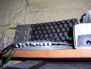

I had a pre-existing wire from the roof to my laundry room which was about an 18 or 20 guage two conductor wire.  I connected that to the mill on the roof and to a test rig in the laundry room consisting of a volt meter, a 15 farad 15.3V capacitor bank, and about 10 LEDS connected in parallel.  I added a bunch of 3.9V zeners to limit the voltage to 3.9 volts later after I cooked a couple of LED's.
At approximately 60 rpm it only puts out just under 3 volts or so.  The test turbine was ineffective for charging 12 volt banks because the required rpm was just too high.
One day, shortly after I put it up, I noticed there was no output and the capacitor bank had gone down to about 2.5 volts.  I walked out and away from my building so that I could see the turbine on the roof.  It wan't there!  I climbed up and found that the wind had apparently blown hard enough to knock the mill over.  To my amazement, the blades were not broken.  I figure they had to be going at a pretty good clip!  The blades were however bent.  It appears that the Linseed oil made the blades resilient enough to not break, and maybe it fell in such a way that the skimmed the surface of the roof.  They were marked in black where they had apparently rubbed the roof.  I set it back up and kind of bent the two bent blades kind of back to straight and it started up.  I moved a large planter and weighted it on the edge of the iron weights that form the base of the mill, and since then no problems with that.
Another day, I noticed no power, and climbed up on the roof.  The blades had become disattached from the hub.  I guess the set screw had not been tight enough, or the vibration of the machine was enough for them to work loose.  I found the blades on the roof, again not broken and re-attached them.  The tips are a little scuffed up and one of the blades is still a little bent from the first mishap, but other than that the are fine.  This blade set has nine lives, or maybe thats just three so far.  I am amazed the blades didn't break, and really have to attribute that to luck---and linseed oil (Thanks DanB)
They spin well most days, and provide a little more light in my laundry room, but it is really only practical as a toy, or an intermittent utility light or something.  I like to keep the little mill busy so I've made a few blade sets over the past few weeks when I didn't have something else to make.
Ghurd, the assembled set in the photo is yours.
Anyway, it was a fun little project, hope you enjoyed the post.  Rich Hagen

Oh yeah, I forgot to put any output numbers.  The power is really tiny.  It only makes about 3 watts or so in 10 Mph and maybe 15 watts max in a 30Mph gust.  I've never been around when it's been windier.  So far it hasn't exploded, as it doesn't have any furling on the test rig.  Rich

« Reply #2 on: April 07, 2005, 10:00:39 PM »
Wow, good job on the blades and an excellent post.
So do you think those blades would have enough power for a little larger mill with higher output. Maybe charge a small 12V or 6V deepcycle battery and run a CFL lamp with Light sensor for a yard light. Charge with small mill and only run the CFL in the dark?
If so, you might have a product there, replacement tops for all those junk rattle traps Wal-mart and places sell for yard ornaments. People who buy those things already have a  6-8' tower when those whirly heads come apart. They just need to replace the top and drive a couple stakes to ancore the bottom better maybe.
Very interesting post!

Hi Rich, I too have been going to a four prop arrangement for smaller machines.
It is a trade off but, for the output and the material of the blades, I think its a winner. I've come up with a nice system of carving blades out of warehouse stores lumber lately, and will try to get some pictures together.  I'm going with 2' of 1"x8" and 3' of 1"x6" and 4' of 1"x4". All laminated together and then tapered. The end result is an 8' prop that has a width of 7 1/4" to 3 1/2" with a twist from 20 degrees to 2 degrees. One I am working on for more torque. Your blades look great keep it up!

Led's are current operated devices. They need a series resistor to limit the current.
If your stepper is what I'm thinking it is, it has 4 wires coming out. Each pair of wires is a coil, with no electrical connection between each pair. If this is the case, build 2 bridge rectifiers, and connect the rectified dc in series. This should give you 6 volts, where you only had 3 before.
There is also a rectifier configuration called a "voltage doubler". Uses 2 diodes & 2 capacitors. Basically, the positive going half cycle charges one capacitor, and the negative going half cycle charges the other capacitor. The 2 capacitors are in series are far as the dc is concerned, thereby adding voltages. With one of these off each coil, and then connected in series, you could make 12 volts. But nothing for nothing. The output power will be the same, or slightly less. So the available current will decrease proportionally with the increasing voltage.

Ideally yes for the LED's.  Its such a low voltage that I didn't even bother.  Since LED's often fail to short, this is not a preferable arrangement.  Your right I should add some resistance there, thats why I fried the first diodes.
As for the motor it is a 6 wire stepper motor.  Basically, there are two wires center tapped.  I pulled out the 4 end wires from the coils and ignored the center taps.  I did put two bridge rectifiers together out of 4007 diodes, one for each coil. This would be the same arrangement as for a four wire bipolar stepper motor.  These motors come in a large variety of voltage configurations.  The one I used isn't that high of a voltage.  I think I'm stuck with what it is unless I want to rewire it or change it out.  Rich
« Last Edit: April 08, 2005, 12:00:37 AM by richhagen »

Cute project Rich, where did you get the caps?

There was a surplus auction for 95 or so on E-bay about a year ago.  They are the 1F 5.5 volt variety.  I had collected a few others previously from other sources.  Rich
