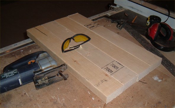

  1. Always PLEASE wear your safety glasses! I snapped a 3/8" drill bit during this project that shot accross the room like a bullet. I WAS wearing my glasses. Do not lose one of your PRICELESS eyes before you can truely appreciate this warning that we all keep hearing time and time again.

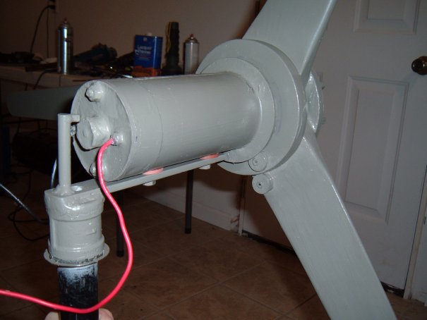

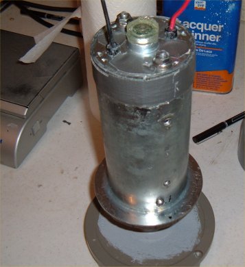

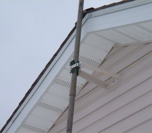

This is the support bracket i welded up from angle steel. I am going to get an old automotive rubber radiator hose ,cut it up in pieces, and add it to the support bracket instead of the scuffing pad. The overall vibration here is really not too bad.

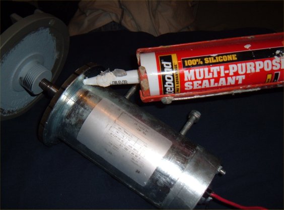

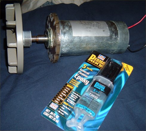

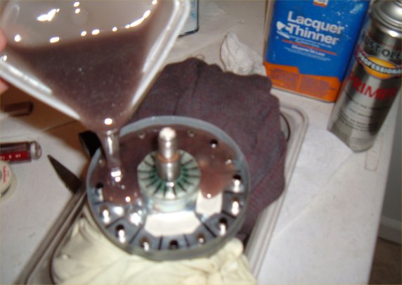

The following is how I water proofed the motor using general purpose 5-min. expoxy.

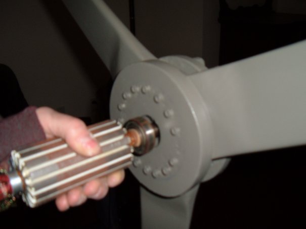

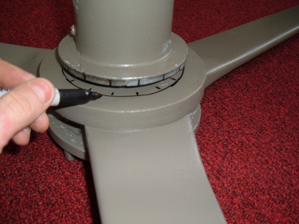

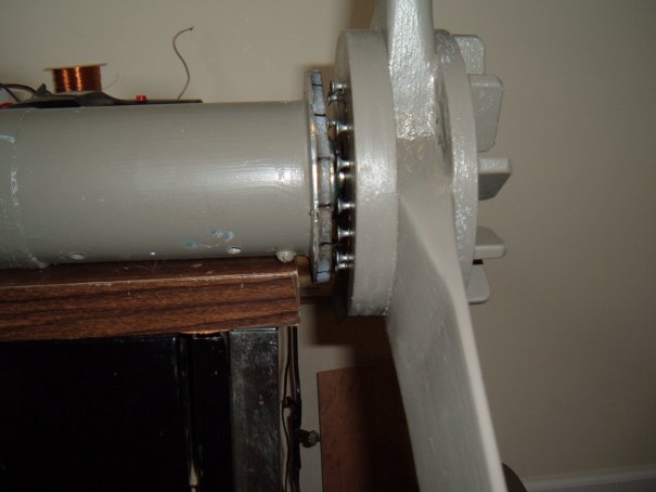

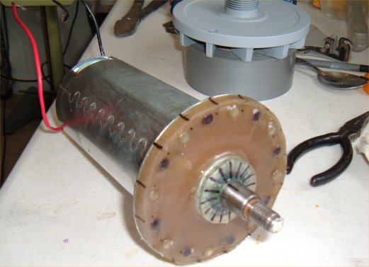

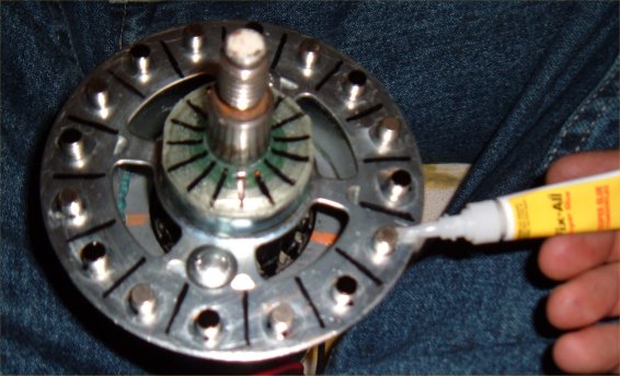

Also you will see how I made a 'MAGNETIC COG REDUCER' mechanism on the front of this treadmill motor to help reduce the cogging effects typical with all permanent magnet dc motors of this type.
There are 16 fairly light cogs to this motor per revolution. What I did was mark these as 'cog lines' and then put small super-magnets inbetween the cog lines. Later, 16 normal wood screws are exactly placed on the back of the wood rotor which 'pulls' each of the 16 screw heads toward each of the 16 magnets. What this suppose to do is make 32 smaller, lighter (easier to turn) cogs, instead of 16 harder to turn cogs. This mechanism definitly did help and was easy to do.

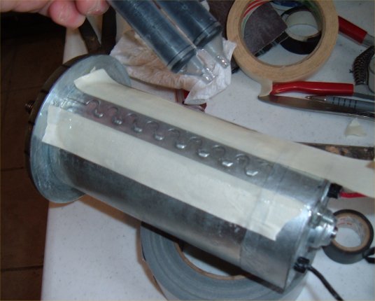

Also here you can see how I sealed the front (and back) bearings by pouring 5 minute epoxy (never fiberglass resin- it is too thin and long setting) straight over the bearing with duct tape around it. The epoxy is very thick and it sets in only a few minutes.  Always carefully put GREASE on the 'crease' of the bearing and the shaft. This procedure has always worked for me without ruining a bearing.
Here I super-glued the 16 tiny magnets down.

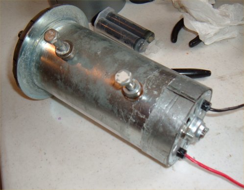

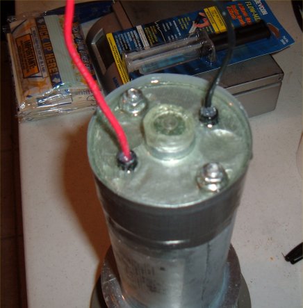

This is how i sealed the front (and back) of the motor, by putting duct tape over the holes and around the outer diameter and poured fiberglass resin. Actually, 20 minute epoxy would have worked too. It is much quicker. (spread the thick epoxy around with a disposable glue brush.)
This is where I epoxied thin sheet metal around the back to cover over two big holes. I used plenty of duct tape to hold it in place. 20 min expoxy is best for this -especially in the hot summer months.
Here I just smeared the epoxy with my fingers over these lines.
Do not epoxy over the 2 nuts here because you will want to take the motor apart again to replace brushes. Instead, put 2 normal washers down first. Then the epoxy will not go over the nuts.

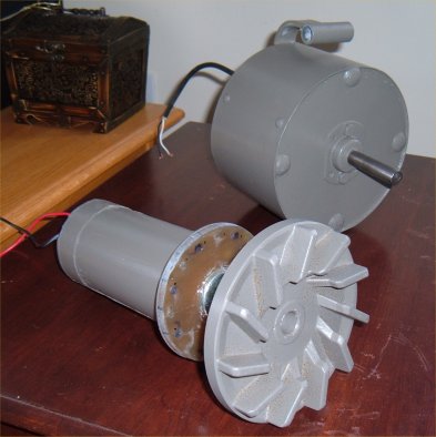

Now a few photos of how I made the magnetic cog reducer. Very simple really.

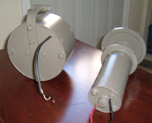

Here is both generators compleate and painted. The other one is more of a 'breeze alternator' (only 35 watts) I'll put it up in the summer.

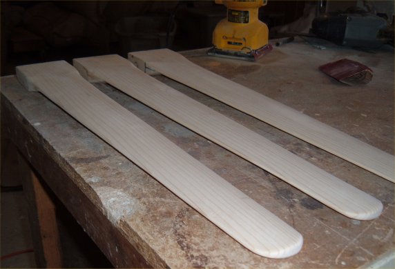

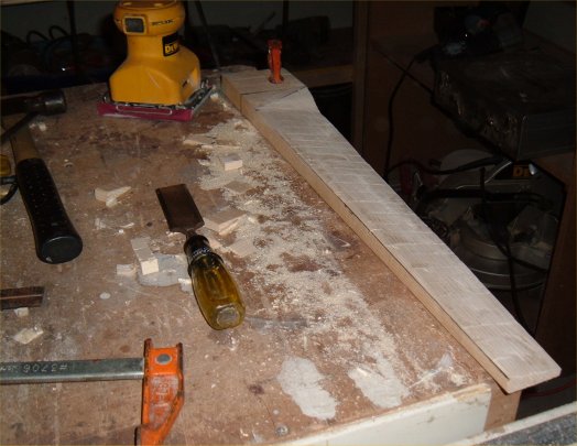

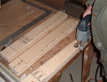

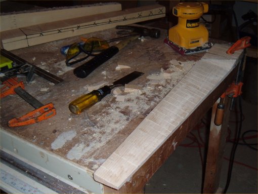

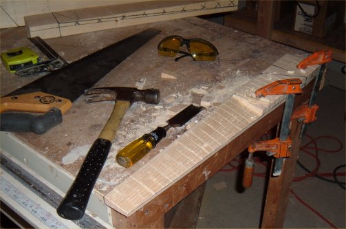

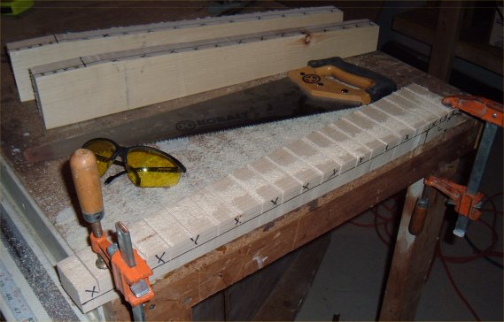

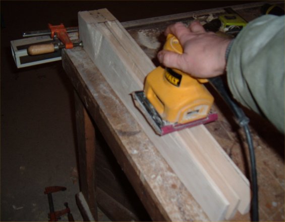

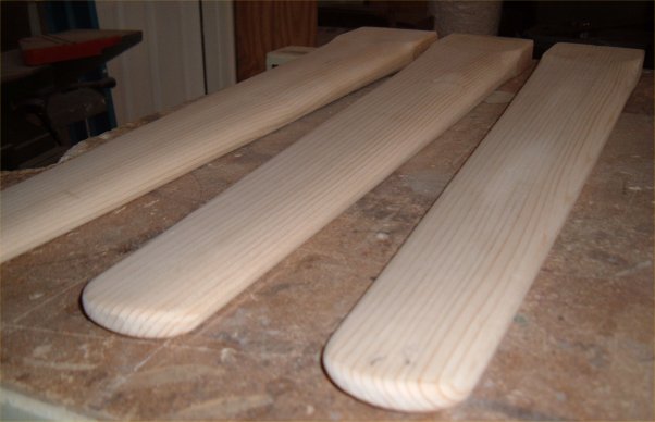

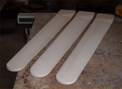

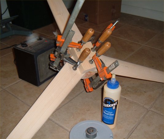

The following are how i made my very first set of blades. I used a typical $2 2x4 stud.  These are 2 feet long each.
These blades are really quite easy to make. I only used very basic tools. A jigsaw, hammer and 1" wood chisel, and a manual hand saw and a finish sander. I never needed to use a table saw or anything else.

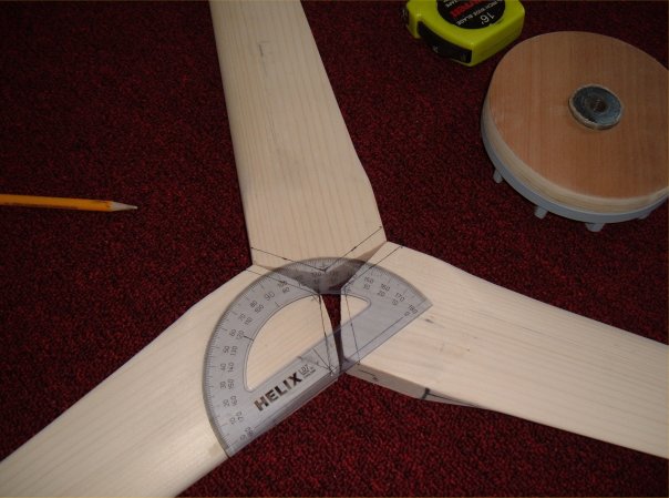

Very simple. I followed DAN B's simple 'BLADE PAGE' (sorry, I don't yet know how to insert link)

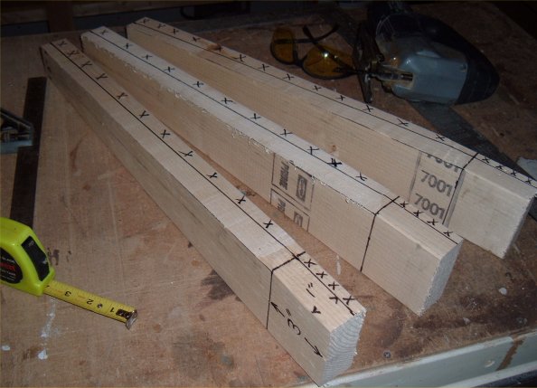

The angle at the root is 10 degrees down to about 7 degrees at the tip. Actually, after testing this turbine for a while it is overwelmingly clear to me that 4 blades would have been better (easier start up in 10mph wind) , and 12 degrees at the root down to about 10 degrees at the tip.
It is very important that the width be the same on all blades. This is how I accomplish this.

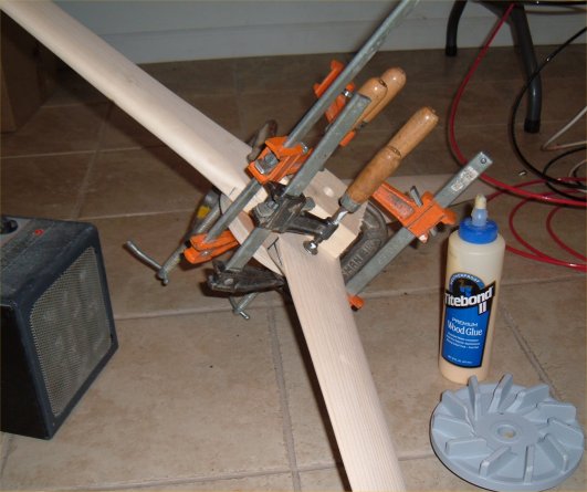

I had alittle problem with this. DAN B made it sound so easy. I cut the wrong angle with my miter saw here. It took 3/4" off the overall diameter of the rotor blades. I seriously must stink at geometry cause I'm still not certain. I marked the 120 degree lines with a marker and then jig sawed the damn thing out before the blades were ruined!

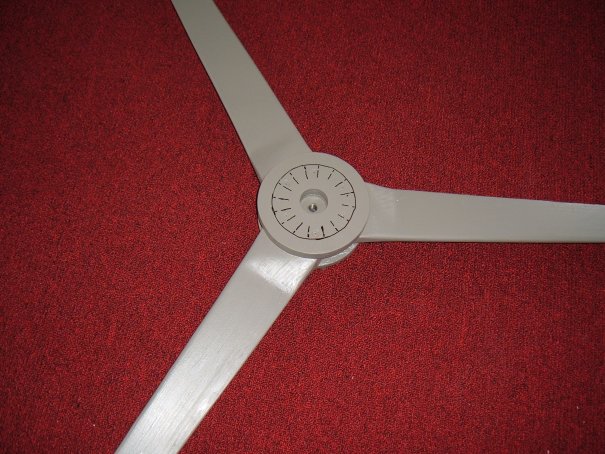

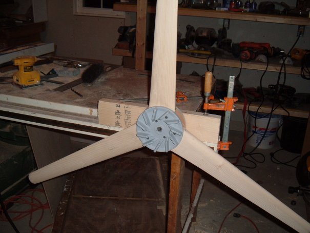

Here I glued it all up with WATERPROOF wood glue. I used 3/4" plywood (6"diam.)

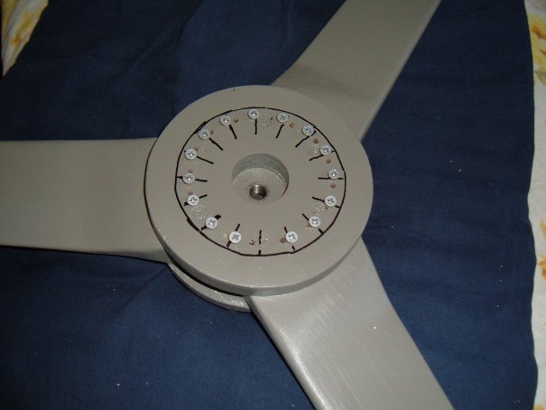

I then screwed the fan spinal to the blades.
This is the easiest way to balance these blades. I forgot to mention when making each blade, a postal scale is nice to weigh each blade as you do each proceedure to keep them as close as possible. To do a final balancing, use the armature from the motor away from the big ceramic magnets! Hold on to the two ball bearings with your fingers and you will easily see which blades you need to screw some washers to. I like to superglue them down and the screw. Try to keep these washer weight up near the root of the rotor. It is safer.
Here it is finished and balanced.

Well looks like you did a really great job. Covered about every detail pretty well in building.
 Nice mounting bracket. I geuss you have several more below to hold the pipe from wobbling around? I think I read in other posts your adding guy wires also?
I do think perhaps I would not bothered sealing things up so well myself. But the location a genny will be flown has alot to do with that. Sealing it up is good to keep salty air out if near a Ocean or such, I'm not though.
 Unless there is a reason to seal one up, I would prefer to let air pass through it for better cooling myself. Seal up the bearings if needed but sealed bearings should be fine as is I think.
Neat Idea for the Anti-cogging device. I never tried to build one. I like that idea in general and it gives me an idea how to decog a motor and add a light I wanted in the rotor hub at same time.

Brilliant decogging effort there - I've thought of doing that in the past on some induction motor conversions I did but never got round to it.  I expect a fairly small investment in small magnets could go a long ways towards 'decogging' just about anything like this.  Nicely done - and excellent writeup!

Great explanation and work! Instead of radiator hose on your support bracket, how about old inner tube or pipe insulation. They are softer, so less vibration is passed through. I use pipe insulation for everything!

Thanks Luv2weld----You are right, that pipe foam insulation stuff would work even better. Also, I meant to say this before--I'll just say it here-- but when I said using "nylon nuts" in my main comments I meant nylon CORED nuts. They are still steel nuts. I just didn't want a beginner using all plastic nuts to hold up a dangerous wind mill!  -Thanks

The anti-cogging idea is pretty innovative. I might try something similar on my dynohub, which cogs really badly, but generates 12v at only 60 rpm.

Also, what Scale/measurements did you use for your blades, are they a scaled down DanB design or your own?

You said that you are weather proofing with 5 minute epoxy
But 5 minute epoxy is not waterproof . . .
« Last Edit: March 09, 2007, 04:43:48 PM by wooferhound »

I am no Genuius on epoxy or 'waterproofing' but I had thought I read from the group that epoxy was more water resistant than fiberglass resin. If it isn't , then what is???  Hopefully, it will be good enough and last awhile.

I was told by a major epoxy formulator/fabricator "5 minute epoxy" is not really an epoxy.
The 'waterproofness' of a resin has a lot to deal with how they are formulated, i.e. what is added to the basic resin.
Nice work.
« Last Edit: March 09, 2007, 06:33:59 PM by wdyasq »

Ron ,For bonding long cure epoxies are what you look for.For sealing lots of stuff out there.

I'd want to know the use of the resin - 'WTF are your trying to do?' From there one might get an idea. I tend to use products made by major suppliers and either known by me or a trusted friend to be a good product. Curing time, allergic reaction, hardness, temperature sensitivity, adhesion to materials and several other factors are considered.
Techniques used are those proven and have previous testing/experience. All of this is combined to make a good guess at something with the hope I got everything right and won't need to redeaux the project. MANY times a prototype is built just to get a technique right or test a theory on method or strength of doing a project.
But, then again, I'd rather not do a job or project than get someone hurt or killed. I err on the side of sanity and tend to respect the success, and failures, of others as a guide.
« Last Edit: March 09, 2007, 08:00:15 PM by wdyasq »

You have good point abot epoxy if mounting blades to a hub with epoxy, or glueing the genny to the tower 100' up, neither would I do with expoxy though of course.
BUT when all you want to do is shed direct rain to keep water out, WHO CARES??
Heck wrap an inner tube around it and hold in place with large hose clamps, not like it's any saftey issue!

Most of the blade dimensions are in the photos pretty much--simple 2x4 blades---3 and a half inches wide (1 in.thick)on hub side---down to 2" wide (about half an inch thick) at the tip.(10 or 12 degree slope angle at the root(hub) side--gradually down to about 8-10 degree slope angle at the tip) I just followed the basic principles of DANB's 'Blade Page' on this website--and they really spin great. Yesterday was very windy and I got just over 500 watt hours over a 12 hour period. (Not going to lower my electric bill but plenty of TV watching ,lights and an efficiency fan)  I would still make 4 blades instead of 3 though, to capture low 10mph winds.(They can really add up to 2 or 3 hours of efficiency lighting on all those many,MANY low wind days)
