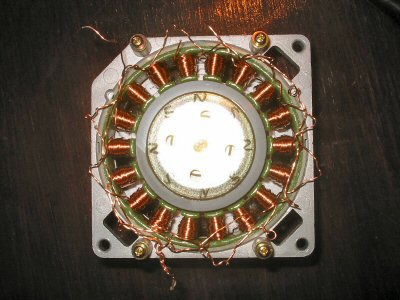

« Reply #7 on: February 06, 2007, 09:43:46 AM »
Me neither.
The resistance is far too high to get much more power than for LEDs or charging AA nicds.
The magnets are too small and weak to get much voltage at reasonable speeds.
The DVD parts I have are much smaller than the VCR parts.
I have some of these monsters too.  3.25" square x 1" thick, and weigh a pound.
They get to 3~4VDC open at high speeds.  Maybe 1A at 1.4V.  Barely good for 1 nicd cell.
http://www.otherpower.com/images/scimages/3666/Tape_drive_motor.jpg
Fun and reasonably scientific, but hardly any power.
