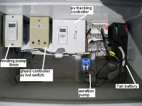

our controls are worked up as modular sub-systems as we will disassemble everything at the end of the season and perhaps use the equipment for the next build..whatever that might be.
our battery operated sub-systems include fluid pumping of the feeding solution on a timed schedule with metered amounts to each plant. aeration pumping to our solution holding tank run by a ghurd circuit to keep it oxygenated and stirred up..all powered by a 5 watt tracked pv array to charge our 7ah battery that runs everything.
the system controls.

some guesses on power requirements and production:
feeding pump ~5whs per day..five cycles 2 minutes each 2amps @12v
aeration pump ~20whs per day +/- with all available power 90mA
Ghurd controller ~3whs per day
battery self discharge ~5whs per week
ames tracker ~1whr per month
production of ~30whs per day.. 5 watt pv @ 6hrs peak sun..my site is listed for 7.4hrs in july.

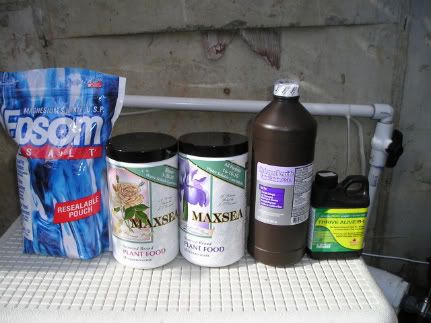

hydrogen peroxide                        $10 wally world-might need more, using 1 quart %3 per 30 gallons

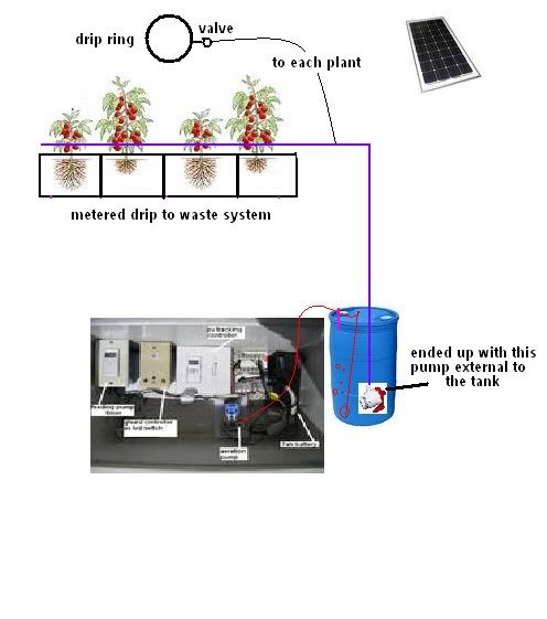

ended up opting for a "metered drain to waste" set-up in an attempt to keep it "dummy proof" (said the man in the mirror) was very concerned about PH drift and contanimation in a flooded drainback system/deep water culture type affair.
we started indoors on 3-15 and again on 3-29..was worried about not having enough seedlings  :D the worries proved unfounded.  light was just CFL's with a 16on 8off lighting and a mix of 6500K and 2700k bulbs. outside now with no supplemental lighting.
you ain't' kidding about the retail ask on those LED grow lights! still about $3/watt but coming down nicely..looks like there is a bright future for LED's as the prices keep coming down. also looks like there is still some good work ahead in customizing the exact spectrum of light for plant/cycle specific applications..yet another advantage of the future of LED growing methods.
a paste up overview of the set-up below
a look at the drip ring and metering valve above
we have our irrigation rings set to deliver ~ 4 ounces of solution per plant per minute of pumping cycle.

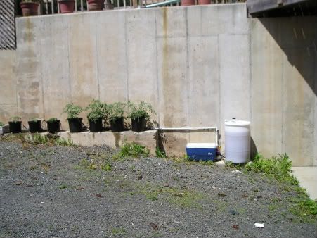

Yes - oxygen is beneficial but beware the preservative-wetting agent in H2O2 is extremely effective at helping deliver nutrients making it easier to burn the plant from over-fertilization.
Hydrogen peroxide as a full time additive in your nutrient mix just allows build up of the preservative-wetting agent, the salts in a nutrient solution will strip the free oxygen away rapidly. The key to H2O2 in a bottle is ultra-pure water and the wetting agent.
The best bet is a lot of aeration of the reservoir with the air pump getting clean filtered air, air pumps get nasty after a few months!
Also, if you are seriously in a fill and forget mode a teeny recirculating UV source (even convection circulation from the UV source heat)
Your photo shows the reservoir being somewhat translucent (white barrel) - Though sun warmed solution is good the light can/will start algae growing along with whatever wee-beasties feed on algae and their by-products... paint or cover/shade the barrel...

My BAD  It seems to be the new "measures" we put into action here at work that merely show me a flash of the pic then it just isn't there :(.
DanG : Good call on the barrel since I couldn't see it from work, very glad you caught that.
By the time you can see the stuff its already in the mix, I was given several opaque 15 gal barrels , very nice , but even for the bit of rain water we catch, I firstly bought primer and had them tint it black, the little critters don't have a chance :-).

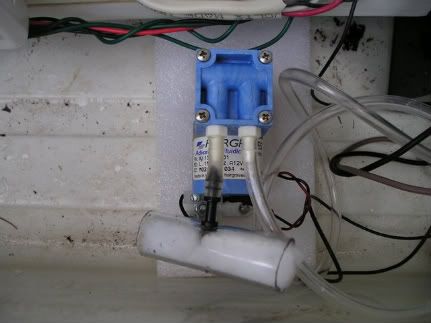

also putting together an air intake filter for the aeration pump. never gave it a thought so thanks for the heads up on that. happy so far with the air pump. on a good day it runs ~20  hours. several good sun days in a row and it runs around the clock, we have yet to see the pv push the terminal voltage past 14.4v ..watching closely though.

  Now that I've "adjusted" my ability to see the pics you posted I can say "Yikes!!"
DanG was very coorect, the sun hitting the white barrel needs to be covered. The amount of sun hitting that could certainly gets little greenies growing rather quickly.

we mickey moused up an air filter. geez i'm cheap.
NO LAUGHING!
that white fiber lightly stuffed into the 3 inch long 3/4 inch tube is sure to grow medium. an open cell PET fiber.. it's like plastic cotton.
 ::), dave

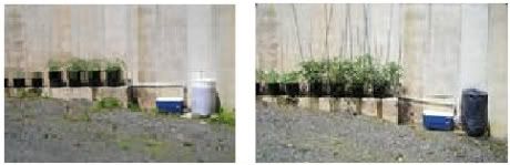

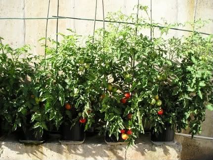

a brief garden update:

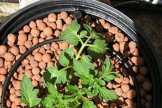

it's been three weeks since we lit the fuse on our tomato seedlings. these growth rates are something i'm not used to, amazing! but i bet things can go bad just as quickly.
a side by each shot of ten days growth..
day 11 here on the left                              day 21 on the right
fruit is setting nicely
full system view..with added light blocking measures
changes and adjustments made include:
added an air filter and light blocking as suggested here.

changed orientation of fluid pump due to anomalous behavior.

 a mid season update:
 not sure we could be any happier with the outcome so far..if anything i wish we had gone bigger with the garden setup, we are confident that the system would support a garden many times this size..even by a factor of ten. we would just need plumbing and a larger reservoir tank.
 just from these seven plants we have taken many dozens..even scores of fruit, we lost count. been giving them away as fast as we can and there are more every other day!
 a few pics.
our always smiling assistant.
the ammo.
 still running a VERY weak solution between 1/10th and 1/20th strength..have not been measuring just eyeballing.
it's all good fun!
cheers, dave
