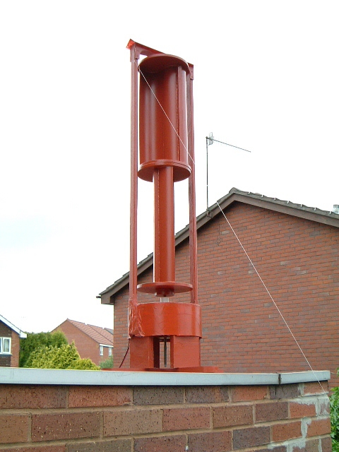

Hi All this is my first project what you think?? Its a 3 phase 9 coils 140 turns of 24 awg wire 12 neo`s.It stands about 5 ft tall about 20" wide made out of plywood and guttering for the blades.
« Last Edit: June 29, 2004, 11:12:33 AM by booner »

« Reply #11 on: June 30, 2004, 12:24:53 PM »
whats the volts amps output???
« Last Edit: June 30, 2004, 12:24:53 PM by hiker »

« Reply #13 on: June 30, 2004, 01:05:19 PM »
Hi Its put out nearly an Amp at the minute its only been up and running about a 4 days and i have not had any good winds at the mo!!.
