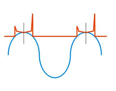

This is what I think it must look like overlaying the trigger and power circuit. You can see the voltage begin in the pulse, then being depressed by the inductive back flow. When the peak is past and the voltage begins to decline the cemf starts and spikes right at the end. On my scope it goes off the page. More than 20 volts!
Now the width of the pulse (in red) is 2.5 ms. The width of the positive part of the trigger wave (in blue) is 4.35 ms. Interesting thing is, I bought the 2n3055 from radio shack and the specs on the package says the maximum operating frequency of the transistor is 2.5 ms. Question: do I need a faster transistor to goose it more?
