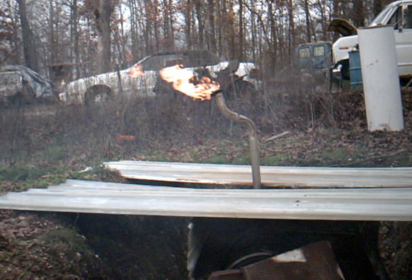

This first post is not the bigger more fancy setup I am working on, it is simply about a 20 minute quicky I built yesterday to prove to someone it works.
This is very basic. Take a 55gal drum with removable lid. Remove any plastic caps or plugs in the lid, they will melt. Fill holes by threading in a pipe cap of the correct size or simply weld metal over the holes air tight. For this one I just happend to have the correct sized plug handy for the small hole, the large hole I had a metal cap from a different type of barrel. Remove the rubber gasket in the rim of the barrels lid, it will melt and leak. For this one I left it in just to see, it did melt and I had some small leaks burning around the edges. Replace the gasket with gasket material for wood burning stove doors. That works well, also I will test it, but I think a high tempature gasket silicone would work but not sure yet.
I made the frame from sections of a couple metal floor lamps. I have alot of those junk 300/500 watt halogen floor lamps, can't give them away. That was the posts for the frame. Each section was the corrct lenght, I simply used 4 as legs standing up right, 2 go side to side under the barrel, the other two go front to back along side the barrel. Just a cheap simple self standing four legged frame which I can sit the barrel into, it worked fine.

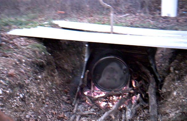

Lay barrel on side in frame, cut about a 2" hole in top, weld on 2" pipe. I had a junk section of exhaust pipe from some  vehicle handy, I used that.
I have a small pit here, I am building a fancy model of this and it will be in the pit. You don't have to have a pit. You do need to hold the heat to the barrel though. In the above picture I have filled the barrel with junk wood from dead trees that have fallen over around here. It has been raining alot so everything is wet, notice the water on top of the barrels in the first picture. Well this worked anyway!
 Would have been better with normal dry woods though, but wet worked fine.
 For my enclosure to hold heat to the barrel I used 3 sheets of metal siding/roofing.
The one is bent in a U shape making the sides and back. The wind blew it acrossed the roof and bent one side for me the other day when it hit my fireplace chiminey so I only had to bend the other side, wasn't that nice. I just had my daughter stand on it and I lifted the end and we bent it. The 2 pieces on top are just laid there of course, supported by the sides of the pit.
 We filled under the barrel with dead wet wood, around the sides also, then lit it.
 After awhile we had a hot fire burning and wood gas coming out the top.
Gee kinda looks like the gas pipe at an oil well doesn't it :)
Ok, here I did not do much except make a little charcoal and burn off the gas. The only real reason I did this yesterday was I got tired of a skeptic telling me it doesn't work and how hard it is to build such things that do work ect... Now they will be quit, at least about this one.
 In summery, you simply need a 4 legged stand to lay a barrel over sideways and a 2" pipe welded to the top (with hole cut in barrel to let out the gas). Fill barrel loosely with wood (not tight, heat needs to move around the wood and gas needs room to escape). Replace any plastic or rubber on barrel that will melt with something that does not melt, it needs to be air tight. Make a 3 sided and roofed enclosure to hold heat in. About anything that won't melt or blow away in the wind will do. Stack up some wood and get a hot fire going. First you get steam and smoke that won't burn, then in awhile you start getting the burning gas. How long that takes depends how wet your wood was and how hot your fire is ect..
 Lite gas and watch it burn. Keep fire hot with more wood as needed untill gas stops, charcoal is done. Let cool over night before opening the barrel.
 If you open the barrel while charcoal is too hot it will get oxygen and burn.
That's about it for a simple setup.
 If you don't want the gas, make the pipe bend over from the top of the barrel down the back side and run along bottom of barrel to the front. Cap end shut and drill/cut holes, basically making a burner like a gas oven. When the flamable gas comes out it will ignite and burn from the fire under the barrel. Be aware though this will become a self fueling fire and can really produce large amounts of heat and flames, not dangerous really, but it can get wild and should not be done near anything the heat or flames could damage or set on fire. If you do it this way, then as I say it will become self feuling, in other words the gas comes out of the wood, burns under the barrel keeping it hot to produce more gas, and it runs till the gas stops, and that's when the charcaol is done. Word of caution, you never want to build up a high presure, if you use the self feuling proccess then be sure to make LOTS of holes! The dryer your wood, hotter the fire, and type of wood, will result in lots of gas and high heats which create lots more gas! I have had thin oak strips (1/4 thick X 4-6" wide) I could snap like toothpicks that burnt like they had been soaked in gasolene in my wood burner. That wood will make tons of gas, the hotter it is the faster it makes it. Something like that expect to end up with flames shooting out 3' in every direction if self feuling. Perfectly safe as long as no presure is created!

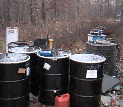

Heat is produced by a gasifier, I can use that heat to dry out some of my wood before making it into charcoal (or use it for other things too. Starting with already dried woods means I will need less feul to make the charcoal, compared to moist woods.
I think in the picture of the barrels part of a gasifier I started on is in the background. Not sure if it showed up? I would have been a down draft. I had welding problems using a torch on it, then I bought a cheapy wire welder but haven't got the rest done yet.

« Reply #20 on: March 13, 2005, 10:02:18 PM »
I got side tracked and did not keep up with this as planned so far, though still working on the system.
I am ordering a lathe/milling machine this week. When it arrives I will be working on this and alot of other projects I have started but not yet finished.
 One of the problems is I often can't find some of the things I want for parts. Often I find them but they cost more than I want to pay, around here.
So when I get my new machine I will be making tons of things I want/need instead of trying to buy them.
On a small scale I have made a filter filled with charcoal I made earlier and used that to filter the woodgas, then ran a small engine for awhile. Worked nicely. I should have cooled the gas better than I did to condense the moisture first in one container then filter the  cooler dryer gas in a second with the charcoal and that would have been even better.
 I am looking for the best/cheapest way to remove the heat from the gas and use it for something else like maybe heating a storage area full of wood to dry it before turning it into charcoal. The dryer the wood the less feul needed to turn it into charcoal and drive out the useable gas for an engine, and of course the less moisture I will have to remove from the gas also, though there will always be some.

You know, if you burried most of the rig except a pocket underneath for the starter fire, air supply, and one end to remove charcoal and add wood, you could rig the self-fueling design and burry metal pipes in the ground to heat water off the waste heat. Not only that, but you'd get a system that'd stay well above ambient long after the last batch was fired, improving the efficiency of subsequent burns. This idea might be better on the side of a ravine or hill if you don't relish digging, though.
How long will the steel barrel last in a configuration like this? Does the fire deteriorate the metal?
