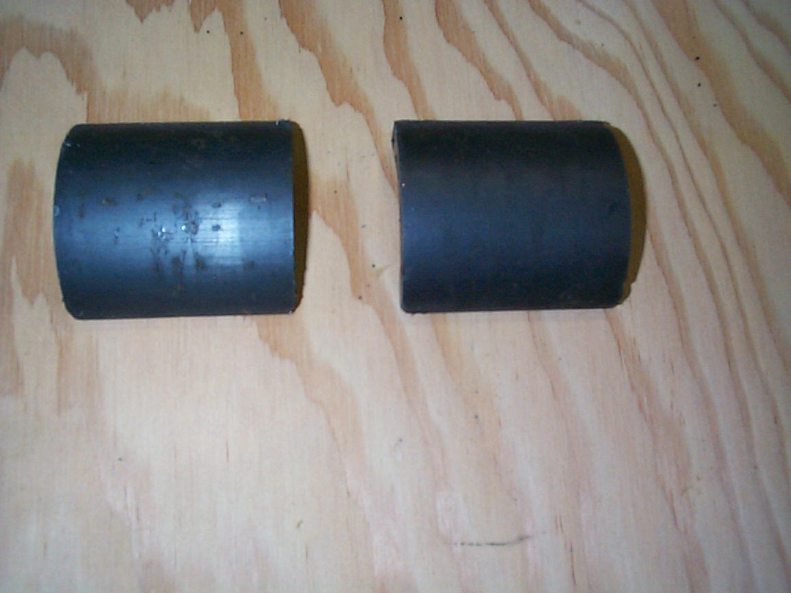

I was looking for a solvent to remove magnets from things liks dc motors and speaker baking plates. Someone had suggested Accitone. I tryed that and I had a 1 gallon can carborature cleaner with the basket. The carb cleaner worked good the accitone didn't.
I had placed a 1/3 HP garbage disposal motor stator in the carb cleaner. This is the high rpm dc type motor. Just the outer casing and its 2 magnets went in the carb cleaner.
I left them in over night. Today I just pushed the magnets out of the housing.

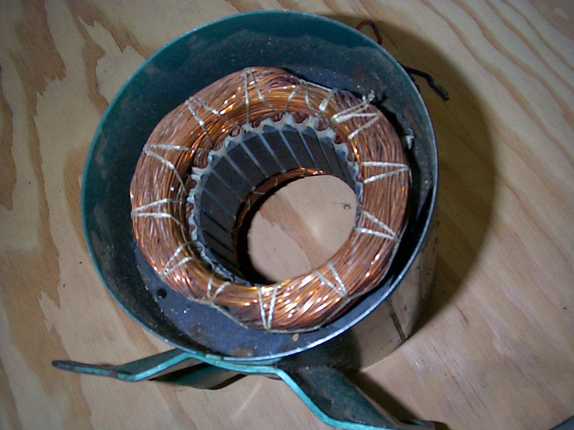

There just happened to be a 2 pole motor stator right there. So just for fun I set them in the 2 poles bore and they fit nicely.

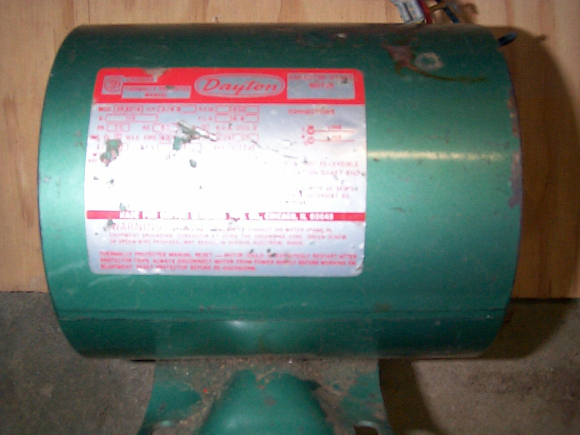

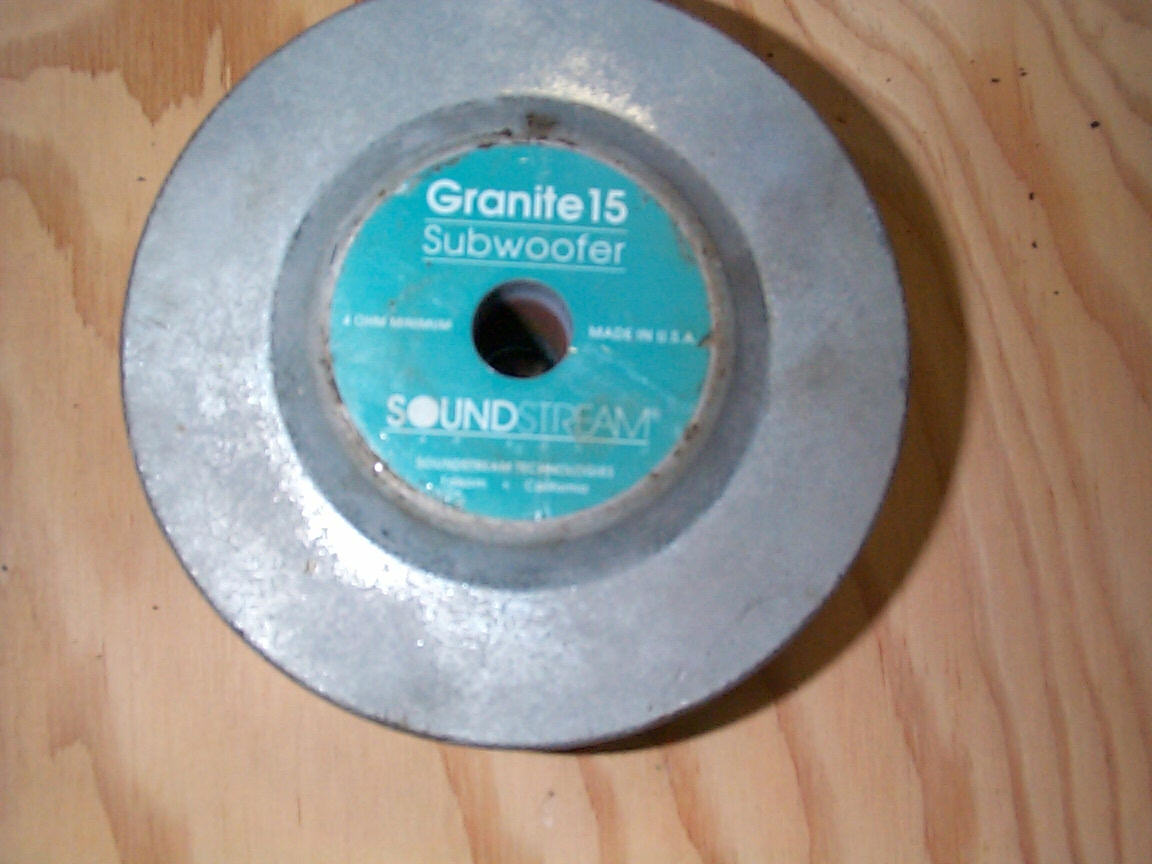

So I'm going to use the curved ceramics in this 120 volt, 2 pole, 3450 rpm, 14.4 amp motor to see if it makes as much power as my Lowes ceramic disc dual rotor alt?
The race is on?
I'm building the armature from the magnet pole pieces of 2 old junk subs.
Heres a few pics.
Here is the doaner ac dc garbage disposal motor. I've tryed these direct but they need too much rpm and they don't have a good shft for blade mounting.
Here are the 2 magnets I pulled out after soaking over night in carb cleaner.

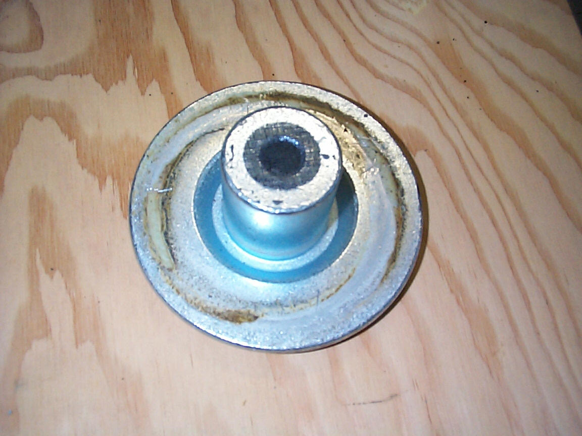

Here is the speaker magnet end plate.
« Last Edit: February 20, 2005, 10:36:08 PM by Jerry »

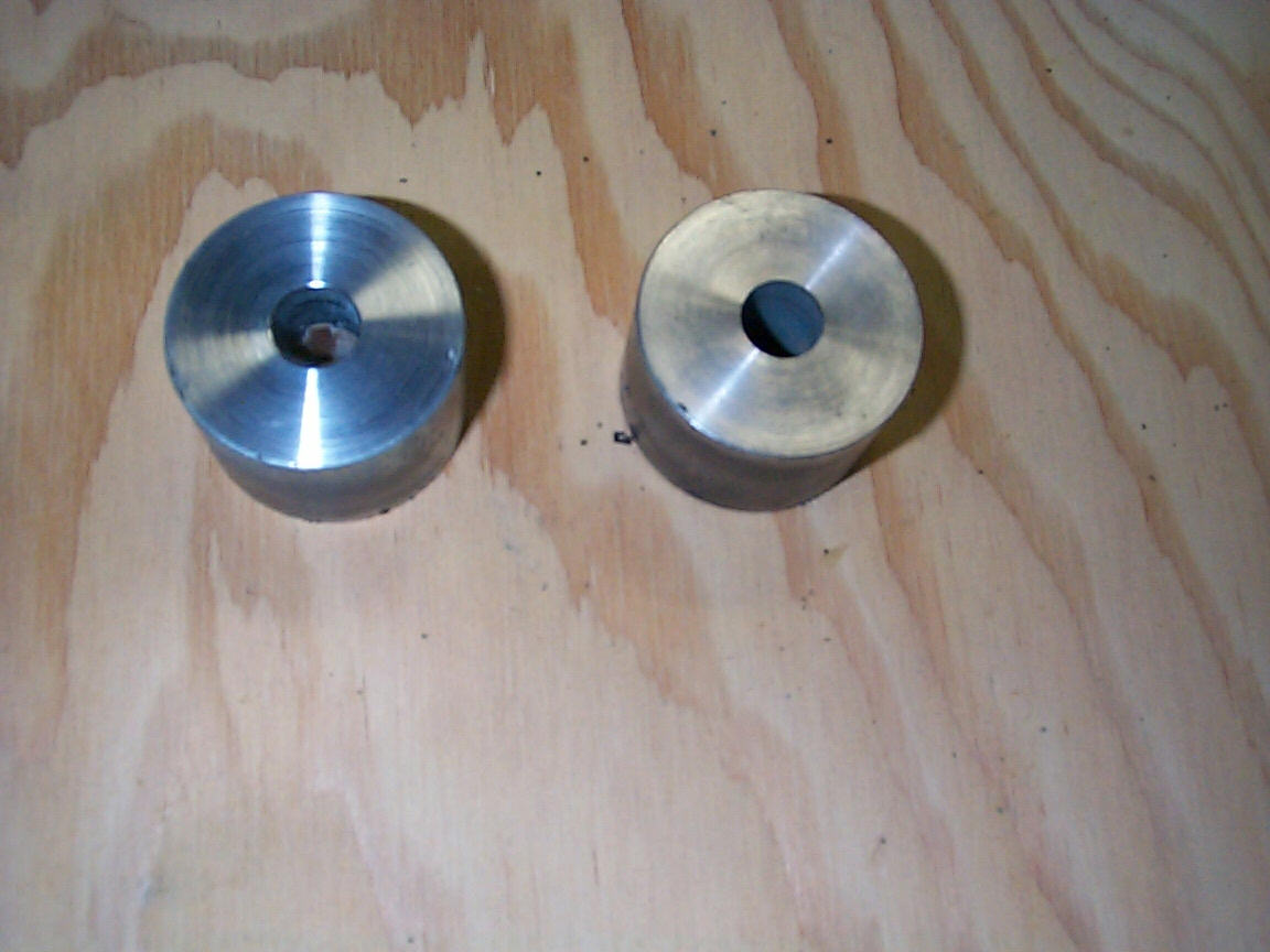

Pix after machining the end plates.
A couple shots with pole pices and magnets.
« Last Edit: February 20, 2005, 10:41:02 PM by Jerry »

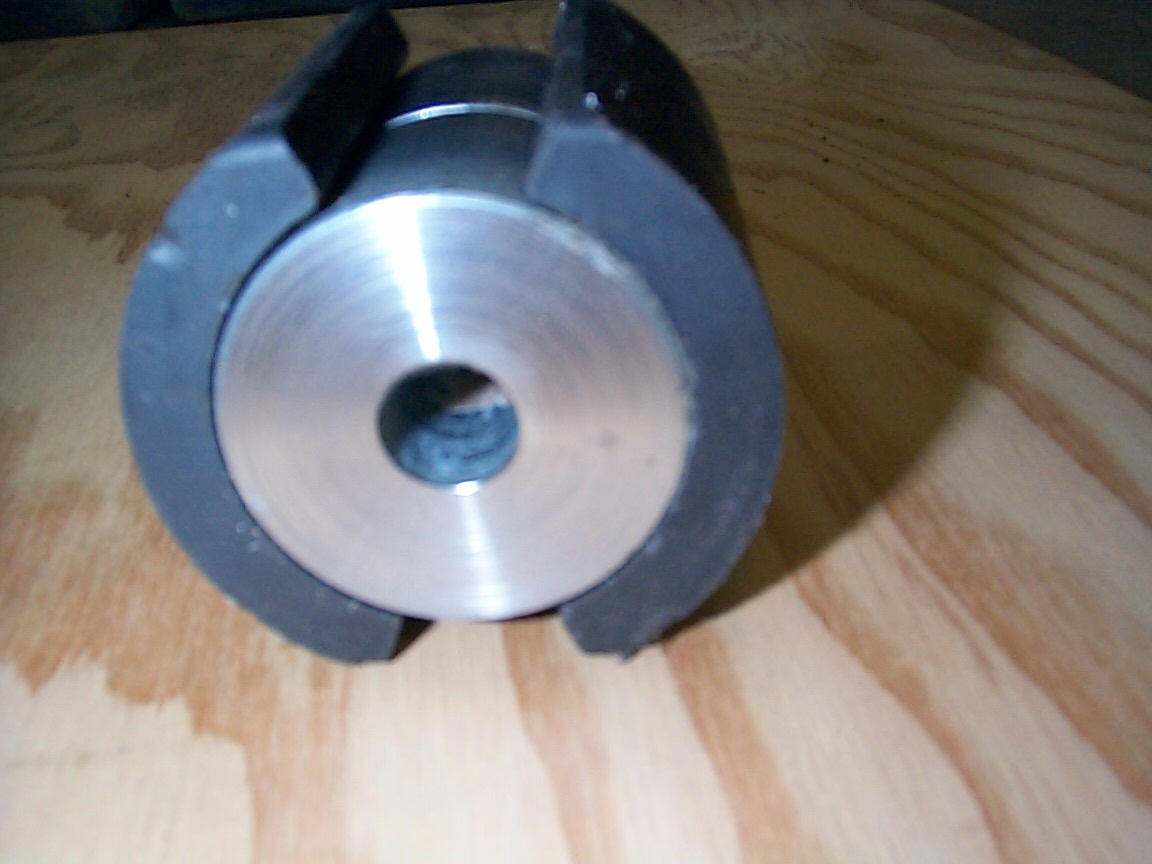

Heres pix of the motor and magnets in the bore of the stator.
Well now to get the other stuff scounged up, shaft, end plates, bearings and such.
I'll bench this one with the new motor speed control I just posted about. Kill to tests with one?

The magnets are glueing now. I used JB Weld. The type with iron stuff in it. I wanted the iron stuff to fill the gap between the iron center core and the magnets.
There is a slight diameter diferance. I hope to test this unit in a day or 2.
