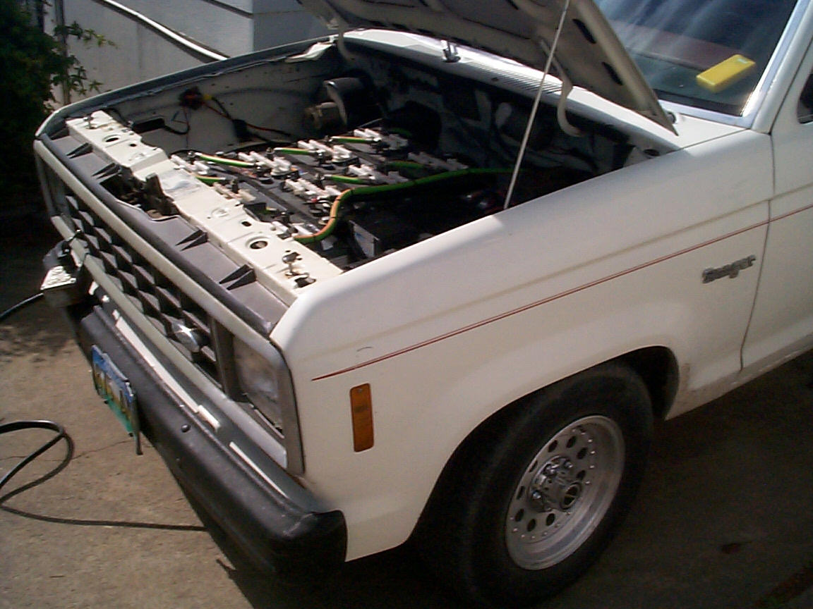

My son and I completed a 1985 Ford Ranger EV conversion a short while back. Well he did 80% or more.
Like machining bell housing to motor plate, flywheel to motor adaptor, pilot bearing adaptor, front motor mounts, battery boxes front and rear, wire jumpers, for & aft cables, master power contactor & on & on & on.
I did supervise from the easy chair and supplied batteries, wire, split loom, wire ties, and oh ya my old guy oppinions.

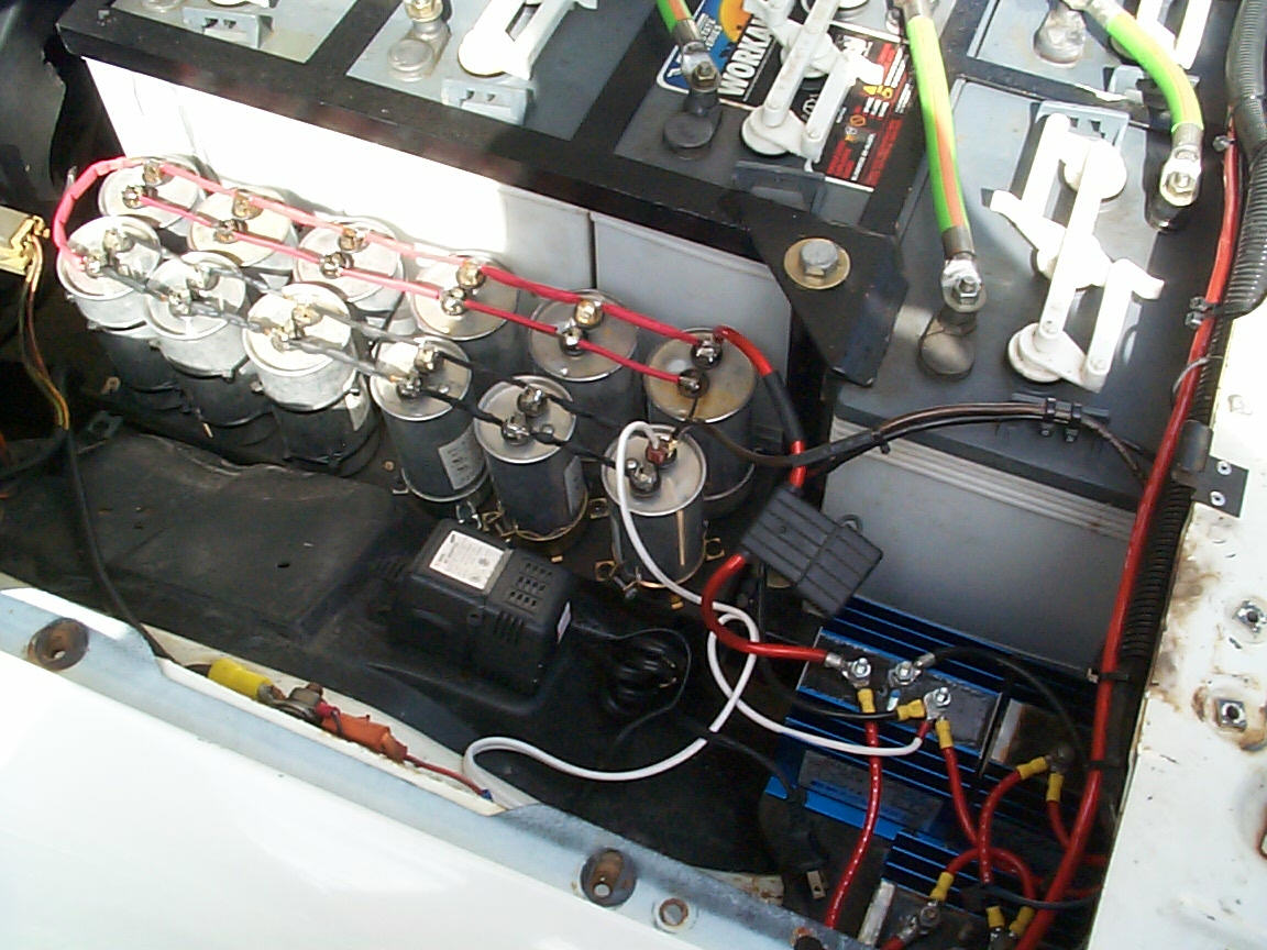

We built the charger into the truck under the hood. It consits of 900 UF of motor RUN caps and 3 auto type battery isolators configured as a 100 amp fullwave bridge rectifier. Thats all they are anyway just some diodes in prety blue heatsinks. 7 amps over night has it good to go for the next day.
This still of charger or pulser desulphater has been discribed here on the board befor. I love it. Its very light, small and very eficient.

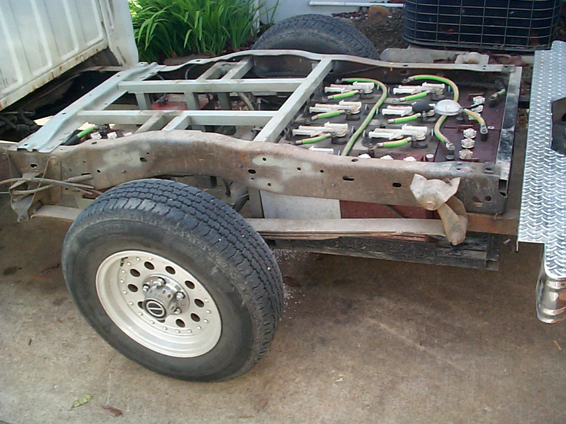

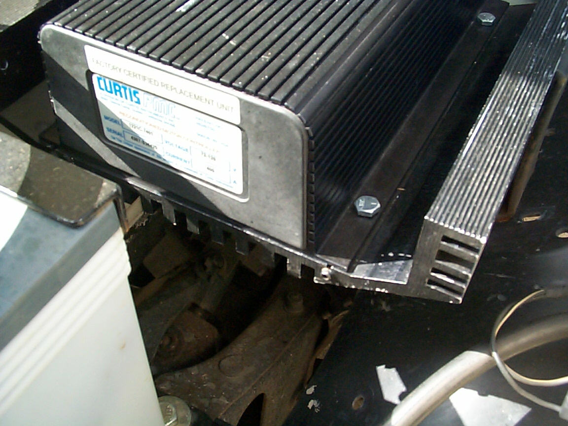

We have 20 six volt batteries onboard. 120 volt system. We use a Curtice 400 amp 120 volt speed controler. Its pictured below thermo coupled to an old amplifier heatsink.
Were using a 56 hp Addvanced sires wound 72 volt motor.
I've been driving the truck 3 weeks to work and home. Thats 7.5 miles each way.
Many days I use it for eronds all over town. Its fun to drive. Very quiet. No need to push the clutch in at the light either for stopin or startin. Thats rests my old tiered leg.
I driven 30 miles on one charge. A few of the batteries are rejuvinated or desulfated. I think  it would go 50 miles on a set of new batteries. But we allready had these and I can cruse at an easy 55 mph. We did top it out at around 65 on a test run.
My son estamated it takes about $20 a mounth from grid power. I'll be charging it from my store and home wind power next fall when the better winds come back. That will be a free ride.
I should save $1500 a year or more in fule costs?

Very nicely done.
Is there any way to get a schematic of the speed controller off you?  :)
And a detailed description of how you built your charger?
What do you do about the 12V system in the truck?  What do you use for a DC-DC converter?

The speed controler is a Curtis. They may or maynot give the schematic?
You could build your own. We looked into that a littel. We tosed around the idea of using one of those small motor speed controlers and amplifying its output with the big IGBTs.
Not enough time to expiriment and develop a good working unit but I may do that in the future.
I have built simple speed controls with large relays and taps on the battery banks at 12v, 24v, 36v and 48v on a couple modified/hope up golf carts. You can also use home made large resisters from stainless steel strips. You bend them into a zig-zag and tap them a several points along the way.

I took the picure with the bed off. We wanted this truck to look as stock as posable. Thats why we framed the battery box under the bed. Now I'm working on a lift bed for easy battery access. It also will dump a load of barkdust nice. I'll be beefing up the suspension some although it only sits slightly low in the rear.
I have plenty of power on board to run thre lift. Thinking of a 120 volt dc wench also (2.5 hp tred mill motor) I have some real nice 90% gear heads for that.

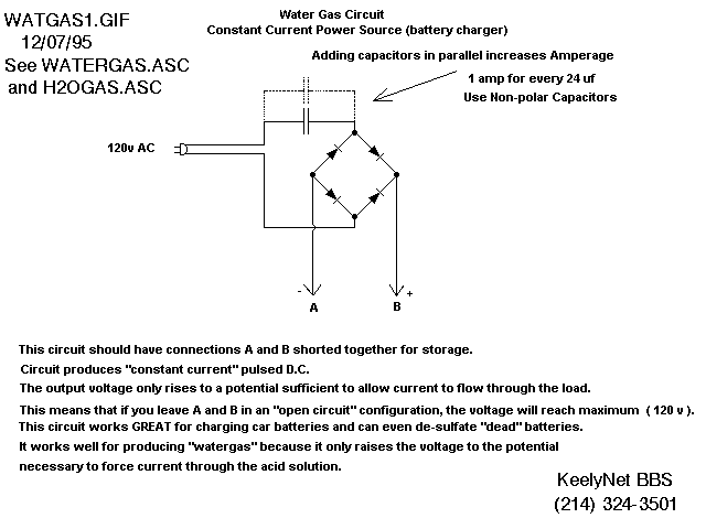

The charger is the pulse charger idea posted here several months back when all the pulse charger desulfater threds were going on. There has been a schimatic posted here. Maybe someone could repost that diagrm.
Its abit dangerus since its tied directly to the ac line. I can't post the diagram but I'll try to disrib it. It is very simple and It works very well.
One side of the ac line is conected to one terminal of the capacitor. The other terminal of the capacitor is conected to one of the "AC" terminals of the fullwave bridge. The other "AC" terminal of the fullwave bridge is conected to the other ac line. The dc outputs of the fullwave bridge are conected to the battery.
If you made this setup without the cap the bridge would expolde. The cap provides the pulseing.
For 12 volt charging 24UF delivers 1 amp of chargeing. Nice thing about these chargers is they don't care if the battery bank is 2 volts or 120. The battery bank voltage will vary the amperage.
The caps are motor run NOT start. Start caps will get very hot and self distructed.
I'm using 900 UF of caps. At charge start up I see about 15 amps of inrush tapering fast to 12 amps and after an HR or so levels of to 8 amps.
I'm using a group of missmached batteries. Some with pore SG are starting to get much better SG and catch up to the better batteries.
As far as safty conected directly to the AC line. A large enogh line isolation transformer can help this situation. Sofar I've had no ill effects with direct line conection.

Hi Chris.
I just took the bed off for some suspension work. I drive it with the bed on.

here is that pulse charger curcuit . . .
