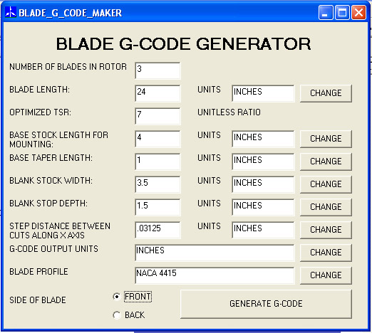

I built a basic interface to enter the parameters:
Interface to input blade parameters

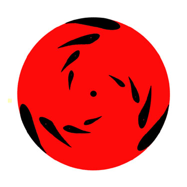

To calculate the y and z coordinates for each position out along the x axis from the center the following steps are being programed:
First I calculate the ideal chord width and the blade angle.
Next I convert the blade coordinates to polar coordinates
Then add the calculated ideal blade angle, and then convert back to rectangular coordinates.
Then I calculate the minimum x and y values, because of the profile shape for the NACA 4415, these are always less than or equal to zero.
The profile is then shifted along the x axis so that the minimal value is zero.
This is repeated along the y axis, so that not the entire profile has x and y values that are all greater than or equal to zero.
Next a check is made to see if the maximum x and y values would fall outside of the material, and if this is the case, for right now, the size is scaled such that the maximum x and y values fall on the edge of the material.  (I still plan to, and have to change this so that the angle is adjusted in the case where the material is wider along the y axis to take full advantage of that width)
Once this is scaled you have the basic profile for that position along the x axis, or station. (this is as far as I have programmed, and as mentioned above, I still have a few modifications to work in)
Now, you have to do a little math on the profile to generate the x, y, and z positions for the g-codes.  If you are machining the front, then you have to machine to a depth of the negative of the z-value, and flip the profile around on the y axis from the basic profile provided by taking the width of the stock and subtracting the y value.  For the back side, the y-axis is OK, but you have to take the stock thickness and subtract off the value of the z coordinate from the profile to come up with the depth to machine to.  Then on top of this, this takes into account no tool offset, which would be fine for round nose bits, but I intend to use regular flat bottomed end mills, so I will have to compensate for that, which may involve some more complicated calculations, depending upon whether the next station is deeper, or more shallow than the last, and the diameter of the end mill.  I have some more thinking to do on that.
For the base of the blade, I intend to taper the stock shape of the material into the first profile, and have included a variable to be entered which will indicate how steeply to do that.  basically, for each of those x-positions, it will generate the first profile, and then calculate the percentage of the depth equal to the percentage of the distance from the start of the taper to the first station.  I'm not sure how this will look, but we will see.
I also have to provide for the generation of the g-code syntax as this will generate the lines of text and add them to a text file for each x-position from the root of the blade serially out to the tip.

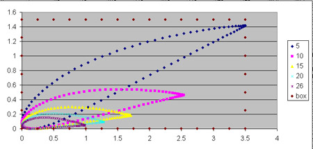

For now, I can generate the profiles only.  Here is an example of five stations exported to excell and ploted.  The series name represents the distance in inches from the center for a tsr=7 26" blade carved from a standard U.S. 2 by 4, the outline of which I added to the plot as a box.
small sample blade stations for 26 inch tsr 7 blade 3 blade rotor from a 2 by 4

If I rrecommended the 4415 it was suggesting using a thicker blade for strength.  The Blade calculator JacquesM wrote used a 4412 and I think he could change airfoils.  Personally, after a lot of research, I am beginning to think one should use the s809 or similar airfoil.
Another innovation we used was to put the Tip Speed Ratio and twist amount in slider boxes.  Using this method one can fit more 'twist' in a blank as nothing has to be normal in the blank for a CNC operation. Another observation I will make is the TSR should be considered but not be a design criteria, it should be the result of the criteria.  A small point but we are looking for design speed at wind speed.  TSR is the result.  It should not be on the front end of the equation if this is done with logic.
As mentioned, a flat bit was used for cutting.  I tend to use Her-Saf insert bits as the inserts are inexpensive and each has 4 edges. A flat bit will actually give a better surface at the same stepover as a ball-end bit on the flats and the same results at the edges.  A larger stepover will cut faster and leave a little more straightening and sanding on the leading edge for a lot less machine time.  It is not a bad trade-off, IMO.
I must qualify that I am not a programmer.  I have always drawn projects up and use CAM software to write the code.  The bit compensation and tool=path is figured in a 3D CAD program leaving only 'cut order' and jogs in the CAM protion of the programs. I have drawn up many of these little things and cut a few.  I am beginning to use larger diameter bits.  I am also using some stratigies of cutting twice, the first pass being a pass to rough and then a clean-up pass.

I was thinking of setting it up so that the airfoil could be chosen from a variety which I would store in resource files such that the program would look up the selected profile data set.  I am not familiar with the s809, but I will look at it.  The first blades I made, I started out with a 4412, but then fattened it up so that it was probably closer to a 4415 anyway.
...'Another innovation we used was to put the Tip Speed Ratio and twist amount in slider boxes.  Using this method one can fit more 'twist' in a blank as nothing has to be normal in the blank for a CNC operation. Another observation I will make is the TSR should be considered but not be a design criteria, it should be the result of the criteria.  A small point but we are looking for design speed at wind speed.  TSR is the result.  It should not be on the front end of the equation if this is done with logic.'...
I'm not sure I understand this bit.  I figured that one would have an alternater that had a specific power output to rpm curve, and that the average winds would be a certain amount, with a specific extractable energy to wind speed curve, and that one would then choose the tip speed ratio to try to maximize the power out of the alternator under those conditions such that the power out of the alternator at that rpm was just under the extractable energy from the wind for that speed.  One would thus select the tip speed ratio in the blade design as a parameter for that rpm at that wind speed.
I saw that you centered the blade section in the blank whereas I have it in lower left as you look at it, but looking at the incremental airfoil sections I don't think this makes a functional difference in the blade.  I believe you guys did that so that you could symetrically taper the blank towards the tip and save material on the laminated blanks.
Since I am kind of writing this on the fly with no cam package, I will have to program the bit compensation.  I don't have any insert type of bits, but I think the programing would be the same as for a normal flat bottomed end mill, just adjust the bit diameter, which I will have to have as a parameter.  As for making the roughing and finishing passes, I will have to think about that, I had planned to add a check loop to ensure that I did not try to cut deeper than the flutes on the endmills, but other than that I hadn't planned for a finishing pass, that would require quite a bit more programing as I would have to set up another big loop to go from the tip to the root to finish it off.  I suspect I will try it with one pass from root to tip and see how it comes out first.  That is how I set up the smaller blades I made a while back.
