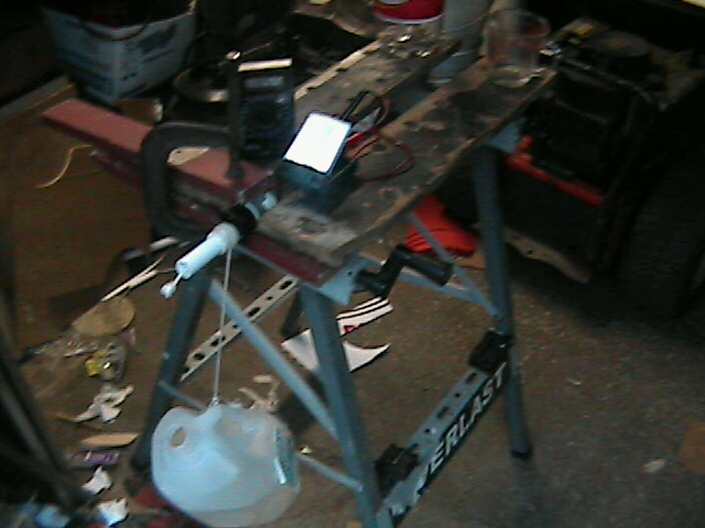

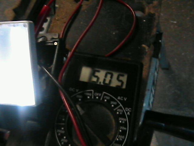

« Reply #15 on: August 13, 2005, 07:08:17 AM »
  For it's first trial run I'm hoping it will
have enough torque at 5mph wind to directly
drive that gear box end of the 'stepper'? motor
that Bruce S gave me ....which will charge a
SLA 4amp/hr battery....so that's about it for
now  that little gear box is a 100 to 1 ratio
  1. rpm is spinning the motor at 6000rpm and about
  2. -20 volts DC open voltage...quite a gutsy little thing!
                     ( :>) Norm.

Made a test very scientific 30ft.lbs/min to light 2 leds
« Last Edit: August 14, 2005, 06:36:42 PM by Norm »

Re: Buckets for Savonius
« Reply #26 on: August 14, 2005, 10:52:23 PM »
 5 pound weight turns it and moves it 1 ft in 10
seconds ...string wrapped around 1 inch shaft and
unwinding 1 ft. in 10 seconds is fast enough to
light the two leds...pics and more details
tomorrow....some real fun!
   Starting to realize how much power is stored
in 4 AA batteries....amazing!
              ( :>) Norm.

« Reply #28 on: August 15, 2005, 05:47:44 AM »
  Well here's some more detail about the test...
 BR>
 I took a short length of tubing and stuck it over the gear, wrapped some nylon string around
this makeshift drum and hooked the end of it to
a milk jug handle and after filling it with
enough water so the weight is just enough to
unwind at a rate just fast enough to light the
leds at a brilliance equivalent to about the 4
AA batteries would have been (80 fluid oz.)which
I figured was a 5lbs. , as the weight descended
and lit the LEDs I counted 10 seconds for the
weight to descend 1 ft. so 30 ft.lbs a minute.
so the jug would travel 360 ft. in 1 hr. or 2880
ft. in 8 hrs.
   Hmmm.  so much for now.....
