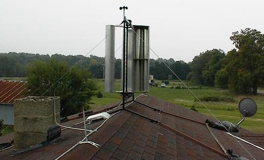

  I mounted the Lenz turbine on the roof as a test bed a couple days ago.  I've yet to see it stop turning.  Today there was a defining calm, I checked both my anemometers and both read 0.0 mph.  I went out to start another project and happened to glance up at it and it was still spinning.  Here is a video of the unit in wmv format... it's about 15 seconds long and about 475kb download.  Take note of the anemometer on the upper right hand corner of the turbine... if you watch real close you can almost see it move.
http://www.otherpower.com/images/scimages/15/Lenz_Turbine_low_wind.wmv
The best I've seen with it so far is 7 amps in a 15 mph wind.  With the seasons changing the winds should be kicking up a bit shortly.   It's going to be fun to see what it will really do on a windy day.

Re: Lenz turbine - Little to no noticable wind
« Reply #2 on: September 27, 2005, 06:32:38 PM »
hey ed! thats a very efficient machine!  the roof might be giving you a boost.
« Reply #4 on: September 27, 2005, 06:52:45 PM »
  I'm sure I was getting something in the range of a 2mph turbulance across the roof.  It was running at about 28 rpm in the video.  I highly doubt it was making any collectable power, most likely just enough to overcome the bearing friction.

MountainMan
  • Posts: 138
« Reply #6 on: September 27, 2005, 07:56:50 PM »
Ed,
Very cool.  Looking forward to see what sort of wattage you get from a genny of this size.  What sort of alternator are you using on it?
BTW, what is the strange thing on the roof to the left of the genny?  Kinda looks l ike you roped a baby seal and tossed it up on the roof!  Seems like the head is still moving.  Best be careful, it might attract some roof sharks.
Interesting that this contraption does not have the usual top and bottom "disks" that are typical of non-daerieus VAWTS.  Is that a trait of Lenz designs, or just your own special implementation?  If the latter, did you compare with and without "disks" with the same "cup" design?  Just wondering what part those pieces play from an aerodynamic rather than construction standpoint.
Any chance we could get you to try some shading experiments with this at some point?  Unless the "returning" cup is somehow providing a little bit of a lift vector due to its shape, I would think that shading it would create a significant boost in efficiency.  Seems like it would be fighting its way back upstream without shading it.  Myself and others have mentioned this before and some guys have shown plans for how to build a shade with a tail that points it properly.  Don't think anybody has actually shown results from such a thing though.  Perhaps shading would add just enough efficiency to give us VAWT proponents some bragging rights!
BTW, your "accessible shaft above and below" design would lend itself very nicely to the installation of a self pointing shade.  One could even imagine some changes to the shade's tail assembly that would make the shade double as a furling mechanism in high winds.
« Reply #7 on: September 27, 2005, 08:11:51 PM »
  MountainMan,
   The Lenz turbine uses a combination of lift and drag.  I posted a video a few weeks back of a test machine with one wing on it, starting from the back side of the machine the wing flies into the wing and back around again.  I experimented with diffusers or "shading" and it takes away from the output considerably.
   Here is the link to the single wing video, its about 1mb in mpeg format.  I'm still learing how to make these things smaller...
http://www.otherpower.com/images/scimages/15/upwind_wing.mpg
   All 3 blades play a part in extracting energy.
« Last Edit: September 27, 2005, 08:11:51 PM by windstuffnow »
BoneHead
  • Posts: 34
« Reply #8 on: September 27, 2005, 08:47:52 PM »
Oh WOW man. I had it all backwards! That's great!
I guess I'm a little think around the cranium. I thought the rounded ends were the ends that the wind pushed and the open side was on the inside with the bladed end cutting back on the return. I'm sorry, I had it all wrong. Just forget I asked half of those questions on the other thread. They just don't apply.
That's an awesome design. Congrats. I see how that shape will limit top speed but with a multi-stator low rpm alt, that things gonna rule. You should try and market that thing when you refine it. Be a nice way to pay the bills.
I can't get over that. It's a great idea. Without that movie, I would still be trying to figure out why you did things that you didn't actually do...lol. Good luck on that Ed!
« Reply #13 on: September 28, 2005, 11:53:51 AM »
  Hi electron,
   I haven't heard any vibration through the roof so far.  You can, however, hear a very low grumble or humm when the unit is charging from the alternator.  You have to listen carefully for it.
   Personally I wouldn't recommend anyone putting a turbine on their roof.   This is simply a quick ( inexpensive ) test bed for my turbine.  The turbine isn't in any way bolted to the roof, it's simply sitting on the roof.
   Sounds a bit scarry I know.   Simply a steel tube frame, held in place by sand bags and cables... photo below...
   There is 80 lbs of sand on each of 4 legs and the legs are 8 1/2 ft long, the unit stands 5 ft off the peak.  Lots of room for turbulance in its location.  Definately not an optimum test location.

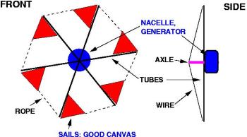

concerning portable wind machines,
have you seen this site:
http://www.shield.fi/turbine.html
You might also consider
a sail type HAWT.
I've heard about one guy, who has made
something like the above sail machine
as portable.
