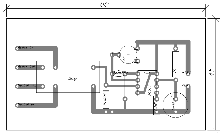

I've been wanting to try out the "chest-freezer-as-a-refrigerator concept for a while now, and as you might have read here I've made the first steps towards it, and made sure that the old clunker freezer that I've got actually works.

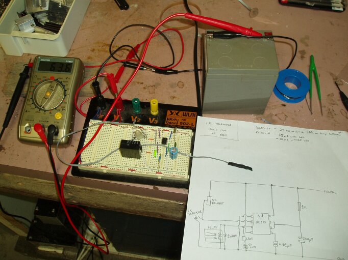

Now that I've constructed a watt-hour meter, I'm ready to go with an actual thermostatically-controlled version.  My combination of tightwadedness and wanting to build something myself led me to this prototype:
It's essentially a 555 timer driving a relay, with the trigger voltage set by a 1K thermistor and a 5K pot in a voltage divider network.  Using the 555 timer with an appropriately sized capacitor and resistor allows you to set the minimum length of time that the fridge should switch on for (or hysteresis, for the technical).  I also happened to have one in my junk box, along with the various other parts.  The relay came from a discarded CRT computer monitor, and dictated the use of 12V for the circuit (it won't trigger on any lower voltage).
Here's the draft PCB layout:
I'll try this out in the next few days, and let you know how/if it works.  Needless to say, it'll be placed in a well-insulated box before it gets connected to the mains.
BTH

FYI, the schematic would be much more useful than the PCB layout. It seems like a straightforward design, from the quick glance I took.
You may be interested to know the the CMOS 7555 draws only .1mA of current, while the ordinary one (in my case) draws 13mA. This may be an issue for a RE application, esp. if the thermostat-circuit is working 24/7, as is probably the case.
I suppose you know that the 555 can source up to 200mA? This means you can drive pretty big relays (though myself, I'd add an extra MOSFET stage)
I like that box of aluminium heatsinks, guess I'm not the only one who's saving them :)
Looking forward on hearing your experiences on converting the freezer to fridge, I'm playing around with the idea myself.
You can see the schematic on the piece of paper to the lower right... ;-)
Yup, and version #2 will be using the CMOS chip and a 10K thermistor to save power (this setup draws 25mA in idle mode, and 50mA with the relay switched on).  I'm using a TTL one in the prototype because I had it on hand.
That was the other reason for using the TTL version in the prototype - the CMOS version will only source about 25mA or so, if I recall correctly.

By the way, there was an error in that PCB overlay:  pins 5 and 6 on the 555 shouldn't have been bridged.
