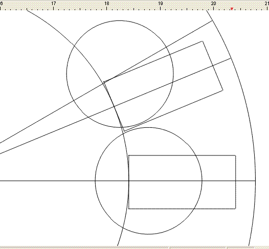

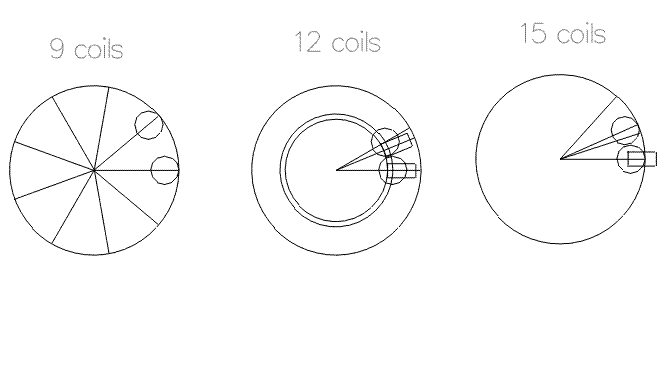

« Reply #3 on: February 03, 2006, 11:02:15 AM »
all outer dia. are equal.. 12"
i'm not suggesting that you use round coils , it is just a way for me to check the dimentions..
the smaller circles are 2'dia. ( twice the width of magnets)
the 9 coil setup shows that there is way too much room on a 12" rotor disk.
the 15 coil shows there not enough room on a 12" disk to hold 15 coils..(20 poles)
the 12 coil seems ok..thats 16 poles 32 magnets..
hope you have that many :-) ?
you should REALLY DL this program .. its free !!
i could help ya get started with it..
http://www.otherpower.com/images/scimages/2965/tinker.GIF
« Last Edit: February 03, 2006, 11:02:15 AM by willib »

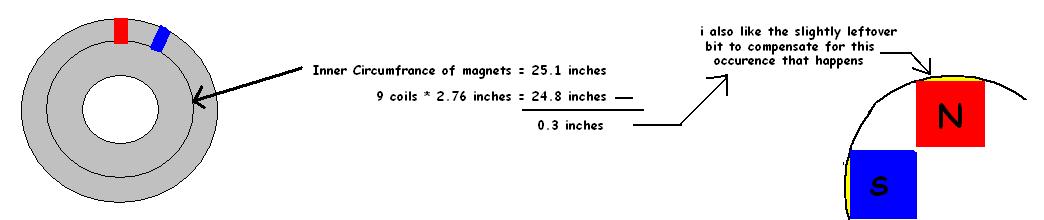

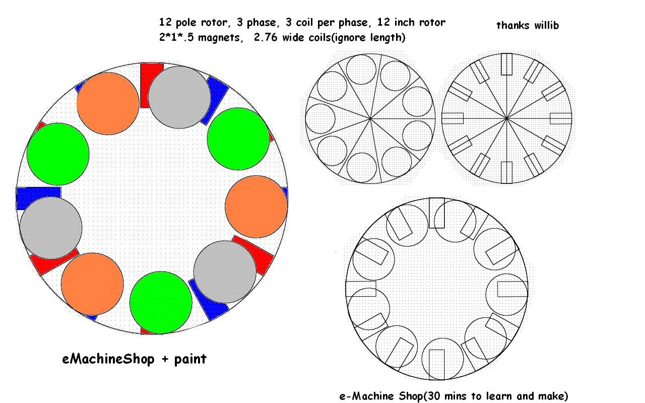

« Reply #4 on: February 03, 2006, 03:50:27 PM »
i would really like to make sumthing like that, paint is great for everything except measurements :)
i was thinking coils of 2.76 inches wide and that covers a leg over each pole and gives just about 100% of the space for copper.
there is just over 1 inch width between each magnet at the inner circumfrance so this fits the 1 inch core here and leaves just the legs over the poles (in theory heh), i would like to model this on ur program so let me know the name and i would be grateful. that would let me see if my thinking in correct.
Ray

« Reply #6 on: February 03, 2006, 04:24:25 PM »
can yo go  with 16 poles ? is that a do-able option?
 i would recommend it .
 the distance between the inside corners will be 0.460 " which is fine in my opinion..
http://www.otherpower.com/images/scimages/2965/0tinker.GIF

« Reply #7 on: February 03, 2006, 05:09:30 PM »
ill have to have a think about it,ill get back to it tomoro(exhasted atm) , haven purchased the magnets yet , building my  set up first :)
that program is brilliant willib, only took a little while to use and produced these results brilliantly :) no more set sqaures and pencils for me :)
thanks so much for the recommendation. the options are so made for this :)

« Reply #8 on: February 03, 2006, 05:10:41 PM »
i must say that does make it more clear than my excel spread sheets lol :)

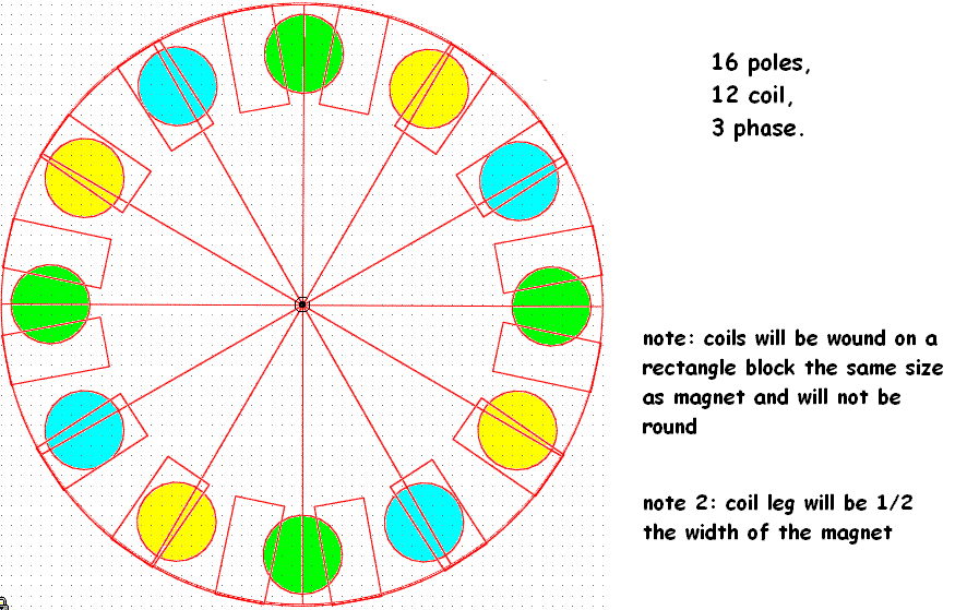

« Reply #10 on: February 04, 2006, 07:00:22 AM »
if i make it 16 magnets and 12 coils, i get the spacing to be 0.57 "
(25.13(inner circumfrance) minus  16(1 inch per magnet) )/16(number of spaces)= 0.57 inches?
i would be using a coil leg of 0.53 with 12 coils instead of 9.
do u think the 4 extra poles would give more power then having that 0.88 inch legs as up above?  i suppose the voltage would be about 1/4 higher aswell which is a large boost with such a small machine, and been single rotor that would be most welcome :)
(im going to model it on the program :) lol. cheers)

« Reply #11 on: February 04, 2006, 08:27:21 AM »
heres the model.
if u think a good idea is that the coil leg should be equal to half the magnet width then this does look much better. if ya think this is ok then i will go for this one, the measurments do look good.
coil leg = 0.53 inches
click me
12 inch, 16 pole, 12 coil, 3 phase model
« Last Edit: February 04, 2006, 08:27:21 AM by theTinker »

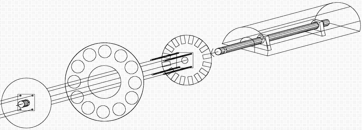

« Reply #12 on: February 04, 2006, 06:57:16 PM »
my next design issue is about bearings and support.
Im building the frame out of wood as I have a ready supply and the tools.
in DanBs woodenAXL gen, he used 2 pillow blocks to support the shaft and the rotor was welded to the shaft which when turn obviously spun the shaft in the pillow block bearings too.
I see another way of doing this would be to support the shaft securely on the frame, and attach in the rotor "hole" a radial ball bearing which then is put on the shaft, so really its a question of whether the shaft and rotor should turn or just the rotor.
I figure the second one just has the friction on one bearing? while dans had the friction of 2, im aiming for low winds so im trying to reduce energy lost. but is there any advantage of using the 2 pillow blocks bearings? does it lessen the load put on each bearing so they should last twice as long maybe?

http://www.otherpower.com/images/pmg17.jpg
If you can use a tapered roller bearing , that is an option for sure.I'm not sure how strong that would be ,because with wood as the frame , the tapered bearing needs tension , and the wood may not be able to supply that tension for very long
It is commonly done with a hub and spindle assembly maybe you could scrounge one up somewhere ?
an old trailer ?
an old front wheel drive car?
it would make thing so much easier.
If you are going to use wood for a frame i would use the double pillow block ,because of the forces involved .which means your shaft and rotor will be spinning. You are going to need a flange of some sort to attach the rotor to the shaft.
i wouldnt worry about the friction of another ball bearing on there
« Last Edit: February 05, 2006, 09:29:09 PM by willib »

i looked into the spindle and bearings from the wheels of a trailer, but i found that the spindles are very little sticking out the back, and on a wooden frame i would need quite a bit to support it.
heres my idea below, its very much like one of dans.
heres a emachine file of it.
click me
it seem fair enough?
« Last Edit: February 06, 2006, 02:26:41 PM by theTinker »

Re: Third Turbine work
« Reply #16 on: February 06, 2006, 05:40:13 PM »
Nice job !!! you are very good  at this program <;) , that drawing is really something..
i downloaded the file , emachineshop poped up , with the file loaded , it worked great..
« Last Edit: February 06, 2006, 05:40:13 PM by willib »
« Reply #17 on: February 06, 2006, 05:58:49 PM »
two of those  shaft collers could be welded to JUST "ONE" rotor , not to the shaft , because you may want to take it apart in the future,and let the other rotor float on the shaft being held in place by the shaft .
if you know someone who has a welder?
and then just attach your prop to the outer rotor , centering it on the shaft..
« Last Edit: February 06, 2006, 05:58:49 PM by willib »
