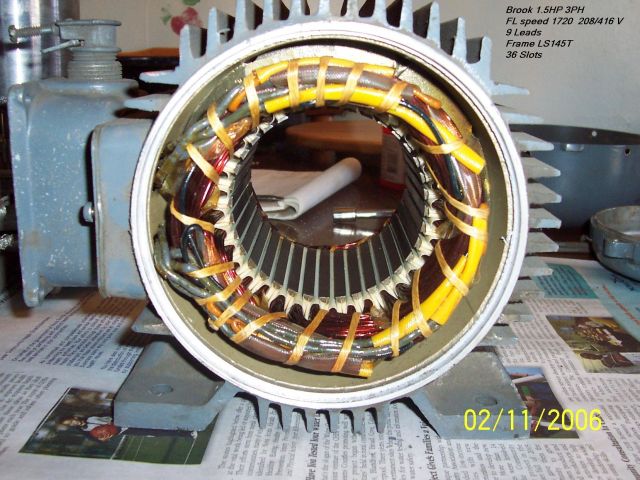

Well I has been a while sense I updated this project thread so I thought I would let you know there has been some progress.  I mentioned an old air compressor that I wanted the flywheel for this VAWT project which is actually just part of a larger combined project.  I got it and the motor that it was attached to and the info on it is in the Rescue Mission thread.  The VAWT design might be changing because of a number of things  one of them is the size of the flywheel and rotor from the compressor motor They are huge.  The size of the flywheel will determine the size of the hydraulic motor and everything else including the final design of my wind mill which is still changing.  Now I have a solid place to start finalizing all the other little things that have until now been floating unknowns to a very big puzzle.
George
Ps: I also learned the right way to spell VAWT but still do not know how to edit old posts for errors.
