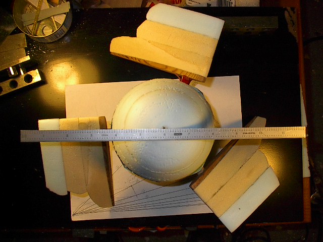

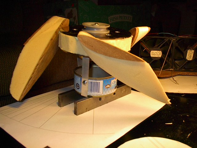

I started over with three new blades this time.it helped a lot to have the other one as a reference.
i took them for a spin in front of a fan , it was soo cool , i think i'll put a spinner on there to see if it helps at the root.
only 90% to go !
http://www.otherpower.com/images/scimages/2965/IM001497.JPG  85KB
http://www.otherpower.com/images/scimages/2965/IM001498.JPG  95KB
http://www.otherpower.com/images/scimages/2965/IM001499.JPG  80KB
the funny thing was, i had them at the same angle on the first trial, but with the
wrong side facing into the wind, if ya know what i mean , they spun a lot faster that way , wonder what that means?

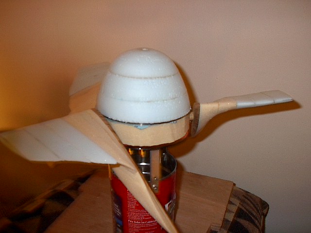

« Reply #1 on: February 21, 2006, 08:06:47 PM »

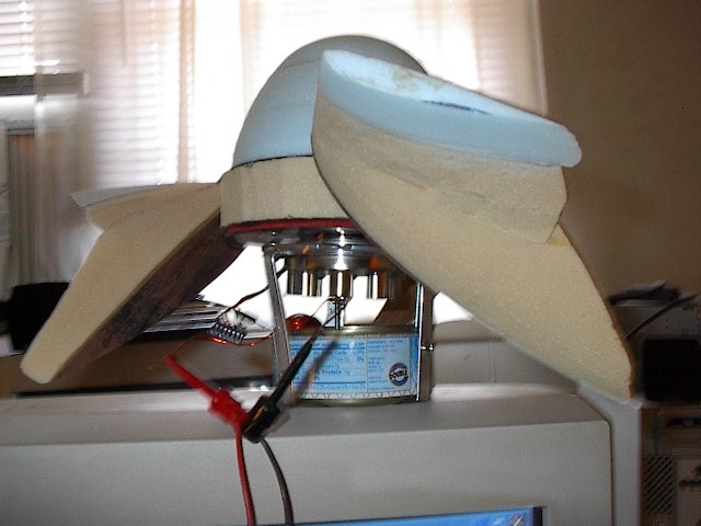

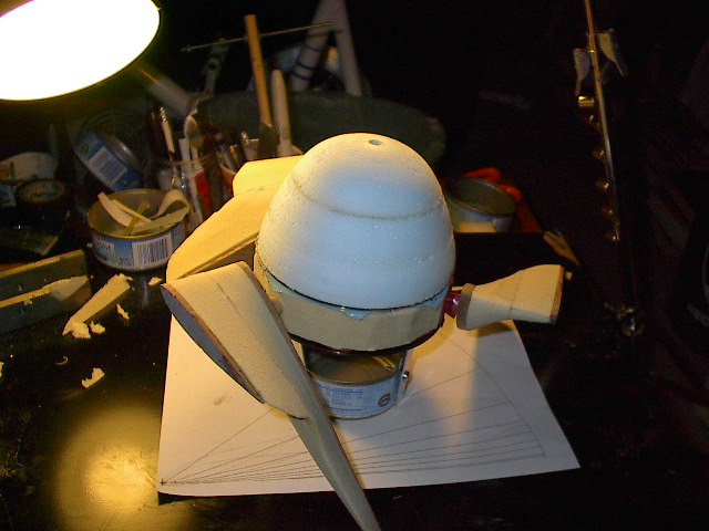

I made a spinner out of blue foam
http://www.otherpower.com/images/scimages/2965/IM001505.JPG 75KB
http://www.otherpower.com/images/scimages/2965/IM001501.JPG 80KB
Below ,this looks VERY promising..
it is the blue styrofoam with enamel paint on it.
i hope that when i test this piece with glass & resin , the resin wont eat the blue styrofoam
http://www.otherpower.com/images/scimages/2965/IM001506.JPG 68KB
so far the enamel paint is fine with the foam

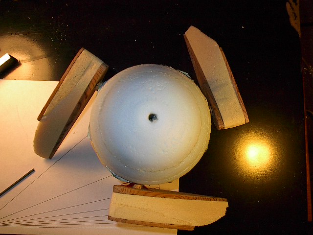

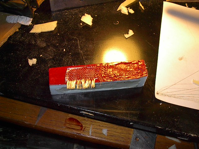

I got another section on
below is the upwind view
http://www.otherpower.com/images/scimages/2965/IM001509.JPG 71KB
side view
http://www.otherpower.com/images/scimages/2965/IM001511.JPG 72KB
below is the blue foam with two different patches of glass , the left one hardly sunk in at all , the right one bubbled up then sunk in. lol, i was thinking of using the polycrylic over the enamel paint , i guess thats next.
http://www.otherpower.com/images/scimages/2965/IM001514.JPG 109KB
« Last Edit: February 22, 2006, 08:24:45 PM by willib »

Re: 9 " blades
« Reply #4 on: February 23, 2006, 01:57:47 AM »
Somone else mentioned that before , epoxy doesnt eat polystyrene? that wierd , i'll have to try some ..
yeah , i would really like to use the blue foam on the blades , it carves like butter , and sands beautifully! and is  non toxic , but it dissolves in Resin :(
i just looked it up ,the main ingrediant in Bondo all purpose fiberglass resin is styrene.. no wonder it dissolves polystyrene.
« Last Edit: February 23, 2006, 01:57:47 AM by willib »

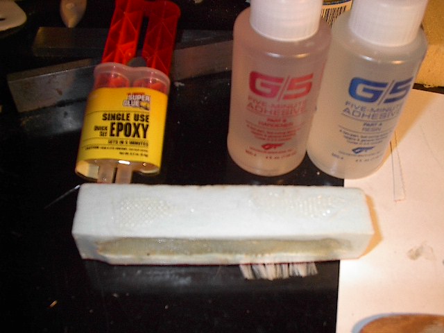

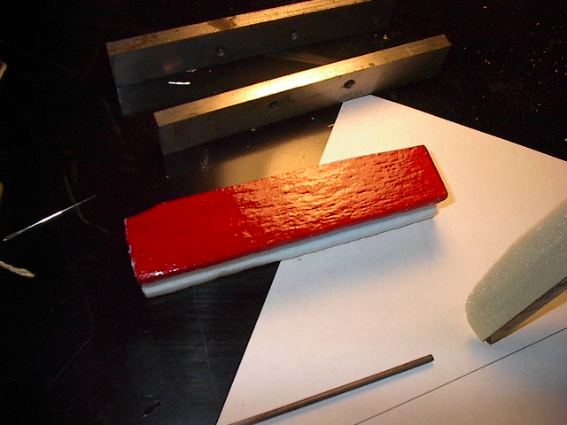

Re: 9 " blades
« Reply #5 on: February 23, 2006, 05:30:57 PM »
Ok it took a while but it FINALLY sunk in USE EPOXY on styrofoam...!!
i got some today and it is allready hard ( 5 min)
no bubbling no dissolving what so ever.. yay
 i went to the dollar store and tried their epoxy , also tried West Systems epoxy, they both worked flawlessly..
below is the dollar store " superGlue brand on the left .
west systems G5 five min. epoxy on the right .
not the front , btw, the front was an earlier test with polyester resin.

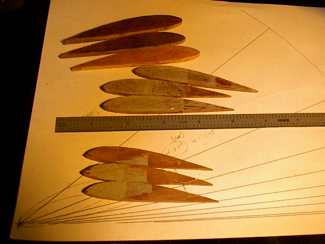

These are some of the airfoils i used on the blades..only takes ten min. each to cut them out

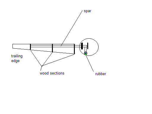

« Reply #6 on: February 23, 2006, 09:17:59 PM »
Are those dowels you're using to connect your bades to the hub? I'm thinking that would be the perfect way to set up and test blade angles...maybe someone could come up with a simple centrifugal device to change the angle according to rpm's; feathering. I was leaning toward using a composite hockey stick as a spar and hub connecting point for my foam blades but I think round is better now! Like you i'm going to be cutting wood airfoil sections to secure the spar to. So far i have two beautiful blue 3' carved and sanded blades waiting to be cut into pieces to accept the wooden sections and spar. Thanks for posting your results.
« Last Edit: February 23, 2006, 09:17:59 PM by pickerol »

Yes they are dowels , if you look in my diaries you will see one titled "pitch control diagram"
i havnt built it yet but thats after the blades i suppose, i've allready decided to use bicycle bearing hubs ( front ) as the bearing pivots..
« Last Edit: February 23, 2006, 10:42:27 PM by willib »

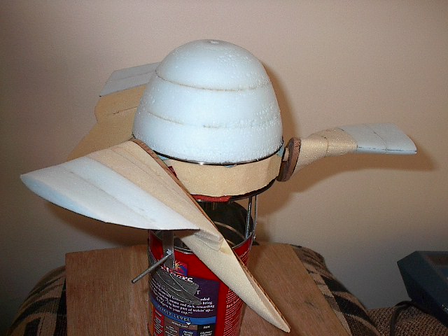

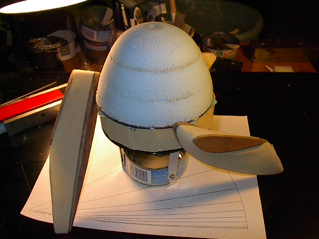

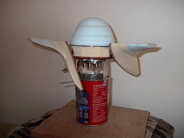

Re: 9 " blades
« Reply #15 on: February 24, 2006, 02:05:50 AM »
getting there ...
Notice the blue foam on the ends i used epoxy to attach them.
i'm so dense sometimes , epoxy was recommended weeks ago by several people , i cant believe it took me this long to try it!!
http://www.otherpower.com/images/scimages/2965/IM001527.JPG 82KB
they are allready as large in dia. as my test fan,  12 in.
http://www.otherpower.com/images/scimages/2965/IM001528.JPG 90KB
i guess i'm gonna have to rename the thread to 26" dia blades..  i didnt take the hub into account  ..
« Last Edit: February 24, 2006, 02:05:50 AM by willib »

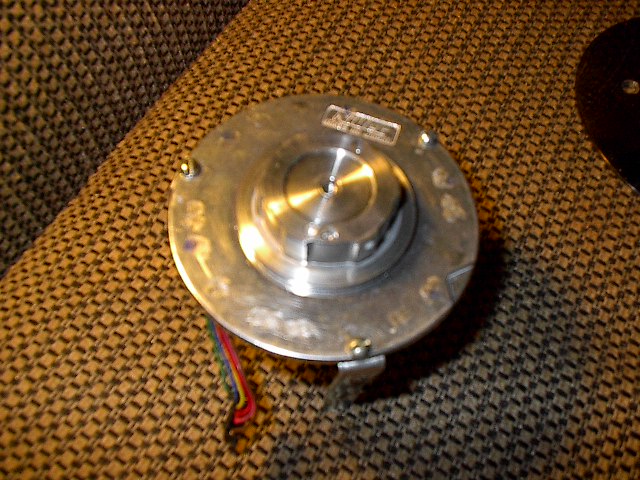

Micro Gen from a HD motor !!
« Reply #16 on: February 24, 2006, 12:45:49 PM »

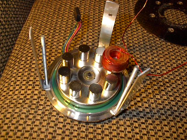

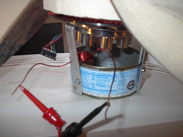

can you say Micro Gen ?
Ghurd will like this
i put a test coil in front of the magnets , just holding it there .
turned on the fan , at 250 rpm  i got a whooping 0.2V peak , in all fairness the gage is way too big (at #17 ) , for such a small generator , but i had the coil on hand so i tried it..
# 20 gage should do nicely.
those magnets below the bearing , are dans 1/2" dia by 1/2" which i ordered a long time ago..
wait till you see what i have planned for this little baby!
a dual rotor three phase six coil eight pole wind machine , which i plan on putting out on the window sill..
http://www.otherpower.com/images/scimages/2965/IM001529.JPG 67KB

« Reply #18 on: February 25, 2006, 01:00:48 PM »
I knew you would like it , it is from 5.25" HD .
it has everything one would want , the metal flywheel on the back where the magnets are attached is a little less than 2.7" in dia . perfect for eight 1/2" dia magnets.., actually 2.5" dia is all you really need for eight 1/2"dia. magnets
because they are centered on a 2" dia circle..
with six  1" dia coils of course,with  1/2" holes and you're good to go..!!
It has three mounting holes , to mount the stator onto .. some have four..
« Last Edit: February 25, 2006, 01:00:48 PM by willib »

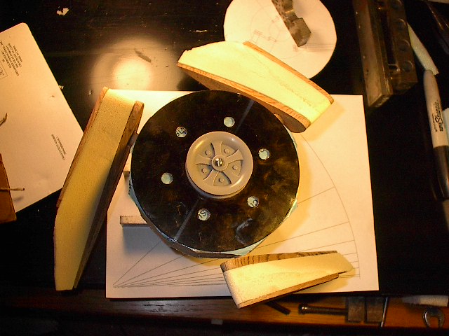

Re: Micro Gen from a HD motor !!
« Reply #20 on: February 25, 2006, 04:40:10 PM »
yes it came with the HD..
the platters are aluminum
this is the back of the HD motor.
minus the magnets & coil , lol..
this is the top wher the plattens go.and i've used the plattens to hold the blades in place, all you need is a longer screw, you can even use the origional platten top plate..
« Last Edit: February 25, 2006, 04:40:10 PM by willib »

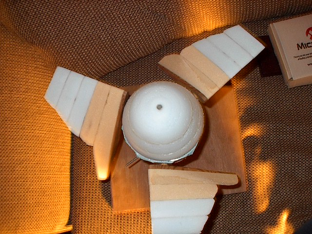

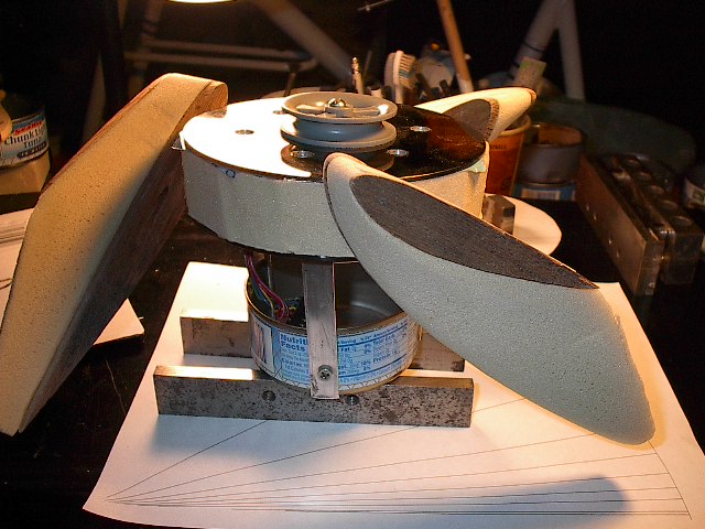

Re: 9 " blades
« Reply #21 on: February 25, 2006, 10:33:35 PM »

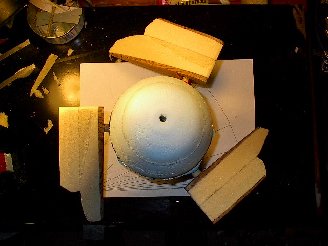

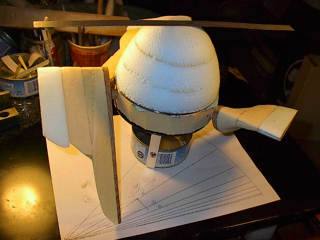

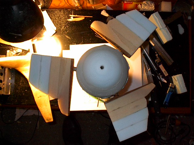

some more pics of my progress
below is two blue foam sections added
http://www.otherpower.com/images/scimages/2965/IM001538.JPG 87KB
side view
http://www.otherpower.com/images/scimages/2965/IM001539.JPG 71KB
below shows the whole  microgen
http://www.otherpower.com/images/scimages/2965/IM001541.JPG 62KB
below is where i am now with three blue foam sections added , five total.
http://www.otherpower.com/images/scimages/2965/IM001549.JPG 58KB
top view.
http://www.otherpower.com/images/scimages/2965/IM001551.JPG 131 KB
« Last Edit: February 25, 2006, 10:33:35 PM by willib »

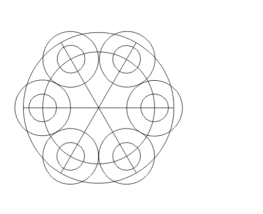

here is the coil layout the i am using
the coils are 1" dia. and are centered on a 2" circle , or a tad over..  2.01" to be exact..
http://www.otherpower.com/images/scimages/2965/microgen.GIF 9KB

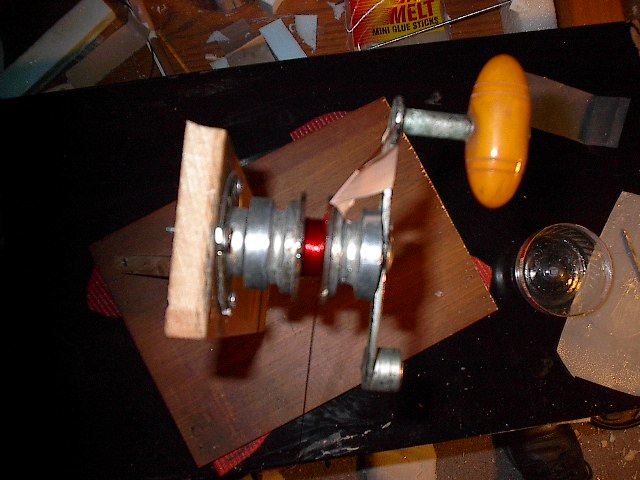

just wound a 1" dia coil , with #10 gauge ,
kidding ..
it is really #20 ..
