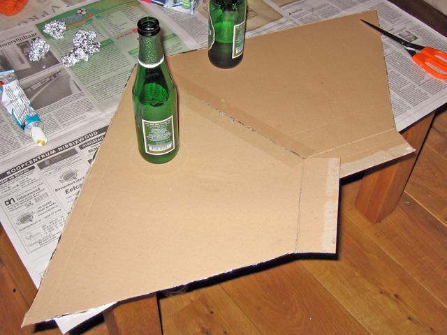

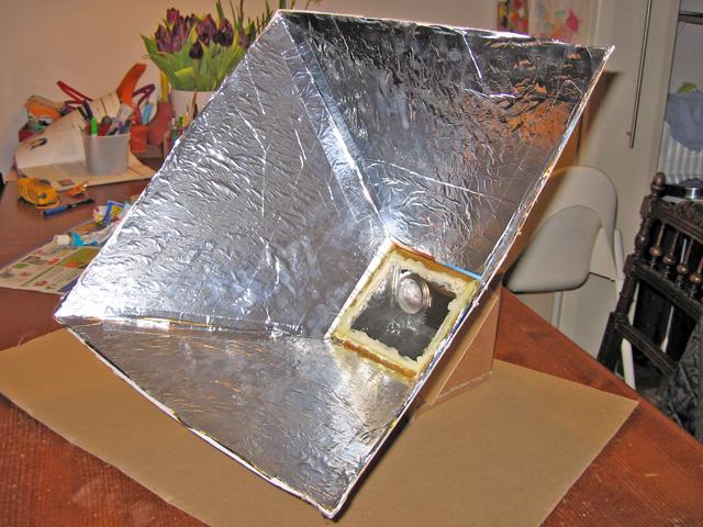

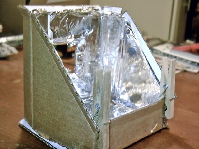

The idea was to attach a peltier element to a solar box cooker and use the temperature difference to generate electricity. The heat storage is supposed to elegantly deal with intermittent sunlight, as opposed to PV cells, that immediately drop to near zero juice as soon as a cloud moves before the sun.

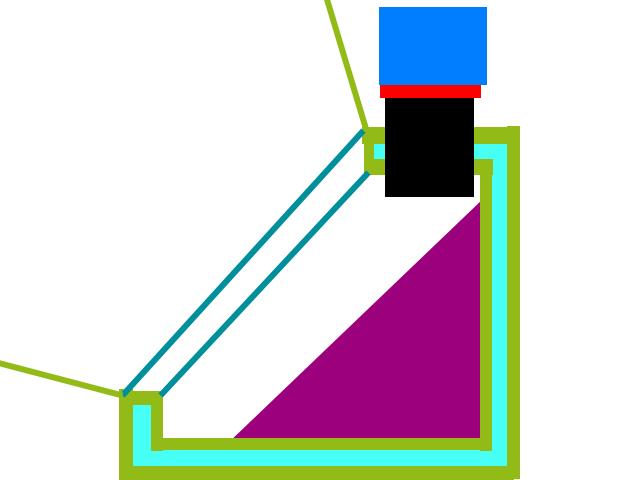

This is the design. The sunlight heats the heat storage. Hot air is transported out of the 'greenhouse' by the heat sink through the peltier into the waterreservoir. The seebeck effect will cause the peltier to output electricity.

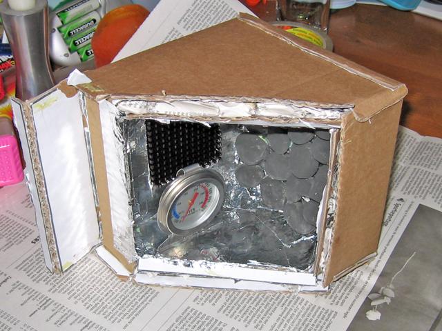

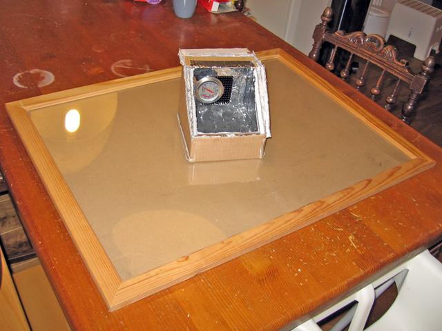

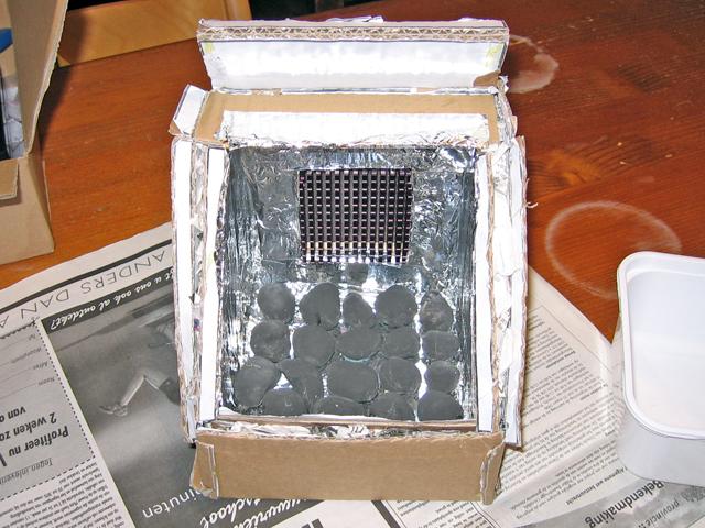

Here's the inner box, created from cardboard, glue and aluminum foil.

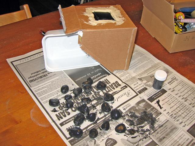

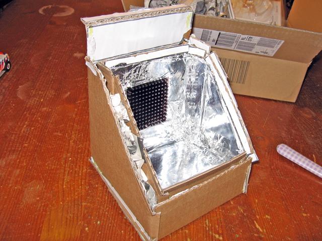

These are the inner and outer box, insulated with pieces of newspaper. The heatsink I took from an old PC, is glued in place.

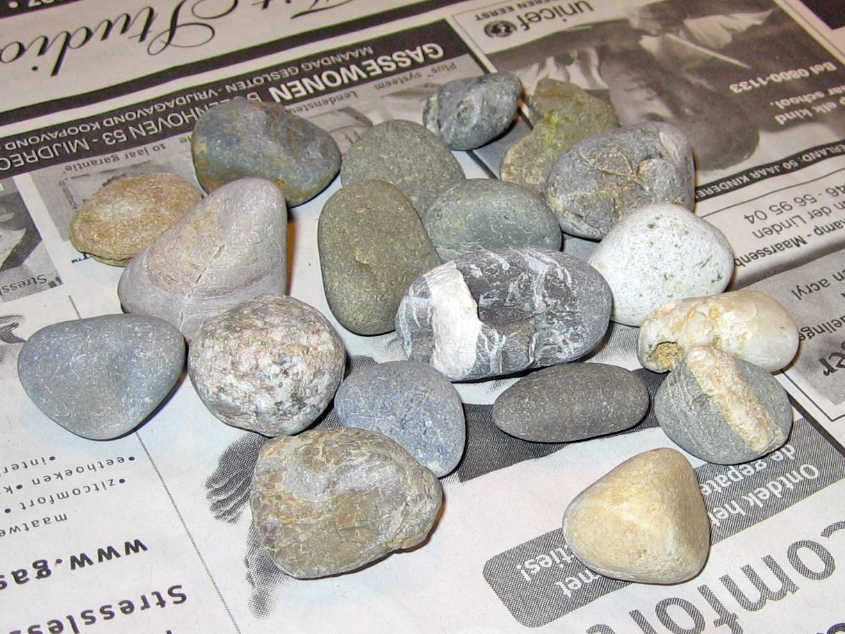

These pebbles will be the heat storage.
The pebbles are painted black, to get more heat from the sunlight.

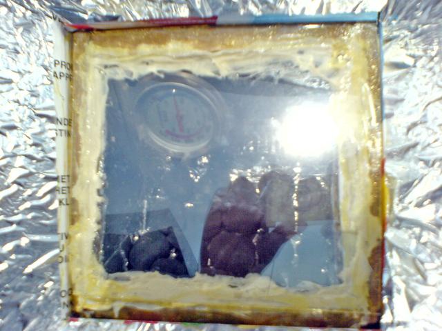

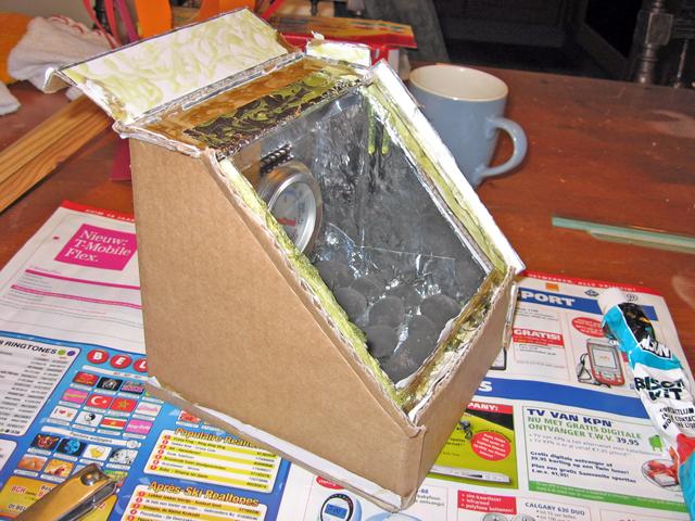

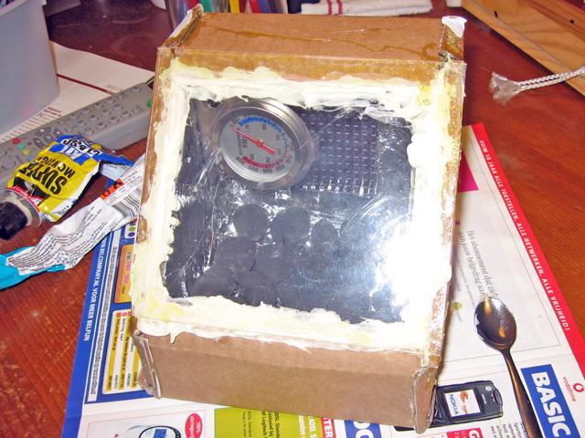

Pebbles glued into the SBC.
Added a thermometer to the SBC. It takes away some sunlight from the heat sink, but that's okay. The heatsink is not supposed to directly generate heat anyway.

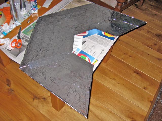

Two of the reflectors.
All four of the reflectors, covered with aluminum foil.

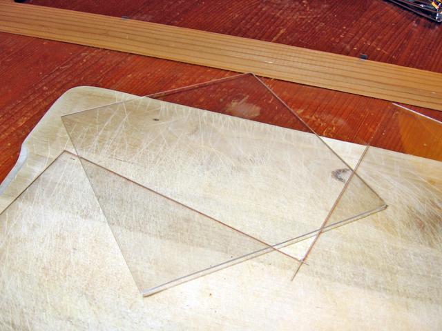

The picture frame I sacrificed to get the plexiglass windows.
One of the plexiglass windows.
First window glued in place.
Both windows in place.
Glued the reflectors to the box.

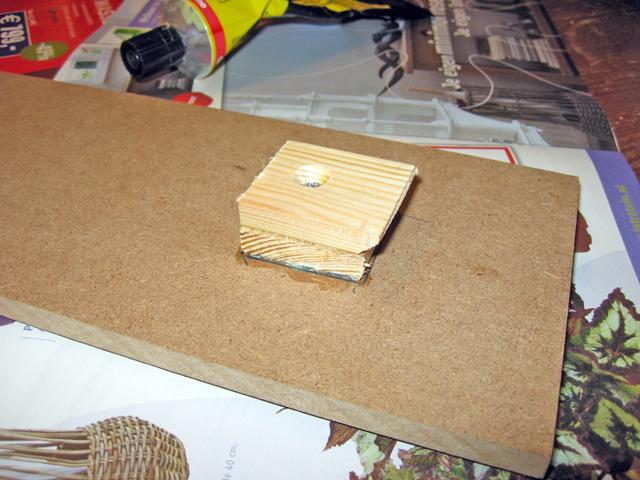

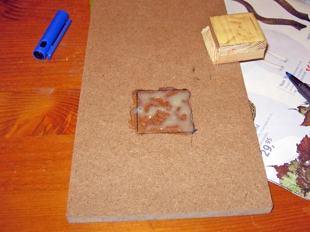

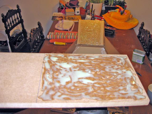

The piece of MDF is going to be the bottom plate, the little pieces of wood will be an adapter to make the solar cell tripod mountable.

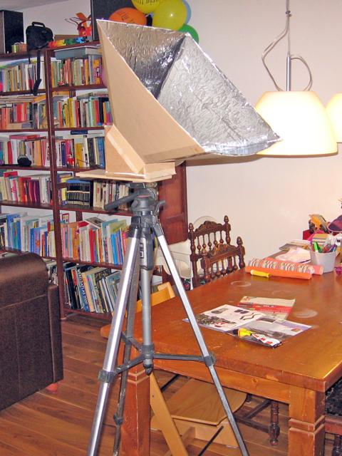

Glued the tripod adapter to the bottom plate.

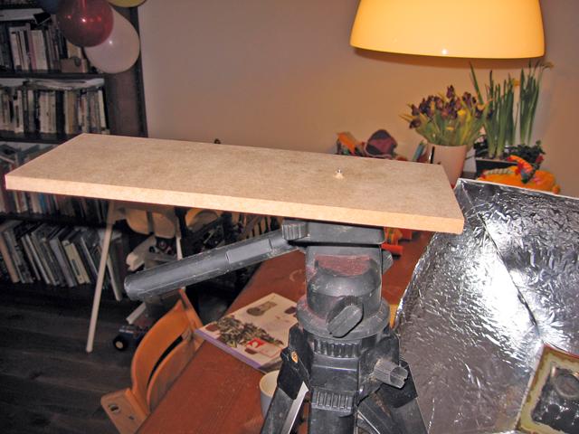

Bottom plate mounted on tripod, for easy 'manual solar tracking'.
About to glue the SBC to the bottom plate.

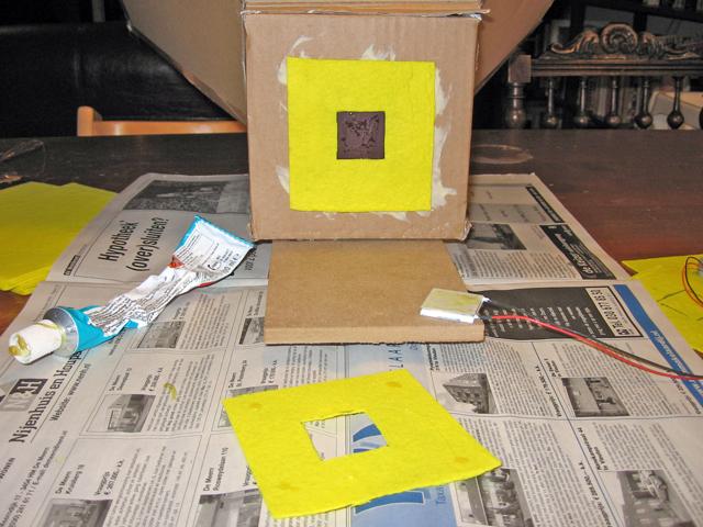

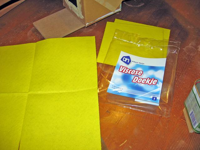

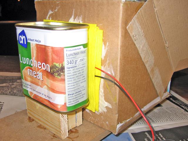

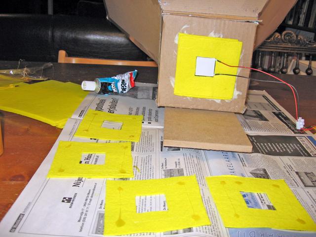

Some cleaning cloths, for insulation between the heat sink, the peltier and the cooler.
a few layers of insulation...
...then the peltier...
...and some more layers of cloth. An empty spam can is glued to the peltier and we're done!
Okay, now let's get this thing in action and rid the world of fossil fuels! 8)
Unfortunately, I live in the Netherlands, the weather usually pretty much sucks here. Also, I'm at about 52 degrees North and it's winter here, so the sun isn't all that powerful right now. Still we saw some nice weather on the 23rd and 24th of februari so I was able to test the thing.
Here's me, testing the solar cell at the office. The office has double glazing, so that may have cost me 10% of the sunlight. Still the thing got pretty hot...

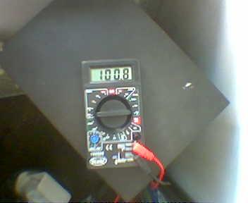

Unfortunately it wasn't a big success. The SBC worked fine and got to 70 degrees celcius (158F) on thursday and to 92 degrees celcius on friday (about 198F). The electricity output however was not very useful. We got to 0.082 volt at 0.023 ampere. Even when I cheated, by filling the cooler with ice cubes and cold water I only got 0.17 volt at 0.047 ampere.
Here's the solar cell at 70 degrees celcius.
(This is where it passes the 0.1 volt, after I cheated by filling the cooler with ice cubes.)
I'm not sure what went wrong. I had tested the peltier with two cups of hot and cold water and it performed al least ten times better then. Maybe the heat sink isn't that effective, or maybe the glue on the peltier is a bad heat conductor. I don't know. I might build an improved version some day, using some special heat conducting glue.

  • My reflectors suck. A test with a laser showed that about half the sunlight bounces to the opposite reflector and back to the sun... Calculate the angles instead of guessing them like I did.
  • My heat sink was bigger than the peltier. That may have cost me a heat. Next time I'll make sure the heat sink and the peltier are the same size.
  • It's pretty stupid to have the heatsink at the back of the SBC, instead of in the ceiling, as the hot air is supposed to go up. (see improved design below).
  • It's also pretty stupid to have the heat storage horizontal, instead of at a straight angle with the sunlight. (see improved design below)

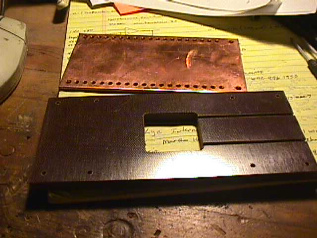

I did this experiment 10 or 12 years ago. I have some notes that might help. First, using a PED instead of a Seebeck device is an uphill battle. A PED is optimized to move heat. What you have built is a good hotbox, could be used to capture low level heat and move it indoors. What you need is a focal point box, to focus the heat onto a small area and place your input heat sink there.
  Something like this only not as battered. Or better yet, a spun mylar reflector from an old traffic signal head. The heat sink should be small and copper. Copper transfers heat about 60% better than aluminum. Center the heat sink in the focal area. To insulate the PED and provide support, something like micarta or Dupont vespel SP-1 should be used. Either will give good insulation and mechanical support. I use sil-gap 2000 (from Bergquist) instead of thermal compound, it provides 5 times the heat transfer. Don't forget to use nylon 66 fiber filled or vespel screws to capture the PED between the heat sinks, regular nylon screws will powder out in just a few days from the heat. A precise fit from heat sink to insulation to heat sink is critical.
  I machined my insulation to hold the PED centered and to feed the wires out. Use belleville washers to hold the proper tension, with the device heating and cooling and expanding and contracting it is easy to break something without them. For the back heat sink, copper with plenty of rib area is nice. Be sure to allow for plenty of air flow and have at least 5 times the back heat sink area as the inner one. A small fan will probably be required to maintain the temperature differential needed to make it all work. Carefully done, you can see several hundred degrees differential across the device, and I was able to get about 6 watts from a 40 watt PED. Of course this thing went on to become a cooler for a CCD imager mounted 90 feet in the air, it would have been far to expensive to make to really generate any usable voltage from it.

Sorry, Did not mean to be speaking Ferengi when the official language here is Klingon. PED or Peltier Effect Device rather than SD or Seebeck Device. A PED is made up of mostly BiTe, or bismuth telluride, while a SD is mostly PbTe or SiGe - lead telluride or silicon germanium. Melcor in New Jersey makes and carries a good line. The difference can be a lot, I was able to get almost 38 watts from a 40 watt SD, against the 6 or so I got from the PED. And tracking is a given, without tracking the output falls off very quickly. As I said, your money would be better spent on making a low level hot box, moving heat from the sun indoors in the winter. The best use I have found for large PEDs is as dump loads, with a simple relay reversal they can either heat or cool the battery house, but you need really large heat sinks to make it work - 8 foot X 1 foot X 6 inch heat sinks for a staged dump made up of 4 270 watt PEDs.

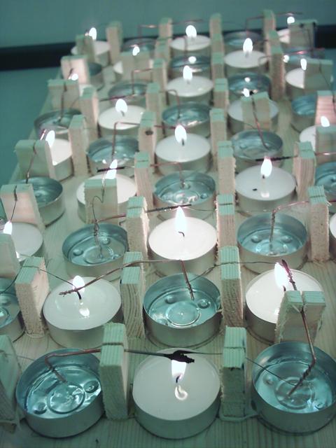

@Mike: Sure, you can make a Seebeck device out of any two metals. Here's one I made from copper and iron wire. It's not all that efficient though. It uses enough candles to power an airplane but only got to 0.045 volts... :D
