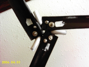

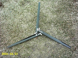

My Ametek 30 VDC that had a prop failure
Last saturday nights HIGH winds did this
So I had to make something else for it-
This is what I've come up with so far.
I used old Hub and now have PVC blades hooked to it and
are braced with old ceiling fan mounts against the pushed
on side for better strenght I hope.
Old blade=
  1. " out from hub center
  2. " width start to 5" at ends
  3. ` pitch full length
(before added aluminum add-ons)

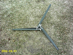

New blades=
  1. " length from hub center
  2. 3/4" wide at start to 1" at ends
  3. ` pitch at start decurving to about
ftat at tips.
Can't wait untill reinstalled on tower tomorrow, :)
Hope to get more RPM maybe.

After pulling it down to rebuild-
I noticed that I had gotten a bit carried
away when I had tighted the screws down and
Ended up with a blade that had clockwise pitch
toward the inner part and then it was counter clock-wise
toward the outer half.
This has been fixed by adding a few more nuts
Under the screws that hold the inner pitch up setting
to keep the PVC from getting turned that far.
Now it's set-up with what I has trying to get.
But of course, more testing will tell.
Still might end up heating the blade tips
and bending them a bit more if I can build a quicky
jig to hold them till cooled and set.
