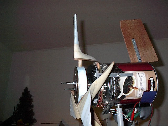

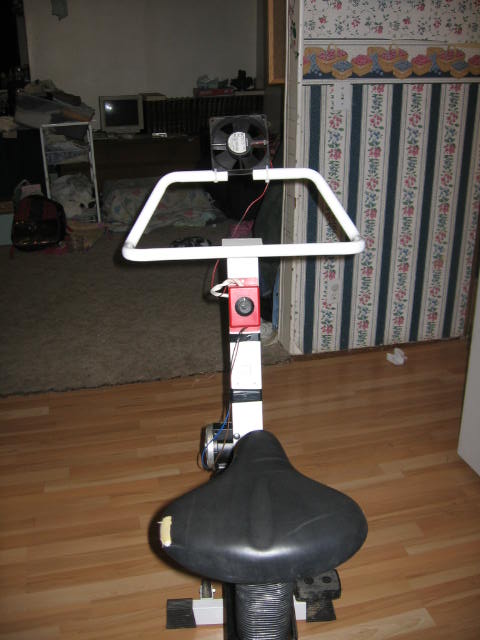

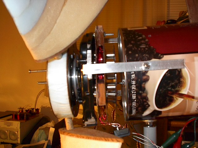

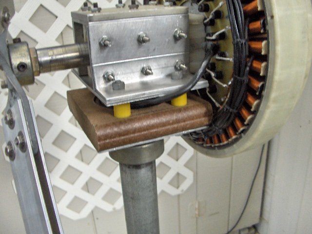

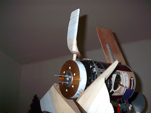

This gen has 12 poles 9 coils and was really fun to make.
the magnets are 1/2"dia x 1/2".

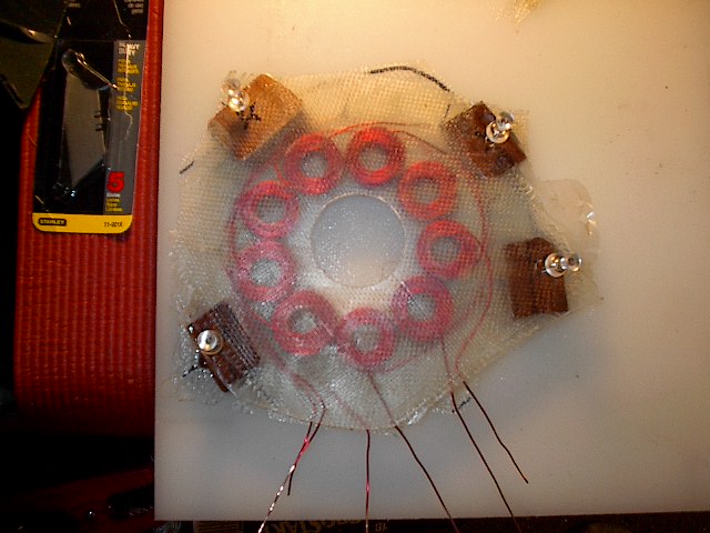

coil data::
04-08-06 Program input Gauge= 20  Wire dia. = 0.0340 inches  ohms per foot 0.0101500
coil od = 1.000 coil width = 0.480 coilid= 0.450
Program output:
Final Diameter =                 0.994
 coil radius =                   0.275
Num turns per coil radius =      8.088
Number of turns per coil width = 14.118
total number of turns            114.187
wire length(feet)=               22.167
Single wound ohms per coil     0.224996 ohms
Total ohms for one phase                     (3 coils)       0.675 ohms
Delta single wound line to line resistance (2 coils / phase) 0.3000 ohms

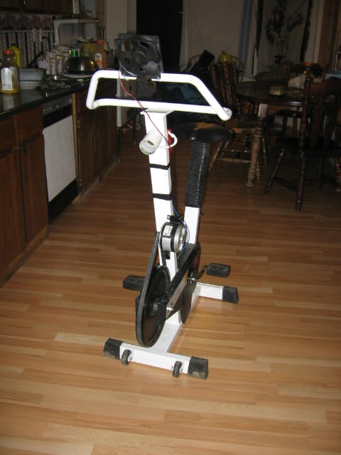

above i was tweaking the blades for maximum rpm .
i got 327 rpm with  the fan on high.strangely i got  308 rpm with the fan on low.
on the  scope is a snapshot of the phase voltage ,set on 1V / div and 0.005mS / div.
the blades are 9 3/8 " from center to tip.
i plan on using this gen to charge 1.2 V NiMH rechargable batteries.
more on that later

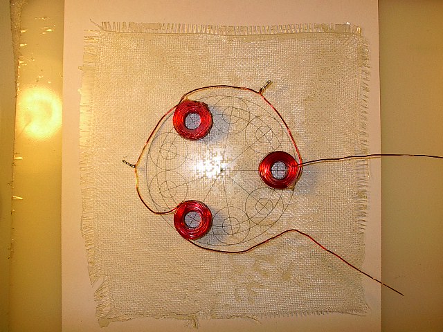

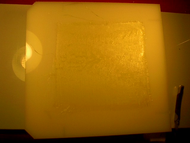

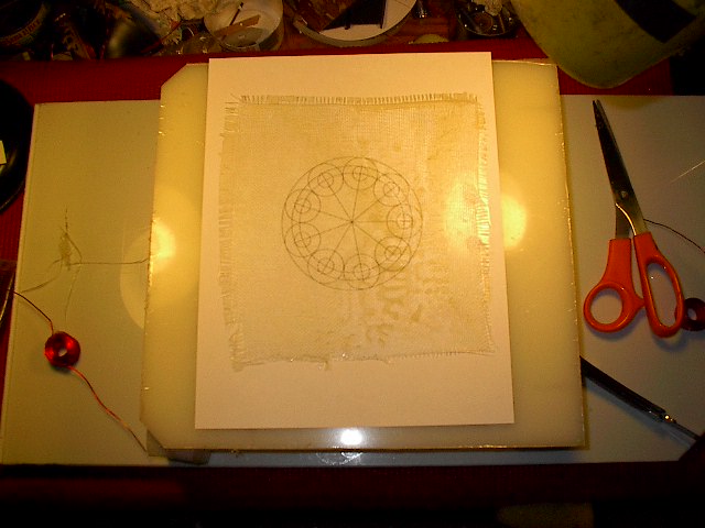

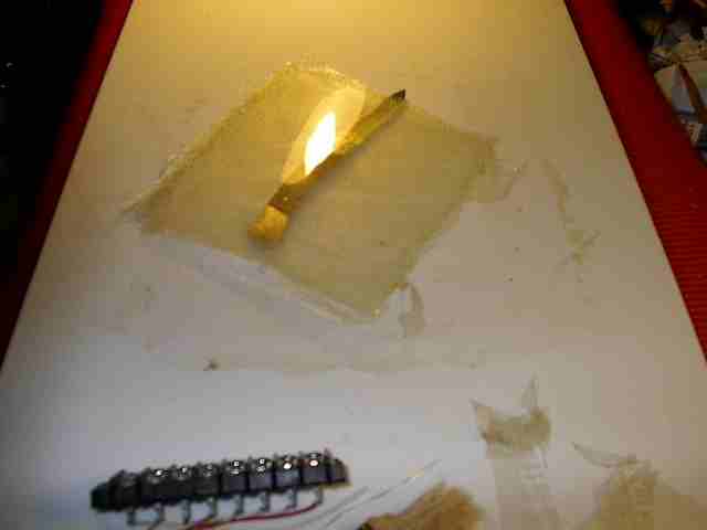

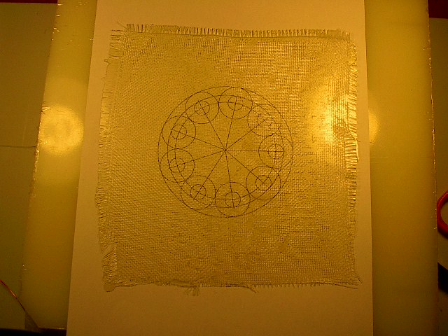

also the stator is assembled not cast
after i made the fiberglass sheets , i placed the coils over a template, and used resin to secure them in place , then i put the top piece on and used resin again,
its a very rigid stator, with very little resin used..

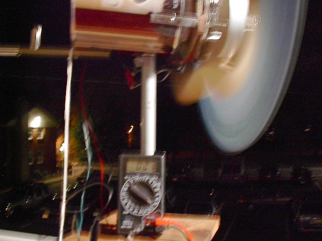

Many many thanks to all on this site without yous guys i dont think i could have finished it.
Below is the minigen charging a 1.2V battery. During this burst of wind it hit 80mA and ive seen it as high as 220mA.
i dont know where this wind ,but i'm ready for it..
 wow it just hit 316 mA.
« Last Edit: April 17, 2006, 10:22:38 PM by willib »

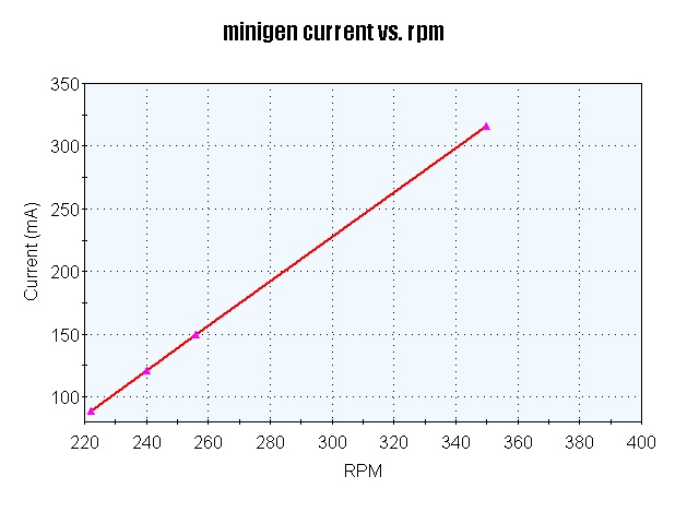

I've graphed the data point i got last night
this is the data
 (mA) RPM - fan speed
  89 - 222 - low
 121 - 240 - med
 150 - 256 - high
these three points i got charging a 1.2V battery by the fan method.
this last point i got last night was 316mA and i plotted it to fit the curve.
http://www.otherpower.com/images/scimages/2965/line_3BDFB1B4.jpeg

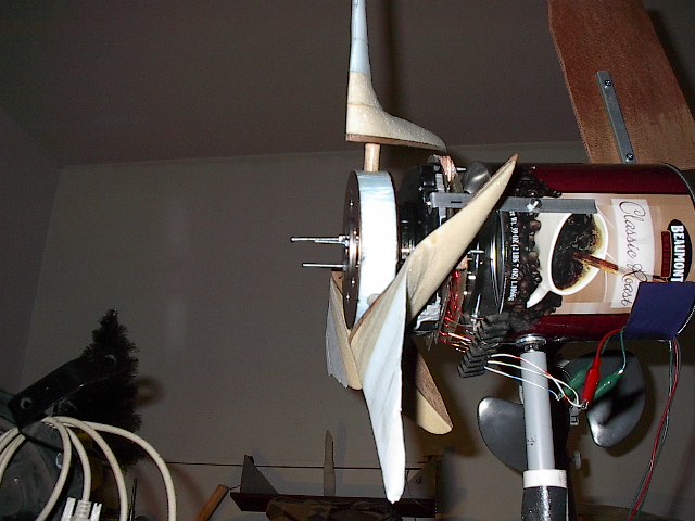

On these blades , when the hub loosens up , or the wind is really strong , the blades trailing edge tends to move  forward , (into the wind) ,which way should i move the pivot point ,(mount)  and more importantly why.
(you must justify your anwser)
« Last Edit: April 20, 2006, 08:59:15 PM by willib »
Re: mini-gen done!
« Reply #17 on: April 21, 2006, 07:19:50 AM »
Flatter?  Because the blades are trying to go faster to the point where air resistance is forcing them to a lower angle of attack?
I don't know, but its interesting that happens.
« Last Edit: April 21, 2006, 07:19:50 AM by ghurd »
Re: mini-gen done!
« Reply #18 on: April 24, 2006, 02:24:37 AM »
Yes , i thought so..
« Last Edit: April 24, 2006, 02:24:37 AM by willib »

i was testing the minigen , and got 1A DC from it , turning it by hand @ 250rpm.
just need a bigger set of blades for it  i suppose .
no problem there.
