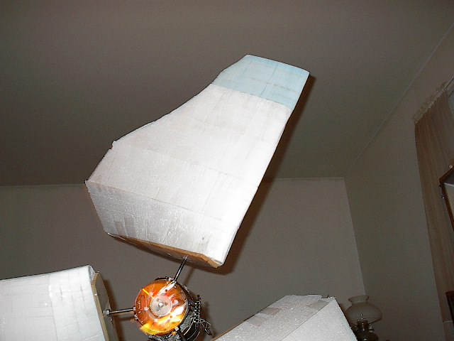

this is a mold for blades , that i'm going to make
i'm going to fill the hole with canned foam and glass and epoxy .
i found the perfect foam ,it dries hard as a rock yet is very light , and strong..
its taken weeks to get this far.
, but after i get the mold done i should be able to make a set of three in a several  hours depending on the temp , and the curing time needed for the foam..

Re: 3.5 foot dia. tsr 6 blade mold
« Reply #7 on: June 21, 2006, 05:38:51 PM »
the ones i was referring to in this post were the larger ones
http://www.fieldlines.com/comments/2006/5/14/84437/3687?pid=11#13
which are just shy of 8 feet dia at the  moment.
the photo at the beginning of the thread
http://www.otherpower.com/images/scimages/2965/IM002082.JPG
is an old one i've since added 30 inches to the dia.
i have one more 5 inch section to add to all three blades
« Last Edit: June 21, 2006, 05:38:51 PM by willib »

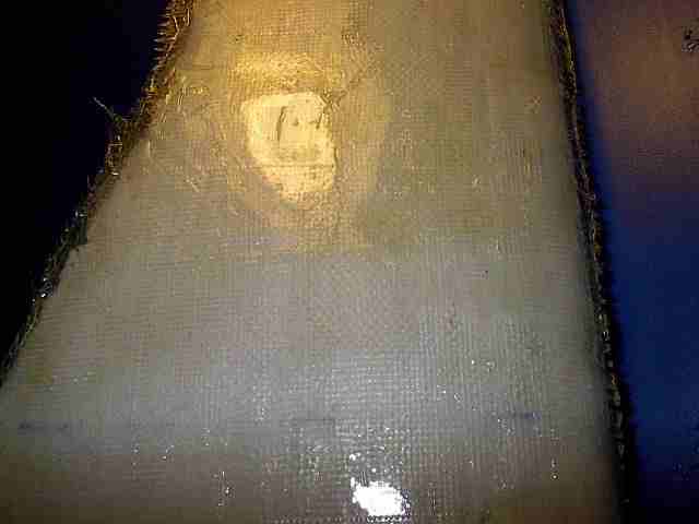

« Reply #9 on: June 25, 2006, 10:53:48 AM »

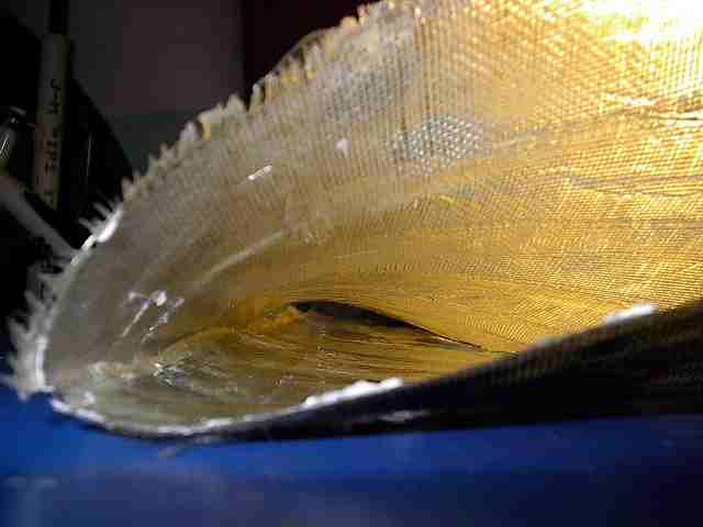

I've got the leading side curing at the moment .
What you are looking at is the inside of the leading side .
the outside of the leading side is going to be a lot smoother .
i spent days thinking of how i was going to hold the mold , and i even made a cradle for it , but as you can see i didnt use it.
the convienence of being able to move it around while i was applying epoxy won out over the mold holder..
« Last Edit: June 25, 2006, 10:53:48 AM by willib »

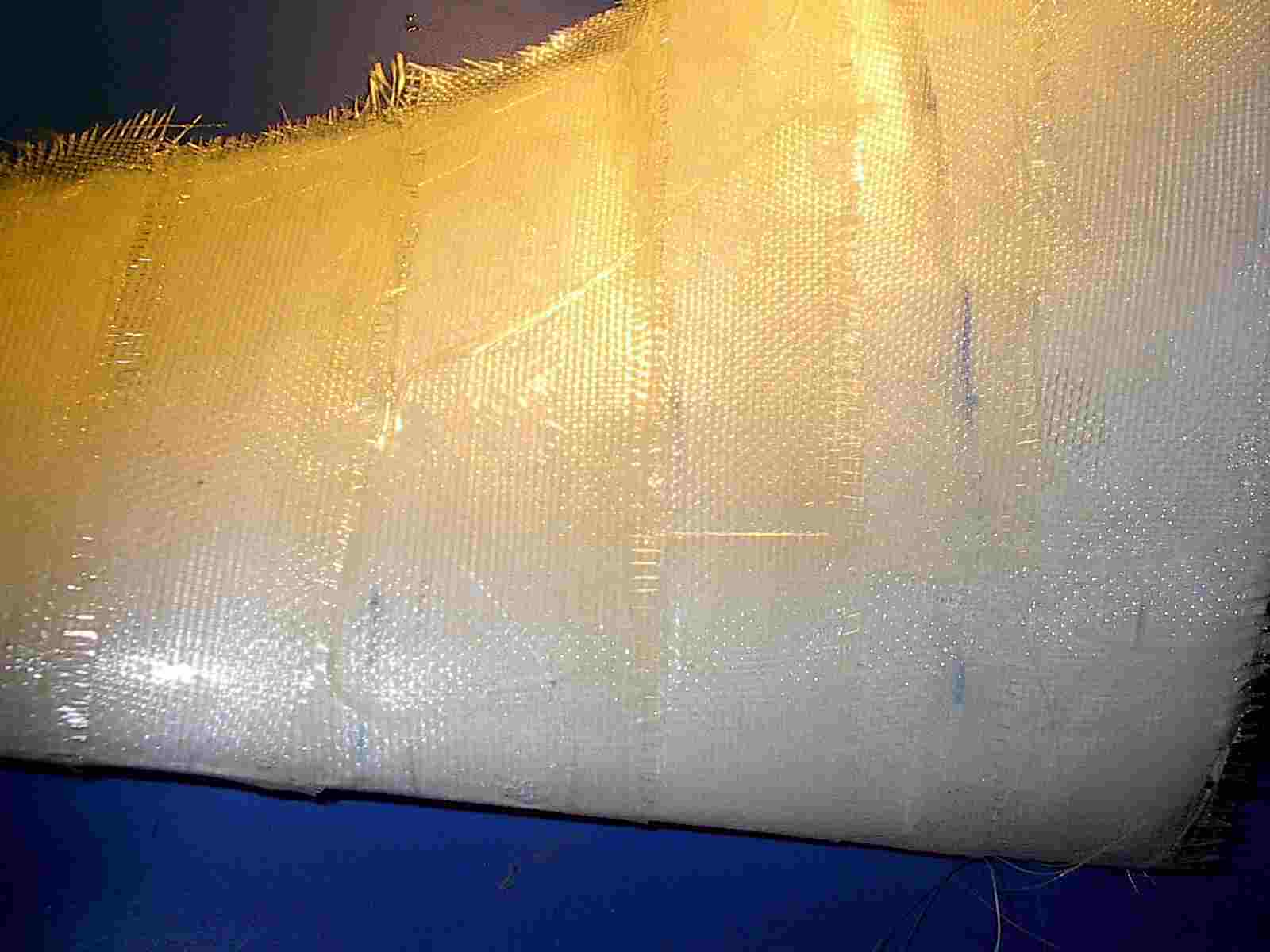

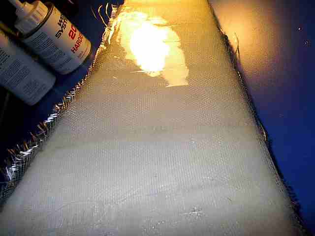

it came out real smooth ! ! !
« Reply #10 on: June 25, 2006, 12:53:33 PM »
i think it came out real nice!!
« Last Edit: June 25, 2006, 12:53:33 PM by willib »
Re: it came out real smooth ! ! !
« Reply #11 on: June 25, 2006, 05:13:22 PM »
Is that the airfoil (convex top half of the wing) or is it a pic of the complete wing from the convex side.
If it doesn't work, at least it'll look good (after a haircut)............oztules
« Last Edit: June 25, 2006, 05:13:22 PM by oztules »
« Reply #12 on: June 25, 2006, 09:39:31 PM »
Hi Oztules, its the outside of the leading half ,that faces the wind.
No its not complete yet , hence the strands..
it is just a shell of its future self :)
« Last Edit: June 25, 2006, 09:39:31 PM by willib »

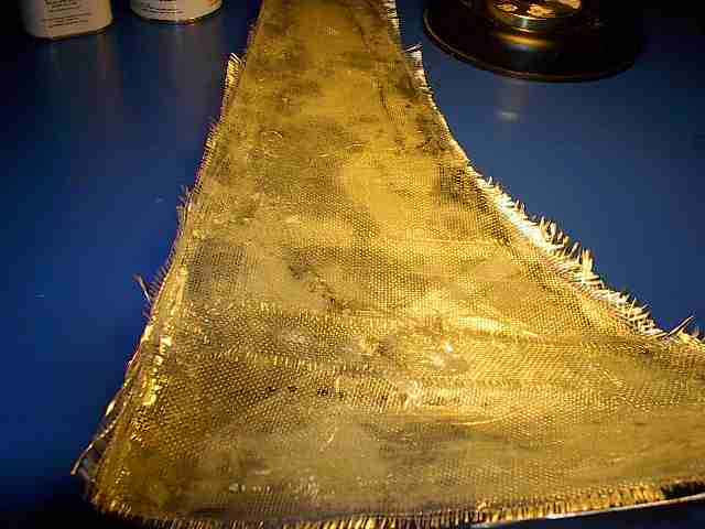

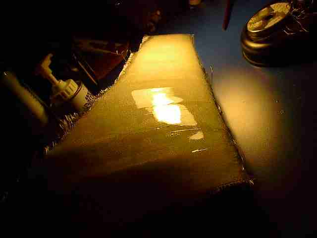

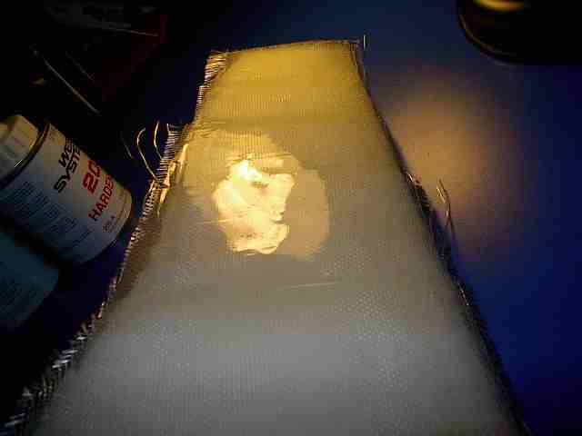

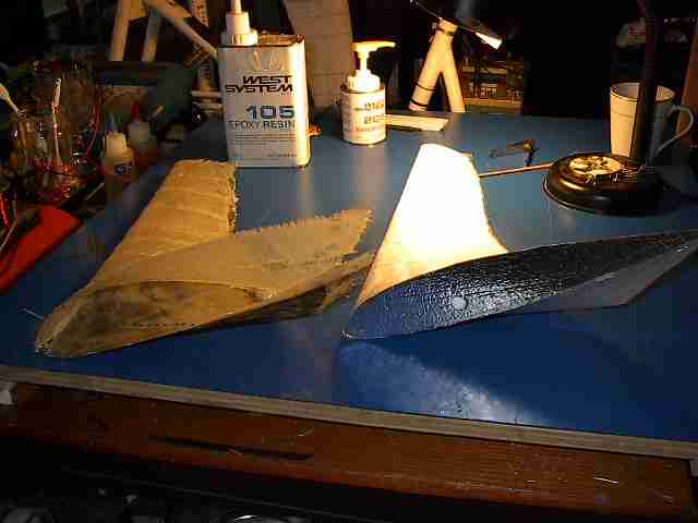

« Reply #13 on: June 26, 2006, 12:23:37 PM »
i did another one of the outside of the leading side , but this time i used polyester resin. it came out ok , but the poly resin is not as clear as the epoxy resin.
and i'm soo glad i made the mold like i did , because i think there is no way the mold would have come apart if i had made it as one piece .
the above airfoil half  is really a little more yellowish looking without the camera flash .and not as professional looking as the epoxy resin. i hav'nt tried a gel coat yet hmmm that might look nice, with a white jel coat, and a red jel coat on the tips..
« Last Edit: June 26, 2006, 12:23:37 PM by willib »
