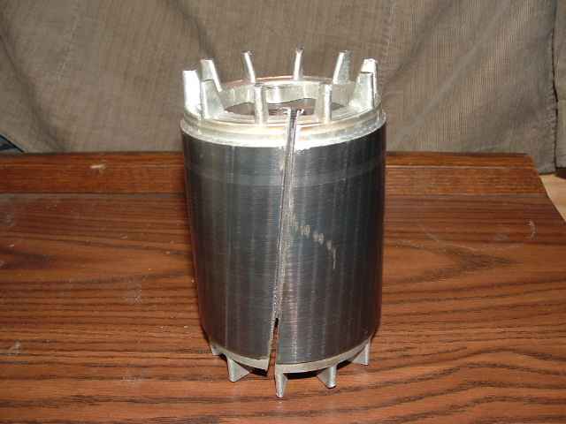

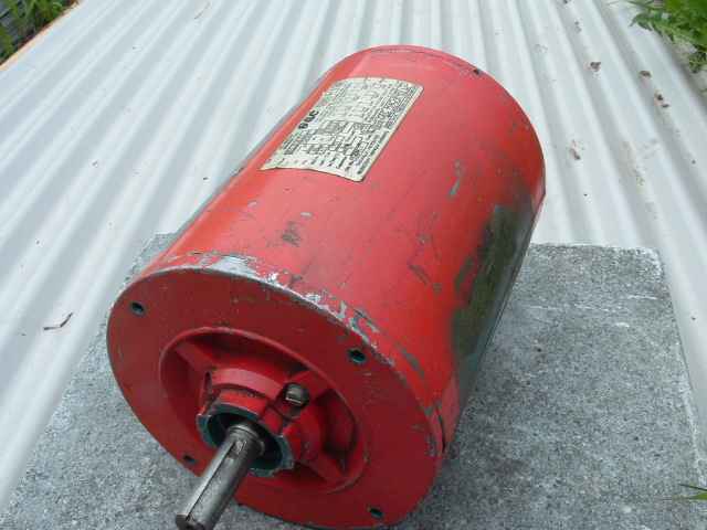

I am driven to an accelerated rate. This is the motor.
Looks like any ordinary 1&1/2 hp , but this one is fried, cooked to perfection.
Taking it apart was a breeze, I used the Zubbly no nonsense approach and
chiselled the burnt windings off.
Rather than machining the rotor down I elected to remove the laminations and use the old shaft.
I cut the lams with a thin kerf blade and then slid them off of the shaft.

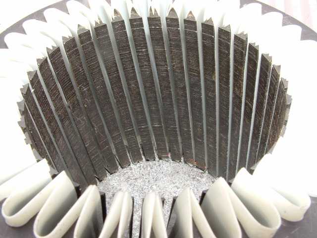

The stator is skewed ten degrees and I have installed the (Dacron-Mylar-Dacron .01") insulators.

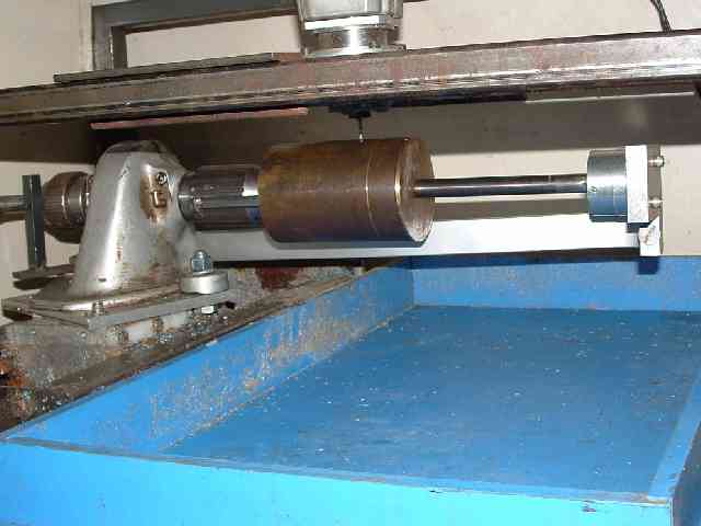

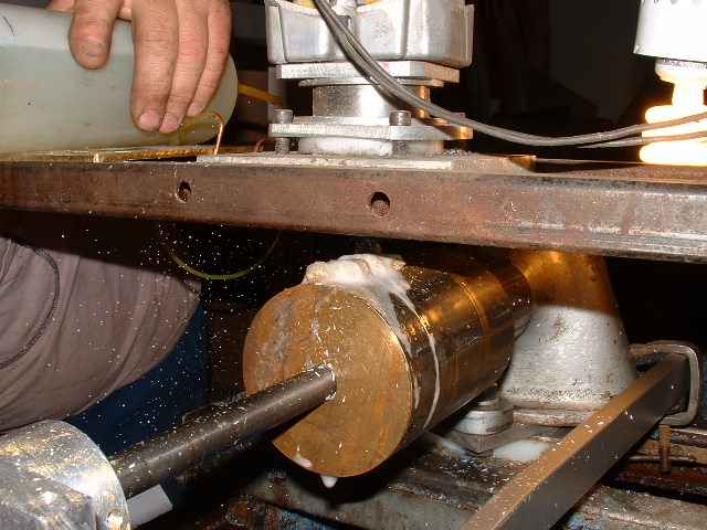

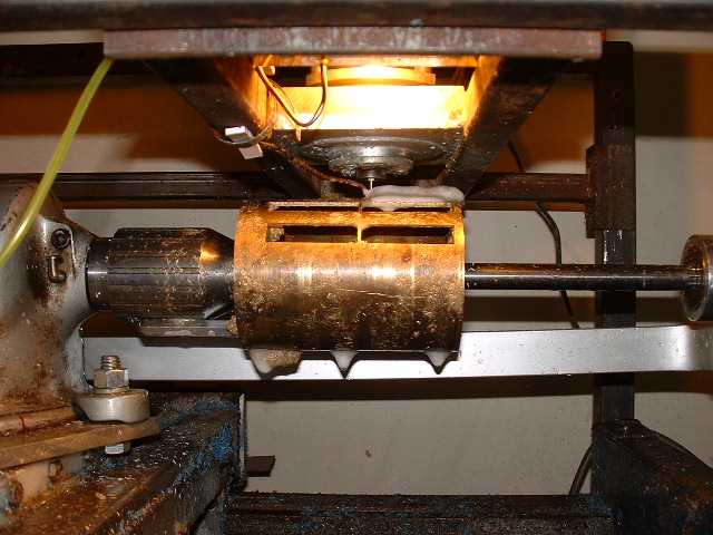

Here is the first test cuts with the WXYZ Machine. The magnet fits good the second attempt.

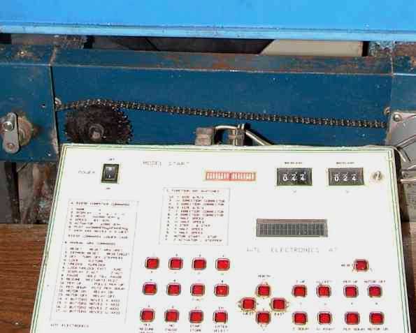

My blank cage is mounted on the horizontal indexer that was added to this old work horse last week. The indexer is geared to give me a resolution of 36 divisions.
This is the A7 CNC Controller, one of Bill's early models. The backlash thumb-wheels are on the top right of the unit.
The Cut Begins.
The Cut Ends

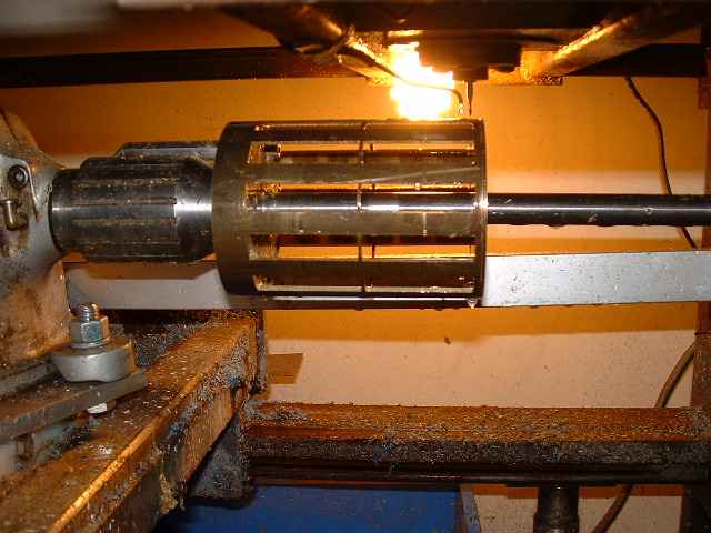

It takes almost two hours to cut the 24 magnet holes. Slower than I could, but it pays in the long run on the cost of cutter blades. They are dual flute 1/16" solid carbide, running at 50,000 rpm. I use 25 ml of standard dish soap to 1 litre of water as the cutting fluid to cool the cutter.

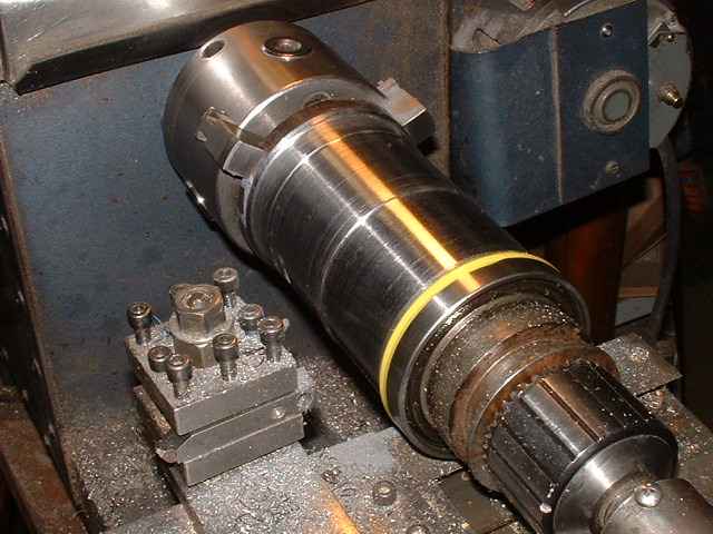

The brass pipe had it's start in life several hundred feet under the ground, as it was in it's past life a deep well pump casing. Recycled to live on.

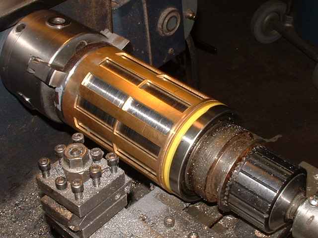

The new rotor is being machined to hold the 24, 2" x .5" x .385" N40 neodymium magnets.
The cage is now placed over the steel rotor.

hi WXYZCIENCE!
that is one beautiful piece of machine work on the cage. and fantastic job on the skewing.

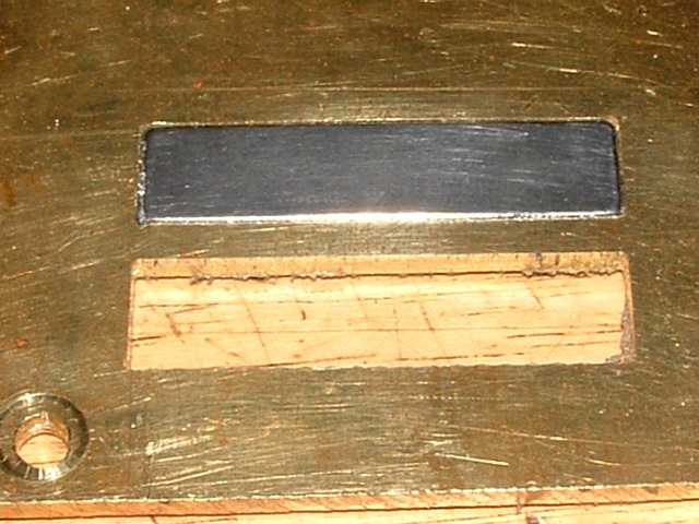

what will you be using to secure the mags into the cage with? epoxy comes to mind. you could also put a few small swags alongside the mags on the brass.
anxiously waiting for your next post on progress.
zubby
Hmm.  That's 0.00001 inch chip load per tooth per rev.  100-300 times slower feed than is proper for brass.  At those kinds of slow feeds, you will actually decrease cutter life, not extend it.
Then again, who cares about extending the life of a $3.00 cutter if it takes 2 hours to do a 20 minute job?
Just out of curiousity, why did you use a 1/16 endmill?  An 1/8th or 1/4 would have allowed you to complete the job faster.  Did you use the 1/16 endmill so you would have a 1/32 radius in the corners?  Even then, you could have cut the hole with a 1/8 or 1/4, and then used the 1/16 to finish the corners, but that would have been 2 tool changes.  You could have also used a larger endmill to go a little further at the corners - the sides of the holes would still have held the magnet in place ok.
I don't mean to sound too critical, but as a machinist I notice these kinds of things.  I'm glad the cage worked out for you.

that is an awesome  machine you have there.
i noticed the bubbles and wondered , soapy water  thatl work.
countryboy he could have used a larger (1/8") endmill and just file the corners.
not haveing a machine like that available you get used to the old fashioned way of doing things.
like laying out the slots , using a drill in the corners ,then a small coping saw, then a file . that would be the way i would have to do it...

  The old fashioned ways still get the job done.  Using an oversized drill bit in the corners would eliminate filing too.
  They make tiny cutters that look like miniature circular saw blades for cutting slots.  You could always put a slotting blade in a drill, and rig up a jig so your blade cut where you wanted to cut the slots out too.  That would save a lot of sawing by hand.
  As easy to cut as brass is, a jig saw would work pretty well too on a thin piece like this.

Willib, I have tried all kinds of cutting fluids, the soap and water works the best and it is cheap. I can always find some under the sink in the kitchen. The old machine was built with a drill press, 4" bandsaw and files. Using this old machine, I cut half of the parts on my latest model. Joe

Peter, I took the long screws that came with the motor and piled the stator plates up on the four screws. My motor was cooked good so the lams came apart real clean. I then placed the whole stack on a piece of plywood with 4 holes in it. I now can turn the whole setup left or right. I measured the skew and it was 10 degrees exactly when the screws became tight. I placed a wide band around the stator pile and clamped them. I will drill new holes for the long screws. I will also split the case, this will allow me to slip it over the stator after the winding are installed. Then I will clamp it and re-weld the case. The insulating Dacron had to be cut with the same skew to make it fit correctly, this was also by trial and error. Joe.

Zubbly, I put the magnets into the stator last night. It is not as easy to do as my mind told me it would be. I had 50 of them. Now I have 54 of them. Mistake #238461 : Don't set two of them within arms length of each other. I can just imagine if they were real strong ones. This is my first attempt at large motor conversions. The magnets fit   tight and I had to make sure they placed in flat or the would not fit. I will use a lock-tight and I like you suggestion of the swags. Joe

Very nice skew job Joe

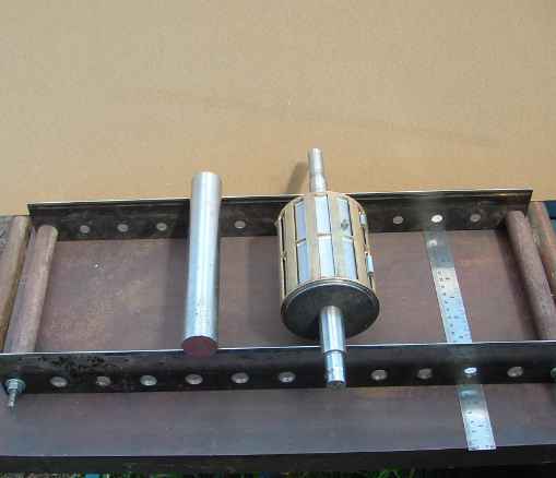

I made this balancing device to static balance the rotor. It is made from two golf course reel mower cutter blades. The table-saw makes a good base and the ruler is a level adjustment shim. The 1" cold rolled drill shaft levels the parallels. By adding small magnets to the rotor I find and mark the heavy and light sides. Metal is then removed or weights added. This works good if the unbalance is small.
« Last Edit: June 24, 2006, 10:34:24 AM by WXYZCIENCE »
Re: "Simple Balancing Act"
« Reply #14 on: June 24, 2006, 11:51:55 AM »
Joe you might try a pair of ball bearings to balance this .
this way it does not have to be perfectly level.
just a thought ..
« Last Edit: June 24, 2006, 11:51:55 AM by willib »

Countryboy, 50 000 rpm is around 800 SFPM with a .0625 endmill, not exactly out of control for solid carbide in brass. After that I'm sure rigidity and DOC dictated feed. I can't see running more than a half thou per rev. with that setup so the feed would seem about 20 times too slow but the real question is did it work?

Cutting speed on all of my machines is as you say dependant on many factors. Slot milling is what I do most. The speed is related to the experience that has been gained over the years. If I break a cutter half way through the job it is not the cost of the cutter that is hard on me. It is the time that it takes to replace and restart the job.   I include program loading, material setup, cutting time and positioning. My z bed is very slow on this machine but it has worked well for me for many years. I also have no feedback loops, it is bare-bone simple. I run the axis speed at less than half what I could. My success rate for most parts is very high. Joe
« Last Edit: June 24, 2006, 08:41:30 PM by WXYZCIENCE »

For cutting most aluminums, you want about 165 SFPM with a high speed steel cutter.  (1980 surface inches per minute)
  1. /8 cutter is 0.125 times 3.14 equals 0.3925 inches per rev.
  2. /0.3925 = 5045 RPM
I'd use about 0.0005-0.002 feed per tooth per rev.  (I'd feed at .001 per tooth, and slow it down if I kept breaking bits.)
I wouldn't recommend using an endmill to cut soft pine.  I'd buy a 1/8 inch router bit, with cutting edges designed for wood.
I don't have a book with speeds and feeds for woods.  I'd recommend calculating what speed (surface feet) a planer or table saw cuts at, and go from there.
