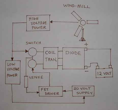

"Concept Drawing of How to Control High Voltage Power"
The idea seems simple and comes after the wind-mill is producing power.

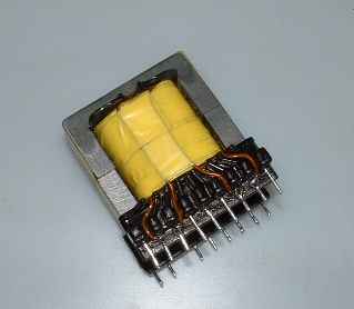

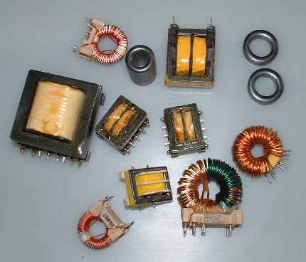

The next step is to start collecting parts that will do the job. There are lots of these things in the supplies and monitors. All different sizes and types and who knows the wires in them? These are the good ones shown below.

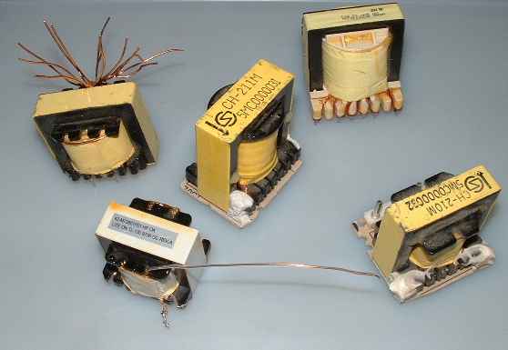

Can you tell the difference? The first ones are high frequency type material and the second ones are low frequency material.The second ones will not work for high frequency transformers.
Now to make some useful parts out of the old transformers. First I had to break the core in half. This can be a lot tricky. I lucked out this time and picked one that cracked like an egg. I collect these things and then add them to my collection.

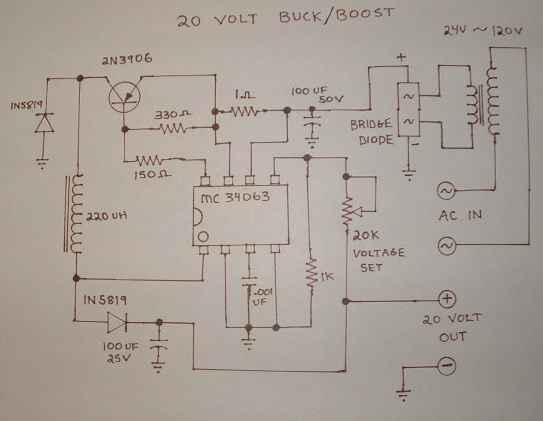

Now time for a circuit drawing.

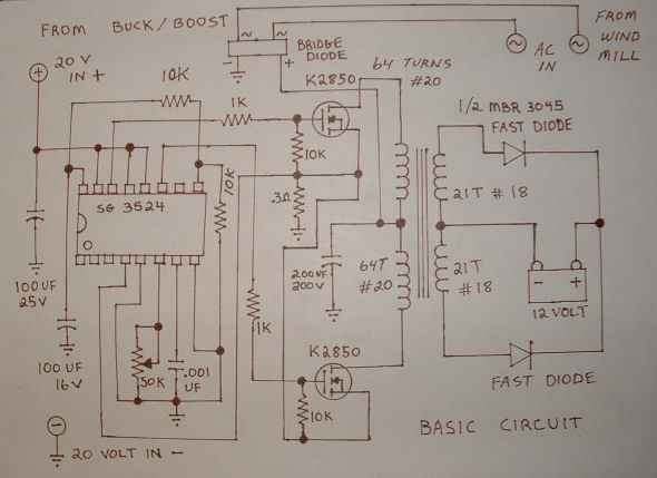

This is the basic inverter circuit and should give me a simple understanding of the parts required. There is a FET driver power supply in the next circuit diagram.

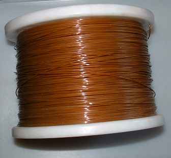

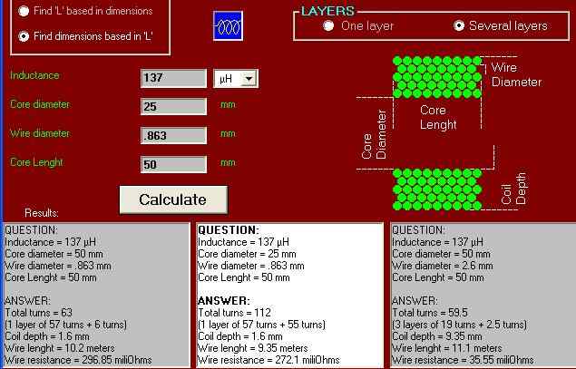

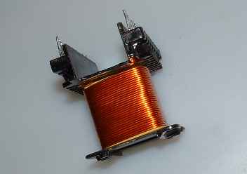

Winding the transformer is one of those things that I have done many times before. This time it will be wound differently. Guess work I guess. Wire size, let me see what size of wire is in stock. Have some 18 gauge and 20 gauge. The larger number is smaller wire and the smaller number is larger wire. Looks like I will use the thinner wire for the primary windings and the thicker for the secondary. Wire comes in a large roll if you want to get it cheaper.
Start winding or I will be here all day.
62 wraps of # 20 gauge 31 wraps per row. This is done twice to give me two complete coils of 62 turns # 20 gauge. Yellow mylar tape is added to insulate between the primary and secondary coils. There are 30 Turns #18 gauge in the secondary and two of these coils are added to finish the secondary.

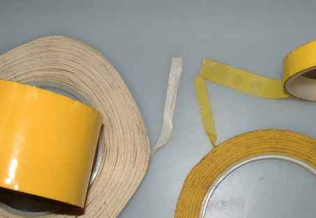

This white tape is also use to hold and insulate the coils.

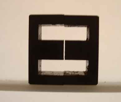

The core on this one has a small air gap and you can see it in this picture
A finished core, hand wound and ready to add the the circuit.

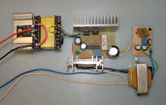

Hand wired inverters, I was told, will not work. Funny thing this one works fine.
Finished Proto Type

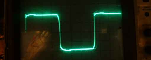

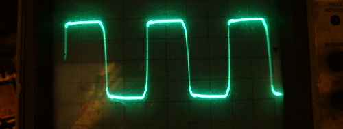

Just a bit of testing now.
And some more testing.
The project works but has a few draw backs. This type of work is akin to witchcraft. I am looking forward to making the next one. 45~120 VAC in 15~40 VDC out. Any questions? Bill

The converter using the MC34063, why using a 2N3906 ?. It is just a 300 ma device ?.
Were you experimenting ? Specially driving the PWM controller from an AC supply.

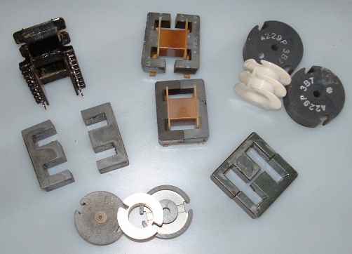

Photo number five, showing some common mode chokes and cores can under certain conditions be used for power supplies.
I use the common mode chokes for a push-pull voltage doublers with good output power
The one on top of the photo seems good for about 10 or so watts at around 30 - 40 KHZ, best way is to use an oscillator and divider driving 2 Mosfets at a frequency that does not allow core saturation prior switching.

Nando, The main drawback is the range of voltage that this switcher will operate at. The 20 volt stepup/down converter runs the pwm and cuts in at 6v and has a range to 40v
the step up/down circuit operates at 3 ma 12 volt and total circuit power is 10 ma. This was an attempt at making something and not having to leave and get any new parts. Another drawback: One of a kind project. A switcher that I used from an old monitor required no modification and preformed better than this circuit. That switcher was a flyback type and cuts in at 20vac and puts 20 volts out over the range of 20vac to 140vac. I was seeing if this type of switcher would work. Million projects and switchers are not my strong point.
Problem posed. Good voltage and frequency range, low operating power requirements, high power output and short circuit current limit. One other thing low cost. Bill

The transformer ferrite you used.... was it the one with the air-gap on the inner leg? Is this necessary to prevent saturation in push pull of this type.... I felt it to be only necessary on the buck and boost types.

Oh, and what kind of power was the waveforms taken at, and from where (switcher out, or across the primary, or is it the secondary.... at what load.

Forward converters really need a choke (inductor) in the dc output to the battery, especially for larger outputs.
The other thing is the 1k gate resistors, these are far too high, the gate capacitance will slow the drive pulse and your waveforms show it. High impedance gate drive also means that the gates are exposed to transient spikes from the miller capacitance resulting in spikes from the rapid voltage change on the drain being induced on the gate. If they exceed the gate breakdown voltage the fet dies.
Try reducing these to about 22 ohms.
I would keep with the air gap in the core although in theory it is not strictly necessary. It will give a margin of safety against core saturation.
I didn't read your transformer construction but you should bifilar wind the primary and the secondary and even then you may need a RC snubber across the primary.

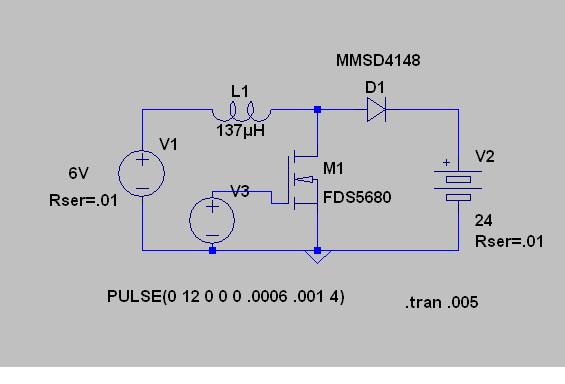

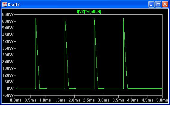

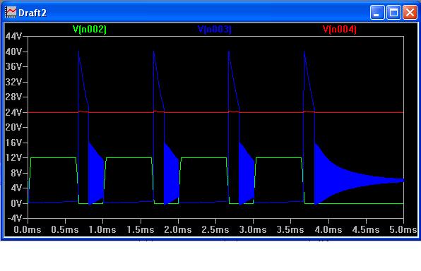

I've run a simulation on the circuit
i've chosen to use 24V as the battery voltage with an internal resistance of 10 mOhms , because after the hookups between two 12V batteries this seemed a reasonable value.but i could change it if somone knows better...
V(n002) is the voltage from the pwm
V(n004) voltage on the battery
V(n003) is the voltage at the output of the inductor , as you can see there is a tad of oscillation, not exactly sure why ...but i'll try to find out.
I(v2) current into battery
 V(n004)is the voltage at the battery.
i'm still learning this simulator ( it is a neverending process i'm afraid), so i'll try to find out how to average the power
questions?
« Last Edit: July 09, 2006, 02:33:04 PM by willib »

The ideal approach, as I see it, is to cascade two converters. First is a boost converter to take the windmill voltage to some high dc voltage. Then a push-pull down converter like you've built to the battery voltage. The second converter should have an mppt derived control voltage.

a while ago i found a real nice coil calculator on the web , but misplaced it . :(
well last night i found it again , on the other box
http://www.otherpower.com/images/scimages/2965/coil_dims.JPG
it just does air core coils , but at least it takes some of the guessing out of making a 137uH coil.
in the photo are three runs all of 137uH
the first two are with 20 gauge wire the last is with 10 gauge
« Last Edit: July 13, 2006, 07:30:35 PM by willib »
