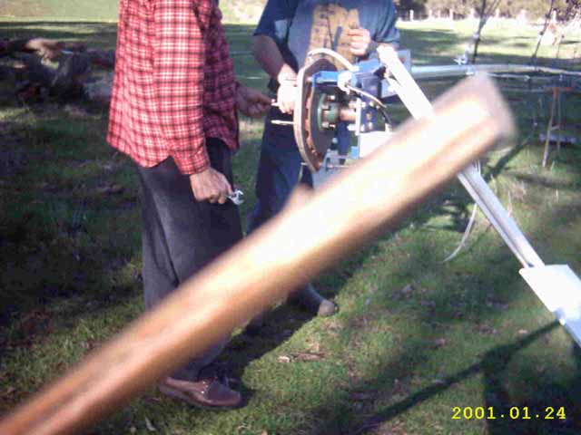

So two days later Grant (Trivio) and Dominic (Domwild) came and we lowered it to inspect the damage.  Now I'm resonably convinced that it just overloaded and burnt out, it did not furl until 15m/s, I will be cutting some off the tail before it goes up again. Maximum wind speed recorded was 21 m/s.
So what we found...

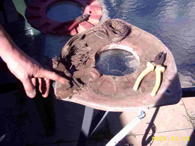

One magnetic rotor was magnet less, it had got so hot the magnets lost their strenght and flew off.

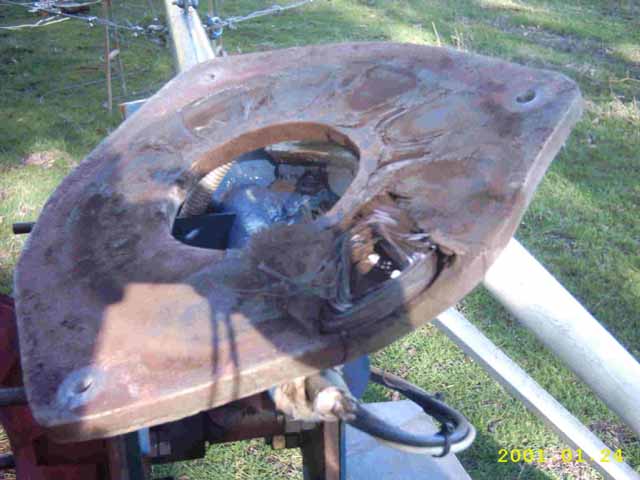

Stator completly burnt..
So its a rebuild, coils are wound and as time permits we will mold a new stator and magnetic disc. Fortunatly we have spare magnets from when it was a tripple rotor.
Suprisingly the front magnetic rotor is as new. This is a five phase Hugh design and one bridge rectifier was kaput, one wire off and smelly (magic smoke all gone), quite when that happened in the failure sequence I don't know.

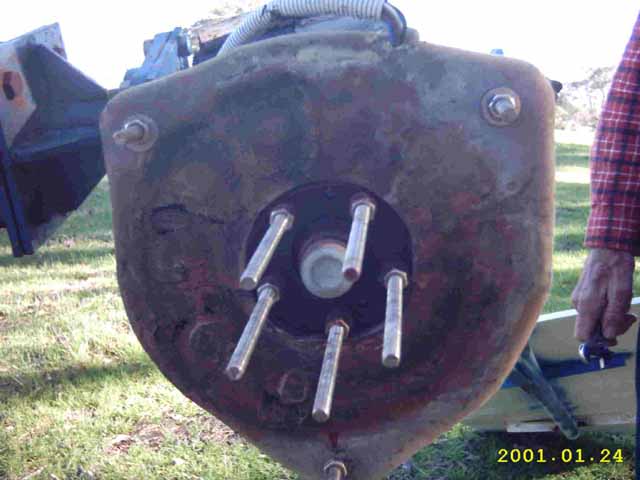

The nuts holding the stator were loose but it did not show signes of severly rubbing. These were probally the only ones that were not generously locktighted.

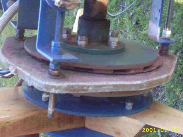

Oh yes the slight noise at low rpm's was the fiberglass disk in pic two ratteling around.
Supprisingly I observed no sugnificant out of ballance, just as well or it would not have survived 24 hours of free wheeling.

How many coils are burnt ?
This looks to have been caused by rectifier failure.
« Last Edit: August 12, 2006, 12:27:59 AM by Flux »
wpowokal
  • Posts: 1271
  • Country: au
Re: Phoynex burning
« Reply #6 on: August 12, 2006, 01:00:19 AM »
Flux, five coils all in a row are burnt, only one rectifier has failed.

I believe I have finally worked out the failure cause, I suspect the rectifier failed some time ago as I noticed a drop in performance.
This possibly caused some stator vibration, anyway the retaining nuts for the stator came loose on the back side allowing the stator to contact the magnetic rotor.
We either could not fit lock nuts or did not, but also we did not use Locktite. This is the third rebuild for this unit so since things come in three's it should go up and fly forever this time.
