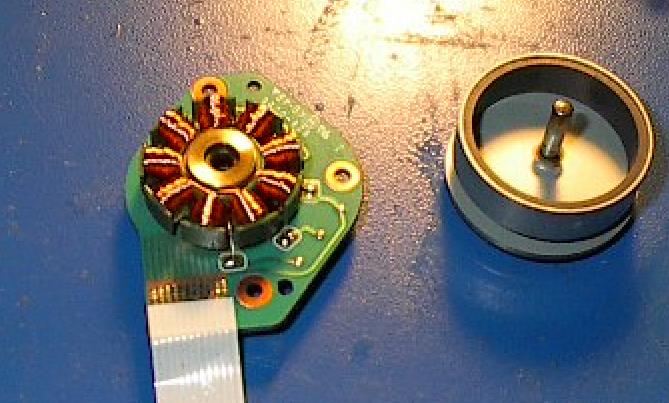

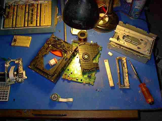

I thought i would do a little investigating today .
Hall sensors as i found out can be found in old CD rom drive motors
here is three that i got out of one motor
on the right  is my trusty Weller with the attachment that i used to get them off

it only took about five mins to get the motor out of a CD drive, the rotor with mags just pulls off , the tool i used to get them off ,is some 17 ga wire wrapped around a soldering iron

Is that where you got your sensors from?
a cd drive ?
thats  them at six , four thirty , and three o'clock.
Warske peeled the metal off the back of the circuit board , but i saw no need to because the chips were allready visible , and accessable.
« Last Edit: August 13, 2006, 09:51:41 AM by willib »

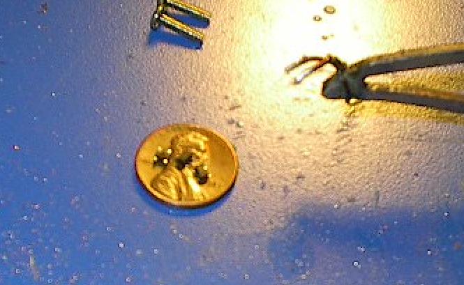

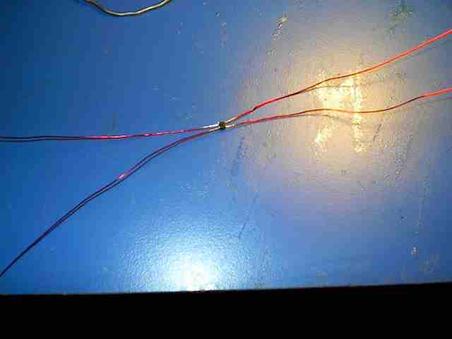

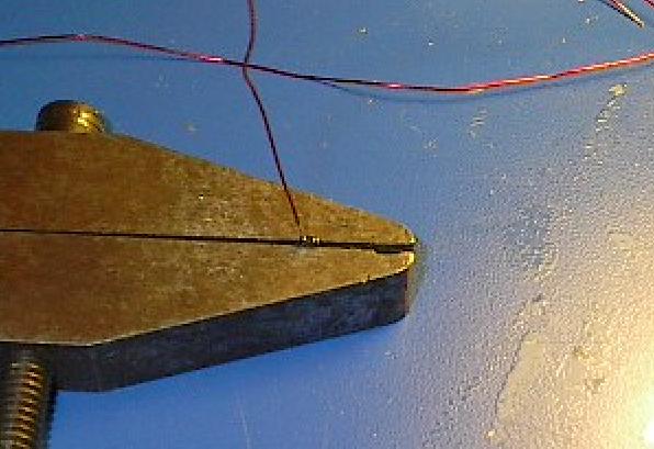

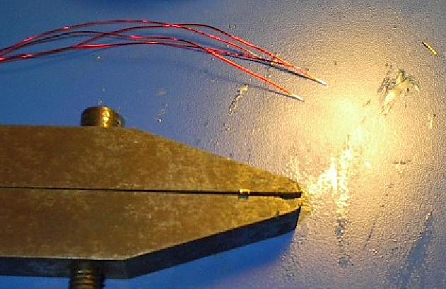

Preperations and soldering
« Reply #5 on: August 13, 2006, 11:57:05 AM »
i've tinned the wires in preparation for soldering
and put the chip in a clamp to hold it and soak up some heat just in case
all the wires went on smoothly
one came off so i had to redo it
all wires are on
time for fun
« Last Edit: August 13, 2006, 11:57:05 AM by willib »

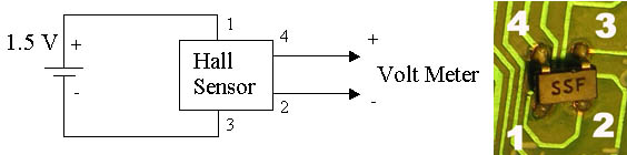

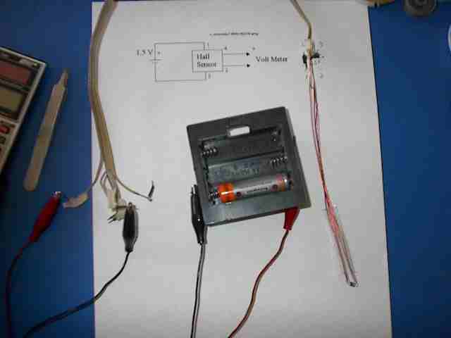

hall sensor pinout and schematic
« Reply #6 on: August 13, 2006, 12:09:54 PM »
following warske this is the pin out and a schematic
« Last Edit: August 13, 2006, 12:09:54 PM by willib »

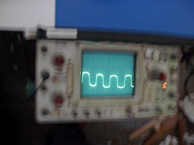

« Reply #7 on: August 13, 2006, 01:42:13 PM »
i was hopeing this would be the case
you could also use the sensor to measure RPM if necessary
sorry for the blurry pic but its hard to snap a shot when your turning the testbed.
with a 1.2V NiMH battery hooked up to the sensor , the scope is set at .5V per div
the reading from the sensor is about .6v peak ,  with the sensor in the path of the magnets
« Last Edit: August 13, 2006, 01:42:13 PM by willib »

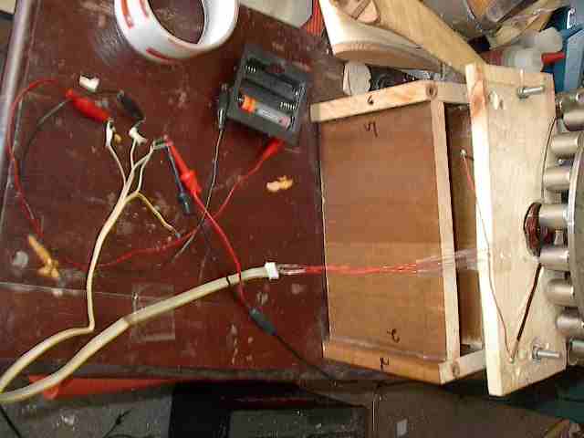

« Reply #11 on: August 13, 2006, 07:43:35 PM »
Thanks for your comments

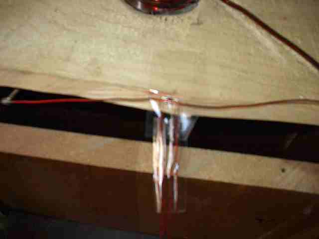

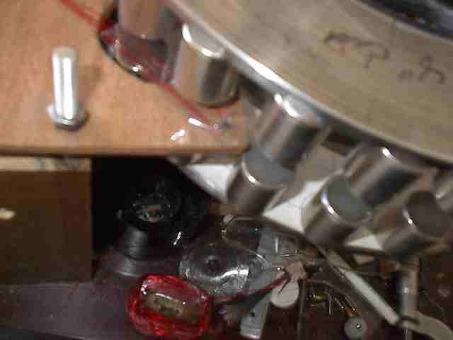

Below is the sensor between the magnets
this is the setup , thats it on the right at the end of the wires, its powered by a single NiMH AA battery
i  was just trying to get a reading off the coil here , i quess i need more turns
a close up of the sensor, i sure wish i could get better closeups , maybe if i use a magnifying glass they would come out better

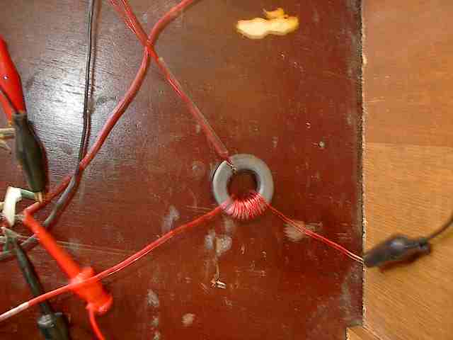

below is the setup that really worked well , its similar , if not exactly what Jim did , except that i've put it in the line comming from the test coil ,i have twelve or so turns wrapped around a ferrite toroid , with a slot cut in it and the sensor inserted in the opening
 and got great results , at low RPM the wave looks like a sine wave with a peak of .2V , at higher RPM i've had  .4V peak out of it , so the wave grows with an increase in current , and one could also measure RPM because its a sine wave
« Last Edit: August 13, 2006, 07:43:35 PM by willib »
