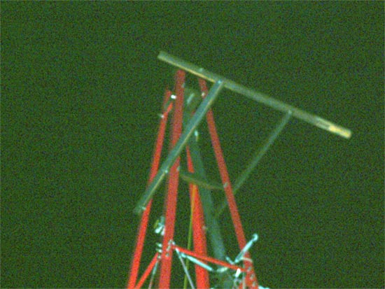

Well, folks, the "Project From Hell" is completed.
For those who may not know what it is I am talking about You should check out my Diary from March of 2004:
http://www.fieldlines.com/story/2004/3/3/23120/58334
In deference to those with limited bandwidth I posted some photos over here:
http://www.anotherpower.com/gallery/album50
At the end of 2004 DanB was kind enough to give me a DanBilt [#20 he said]. I am happy to announce that, with the help of many, I have managed to see this project thru to completion in slightly less than 3 years time.
We now have 2 windplants here on the farm. A 2 meter Zubbly conversion at 30 feet and a 10 foot DanBilt at 60 feet. Both feeding 450 AH of Trojan 105's providing 24 VDC for the Outback 2524 we purchased last year. As a supplement to the 300 watts of solar we have had for several years they will be appreciated a lot.
Rebuilding that tower turned out to be a lot more work than expected. It became a bit of an international effort, with hands on help from several folks and discussion / brainstorming from folks on 3 continents.

I decided to build it in place from ground up rather than tilt it up after construction. In retrospect, I would tilt it up after rebuilding it on the ground. Hind sight is good.
After the last time JacquesM was here the tower was mostly complete only requiring a catwalk to be bolted on and some tweaks to the bracing.
Many others assisted with moral support, engineering advice and ideas. That list would include but not be limited to: DanB, Brucedownunder, wpowokal [Allan], BobN [R.I.P.], Zubbly, Whiskey, Pickster, ibedonc, and most of the regular posters on this useful site as well as many of the IRC folks. There is just no way I can remember everyone so if I forgot you, please understand it is simply memory issues and not intentional.
Several local folks, including my wife helped as ground support in the final stages of assembly after I got the OK to climb. I bought a good quality climbing harness so I could feel safe working at height. Other than hoisting the head to the top the install of the mill itself was not very difficult. standing on the catwalk the axle of the head is at chest height and makes assembly of tail and prop to the head quite easy to do.

Looks great Tom! Welcome back. Quick question, didn't notice but how did you anchor the stub unit once raised(bet it was a bear to raise)? Gary D.

The stub unit is a push up pole that I winch up after the head and blades are assembled on the lowered stub. It is just tube in tube construction with the outer tube secured at the apex of the tower and a set of braces at the ;lower end of the tube to the legs. Seems to be pretty stiff / solid.
Once the push up center mast is extended all the way the inner tube is secured by 2 T handle "set" bolts that pinch it off to one side of the outer tube, as well as a clip that secures it from dropping at the bottom of both tubes. It was designed to accept a cross pin that passes thru both tubes but the pin would not go past the cable inside the tube. Still looking at ways to utilize that cross pin. Lifting was very easy. There is a half link of chain welded to both the inner and outer tubes, I just get the head setup, short the leads so it can't turn then crank it up with a 1500# boat winch that was attached near the top. once fully extended I tighten the set bolts and clip the two tubes together at the chain links.
