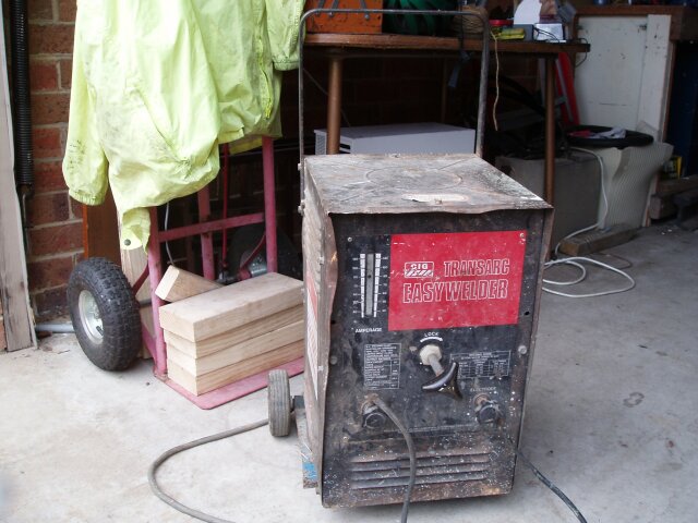

I don't have any access to welding kit, so I made a stub axle which I propose mounting on some sort of bulkhead.
It sounds like we have opposite problems - I have 3 arc welders, but I'm yearning for a lathe! ;-)
I picked up this one from the kerb on "Hard Rubbish Day" last year, nothing wrong with it at all:
