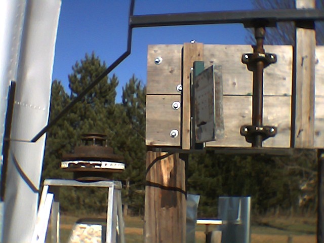

 I was always thinking of building a big axial but shied away from that due the rotor and stator warping.
 The little shiny object near the top is 1 1x2x1/2 mag.The wheel is 4in wide.
 Wondering if i should make it an aircore or add another band of steel and make some sort of pole shoes.
 Would be nice to have direct drive.
 The tower is going to be taller and made of steel and would accomadate this gizmo.
 Have a nice launchpad also.

Re: 32in Radial alt
« Reply #1 on: April 16, 2007, 05:13:33 PM »
i think it would work
is the perimeter of the wheel flat?
the pix look fine to me , very clear.
how much torque do ya get out of that setup?
does the wheel fit the shaft?

Re: 32in Radial alt
« Reply #3 on: April 16, 2007, 05:34:27 PM »
Yes this wheel is flat and i have another that is concaved a bit.
 All i know torquewise is that i cant stop it with 2 hands on the shaft in moderate winds.Need to stick my hand out and bang on the blades.
 Planned on beefing up the shaft and bearings,so yes.
« Last Edit: April 16, 2007, 05:34:27 PM by vawtman »

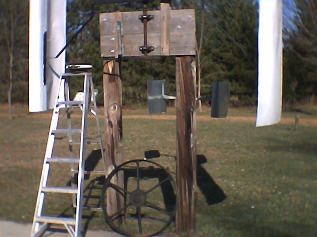

« Reply #13 on: April 17, 2007, 07:09:50 AM »
vawtman;
I have a couple questions about the mount if you don't mind drifting off course a bit. Is that 2 railroad ties stuck in the ground for your posts? They look a bit smaller than ties.
Just curious if it is rigid enough for the forces? How deep are the posts in? I have been thinking of maybe trying a smallish what I think of as an H-vawt [H for horizontal]. That is a "typical" savonious type on a yaw bearing with the wind rotor horizontal. Just deep brain itch to try the design on the farm where I have lots of clear land for a half mile towards our normal wind direction.  Thinking of a couple motor conversions as bearing and alternator in one part [think multitasker] on the ends of the drum. Don't hold your breathe tho I am slow to nearly stationary these days. This idea has been brewing deep in the dungeon of my skull for awhile . General idea being high voltage for ease of transmission combined with low and slow along the field boundaries about 8 feet up. If Ties work ok for the loading they are relatively cheap and easy to put up.
Personally, I can shoot so many holes in this H-Vawt idea it looks like swiss cheese but I still hope to give it a try. Put to rest those rumors that I am anti VAWT.
« Last Edit: April 17, 2007, 07:09:50 AM by TomW »

Re: 32in Radial alt
« Reply #15 on: April 17, 2007, 02:30:42 PM »
Hi Tom
 The poles are more or less a power pole cut in half.14ft long each with 6 of that inground.
 Is it rigid enough for the forces?Yes,but when the turbine hits around 180rpms she'll shake um.Still need to add the other blades.That little turbine in the background has seen 60mph wind but has only a fence post and it actually bent it.Funny it didnt break.
 Could you do quick sketch of your idea i promise not to laugh.
 Thanks for the reply.
« Last Edit: April 17, 2007, 02:30:42 PM by vawtman »

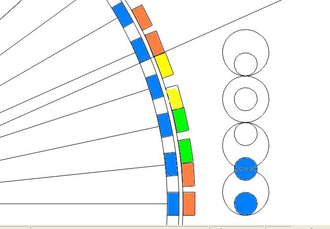

« Reply #16 on: April 17, 2007, 03:34:27 PM »
You could try sixty magnets , at 6 degrees each with 45 coils
the distance between each mag where they touch the wheel is 0.733 inches, for a 32 inch dia wheel.
« Last Edit: April 17, 2007, 03:34:27 PM by willib »

Re: 32in Radial alt
« Reply #18 on: April 17, 2007, 04:34:11 PM »
Willib thanks ALOT for taking the time to draw this up.Make a spacer and your off.

Re: 32in Radial alt
« Reply #20 on: April 17, 2007, 06:05:27 PM »
Hi Flux
 The rotor is 4in wide and the mags 2in long.I wouldnt be stacking them just end to end to cover the width.
 Has far has startup torque goes.Ive seen it drag a cement block trying to start and winding a cable so tight into a bearing almost busted it.Not kidding or bragging here.
 If you notice the 2x4 just to the right of the driveshaft bearings thats all that holds it now in high winds.Kinda weird that it wont backup just stays snug no matter how swirly the winds.Been through 60 mph winds like that and stayed there.
 I think it will cook the axial i thought would work.
 We can beat this beast.Im sure i will need to have a shutdown mechanism unless the additional blades run it into stall.
« Last Edit: April 17, 2007, 06:05:27 PM by vawtman »

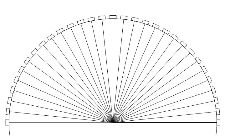

Re: 32in Radial alt
« Reply #24 on: April 18, 2007, 10:09:35 AM »
Hows this for an idea
i used emachineshop and msPaint to make the drawing
the distance between magnets at the perimeter was not 0.733 it was really 0.676 inches sorry , dont know how that happened ..
the magnets are in blue, the coils have their respective colors
i had to linearize the standard way i make my alts , to figure out how the RACA should maybe look.
the advantages of this method are that the coils do not overlap, and therefor you can dississemble it if need be.
and the coils can be made seperatly , on a fixture, and can be made to fit the magnet length (2 inches) more closely than if they were overlapped. thus using a LOT less wire .
each coil 'Leg' can be 1 inch wide
« Last Edit: April 18, 2007, 10:09:35 AM by willib »
Re: 32in Radial alt
« Reply #25 on: April 18, 2007, 03:27:27 PM »
Thanks again Willib
 That would be cool for 3 ph.
 What do you think about 60 coils where 2 coil legs would share the open slot between the mags?Single phase hmmm
 Ive got access to oodles and oodles of stator lams and was thinkin of cutting them in small sections and more or less making odd looking transformers LOL and bolting them to a outer band?Ill make one up so you kinda get the idea.If a coil fails for some reason just repair it and put back.One could adjust the airgap also.
 P.S.im not going double wide with the mags.
« Last Edit: April 18, 2007, 03:27:27 PM by vawtman »

« Reply #29 on: April 18, 2007, 06:53:53 PM »
i dont think much of the single phase idea, or the laminates
the RACA as proposed by Ed and Joe , did not have any laminates ,and with your 15 coils per phase you would only need about 0.66 Volts ac per coil ,to get 14 V dc out and at that dia it should be easy
it really seems like a perfect match to your Vawt.because you have a high torque slow rpm VAWT and an alt that doesnt need a lot of speed to produce power.
as soon as you get your wheel mounted on something you can start testing coils. :)
