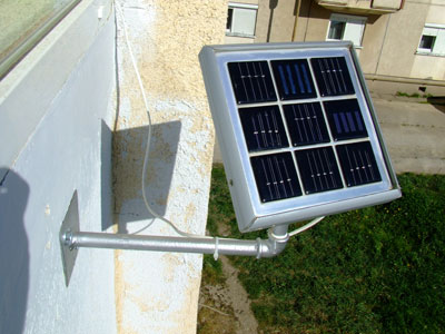

The PANEL

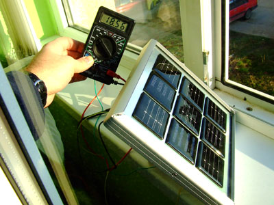

The saga started in one day when a supermarket around here had solar lamps at discount price. So I headed there and buyed 9 of them. There were very nice solar lamps, stainless steel body, a 600mA NiCad inside along with one LED and a booster/charging circuit. I gently took apart all the solar cells on top. This was easy. Too easy, I'd say. The individual output was dissapointing, 2V at 50mA max. But I went on with the plan.

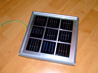

I connected all the cells in series and got 18.9V at 50mA. That's 0.9W of power. Talk about dissapointment... But hey, it's supposed to be fun so let's carry on.

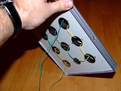

Took some plywood and drilled 9 big holes equally spaced. Put one 0.3mm aluminium sheet over that and glued the cells over the holes so that I can have acces to the poles on the back. These cells were already waterproofed so the only exposed area were the contacts on the back. The plywood received one aluminium frame (I like aluminium) made from a single profiled bar used for stairs I guess...
I connected the cells in series and covered the connecting wires with a sheet of plastic. The whole thing was waterproofed using silicon caulk all over the sides.
The result started to look like a solar panel!

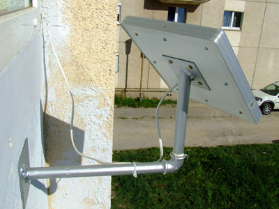

I then made a panel support and put it outside my window. It looks like this:
Pretty neat. My father-in-law suggested me to use gas pipes. And they were already threaded so I could turn the panel on E-V axis.
I also kept all the 9 ex solar lamps in original shape so they could be used again someday. The leds were nice, the batteries were cheap but useful and the booster circuit also usable.
As I was looking at my first solar panel I realized it's just a toy. No real power can be obtained this way except by using hundreds of these tiny cells. The volts were OK but the mA's were way low. So I started to think small. It's not like I had a choice. I'll be using one of my 12V ledbulbs I made a while ago (more about this at http://www.fieldlines.com/story/2007/1/28/215243/977 ) as a load and a 1.3 Amps litle SLA battery I found around here for daylight charging.

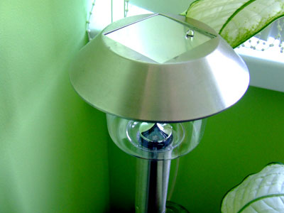

The LIGHT

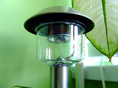

I started working at the ledbulb circuit since I needed it to turn itself off in daytime and on at night. The solar lamps were great for this but the circuit was not usable as it was designed fot 1.2V. So I made a light sensing circuit along with one ledbulb placed inside a solar lamp.
This is the photodiode on top of the lamp.
This is the ledbulb inside. The wires comes trough the lamp's foot and the circuit is inside the lamp's top side. It was nice to use this lamp as I was starting to feel sorry for dismantling them.
This particular bulb takes around 30 mAmps and uses 7 white LEDs. The day/night cycle worked great. No power consumption while turned off. That's was good.

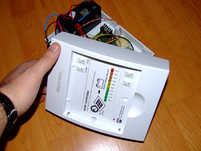

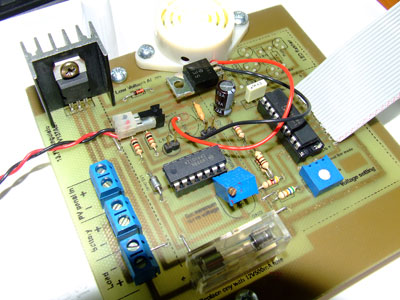

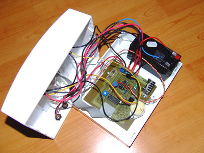

The CONTROLER

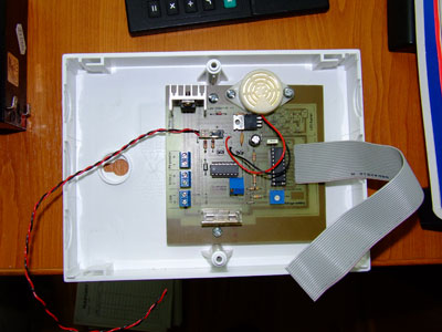

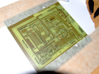

I started making a circuit that featured LOW Voltage Alarm & Disconnect, LED Voltmeter and 13.7V Regulator in one piece. It was pretty hard for a beginner in electronics like me but I made it. This was the PCB. Toner transfer method using regular paper and nail polish cleaner.
The 13.7V Regulator is is in fact a PB137ACV regulator. Thanks Glen for suggesting it to me! It takes up to 800mA (with cooling) and it's so very simple to use. For my need it was perfect. It's a great asset for lower than 1A systems.
As the ordered components started to arrive, the controller was taking shape.

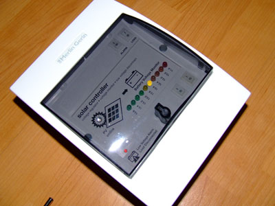

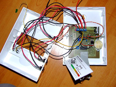

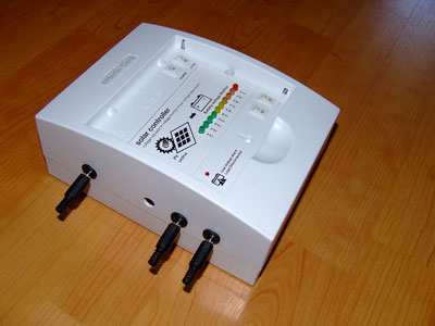

Then, I looked for a fusebox that would hold my circuit along with the battery. I found this one and it looked OK to me.

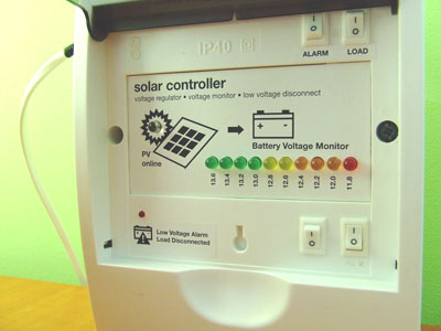

And I started to make the front panel. This was first printed on a laser printer and then all the holes were drilled after the self-adhesive label was laid upon a white plastic piece.
I mounted the switches (Alarm buzzer off, Load on/off disregarding the LVA, Circuit OFF, and some I will explain later.) This was the end result. Pretty good.
The wiring got messy because of the so many options I wanted to have. I drilled holes for the external power connectors. Those are Panel IN, Load OUT (with LVD protection) and Aux IN for a future bigger SLA if I'll have a future bigger panel.
The whole circuit was now complete. Time to test it. Actually, I tested every circuit on this board as I finished it so I expected no surprizes.
I was lucky with this box. A little big and bulky but the plastic was soft and never cracked no matter how many holes I drilled into it.

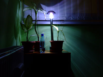

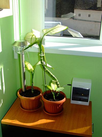

It was time to put it in its final place. Guarding my wife's flowers and taking care of their light without me constantly checking the battery.
This is the final setup. You can see the panel rim outside the window and the lamp in the flower pot. The controller box will be mounted on the green wall behind.

What IC's are used in the circuit to sense the voltage? I'm guessing some sort of op-amp?

Yes, Op-amps. IC's used are LM3914 Dot/Bar display driver and LM339 for the low-voltage alarm. As for the total cost, the parts involved were purchased from various sources and prices while some were recovered from electronic junk.
I couldn't say how much was this all. I'm not even sure I want to know that. I don't need another dissapointment. All I can say is that you must be really passionate to carry on with so little benefits and so many expenses. The next time I'll surely look more careful at price vs. gain balance.

Question? since you've put this together, have you had any extra power to have a dump load circuit? just thing that with those cheap AA-NiCds you have left over, you could arrange them for +11Vdc and let them act like an set of backup batteries.
In as far as taking care of the flowers.=> When you have time, and have the junk stuff around , keep an eye out for the Red LEDs and Blue ones. for younger plants the Red shift light will have them growing with stronger thinker stalks. If you're up to growing vegetables then use the Reds for getting them to stay strong and once on thier 3rd set of leaves switch to Blue.
The Blue shift will help the Veggies and flowering plants to flower and produce fruit 2x faster than normal which includes CFLs plus almost no heat.
The current testing going on in the labs here is 5 Reds to 1 Blue.
That diffenbacca plant you have there will need for you to begin adding extra legs to the light pole:--)

About flowers. Well, You got my wife's attention, that's for sure. Now I'm assigned to make a red&blue light thank you very much :-).
The pole is temporary. I will ad soon a higher wall-mounted spot light and solve the problem. Also this will allow a more evenly spread light since the present lamp has too many reflections, as you can see in the night photo.
