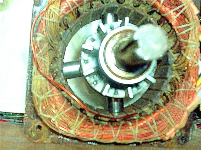

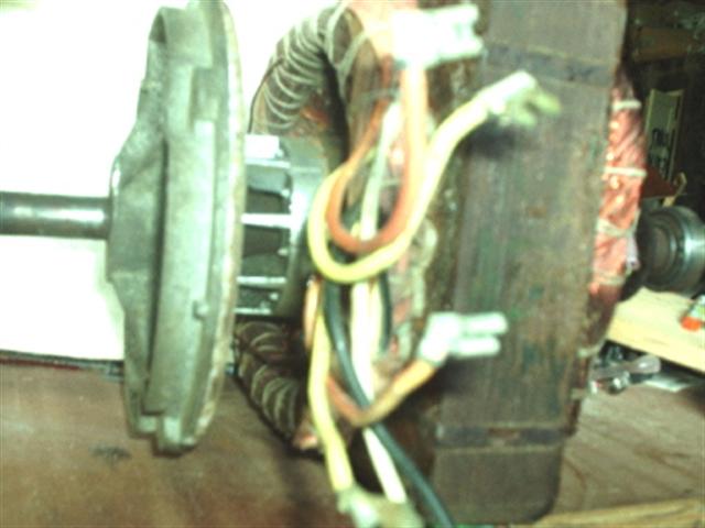

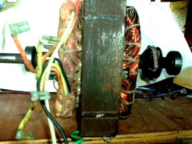

Do to illness; I have not been able to finish several projects that i told Bruce that i would finish . That said I have been doing a little cleaning in the shop and trying to pile the like parts together and came across some interesting items that might make a project some day. This stator is from a Coleman 1850 gas generator that took a saltwater bath and the rotor is from a 5hp air compressor motor. Placing ¾ x ¾ round cylinder magnets around the rotor leaves  me 1/8 "gap between rotor and stator teeth with no milling needed. I know I will have to make a cage for the magnets but it should work.
The stator is wound with two sizes of wire in 24 slots and I was wondering if it could be used as a conversion without rewiring the coils or even if these parts could be used together as a generator. The motor ends will work and the shaft is long enough to make everything fit. Also the rotor is the same length as the stator teeth. I have put a piece of #14 wires in the photo for comparison of wire sizes and the existing wire looks like it might be a bit smaller but not much. Any thoughts or help would be welcome, pole count and any more information that you think is needed... Thanks pepa.

Pepa,
That's a 2 pole alternator.It spins at 3500 rpm, meaning you'll need tons of magnet material or very high speed to get anything from it.
Try looking for a 1 HP 3 phase motor to make a decent conversion.

« Reply #4 on: July 05, 2007, 08:16:34 PM »
Well, pepa, the greenish corrosion would make me kinda nervous about the windings.
Using an ohm meter won't really tell if they want to blow through at 10 volts or higher.
It would be "usable"--but way lower watts out then rated at when used in charging a 12 volt battery bank.
Winding resistance will get ya. (1850 watts/220volts=? amps when maxed stock and that times 12 or 13 volts ain't much for watts)
Using the 2 main windings in series (and the "start" winding rectified separately)  should be 200 rpm or a bit less cut-in rpm, (ballpark guess--but it could be like mine and need the main windings paralleled)
But YES single phase 2 pole gennys will work.
My conversion (single phase 2 pole) is close to your alternator specs and it works at 170 rpm approx cut-in very nicely (7 foot prop--it needs 7 1/2 foot though) when I use the main windings paralleled/rectified and start rectified separately. Cut-in is too low rpm to series the 2 main windings--my blades stall.
http://www.anotherpower.com/gallery/stephent/testing_precedure
But a 3phase motor would work as a better return on work/bucks vs the single phase.
But if the windings are good--and ya have it---??-- your choice.

« Reply #5 on: July 06, 2007, 07:31:04 AM »
If you have `junk' magnets to go with the rest of the `junk'... why not?
Sounds like it wouldn't take you long to try.
To me it looks like it has a good number of turns.
It will take a lot of magnets to get it doing a lot, but I don't think the speed would be unreasonable for a small HAWT.
But I'm not very picky on what I end up with at the end.  If it charges a 12V battery, I'm happy.

« Reply #11 on: July 06, 2007, 09:01:23 AM »
I don't think you have any choice but 2 pole.
("without rewiring the coils")
Advice from someone who never made a decent one?
Try to keep the magnets semi-close together. It's not easy.
I `24 hour' epoxy a few on each side. Wait a day.
Then short those to the rotor with transformer lamination layers, the kind that bends easy.  (Like microwave transformers)
Next I 24 hour epoxy the next couple magnets using more lamination strips to short those to the rotor while placing them.
Repeat until out of space or magnets.
Shorting the flux to the rotor really helps with placing them.
I use those plastic bar clamps to hold things in place.
Don't epoxy the lamination strips down.  :-(
Keep an eye on it for the first few hours after every epoxy secession, the stuff is like grease and they can slide very slowly for a few hours.
Don't put a lot of effort into exact magnet placement... it's like automatic de-cogging.
I never used magnets that tall.  I thought about stainless steel wire zigzagged every which way through the magnets, then a health dose of more epoxy.
