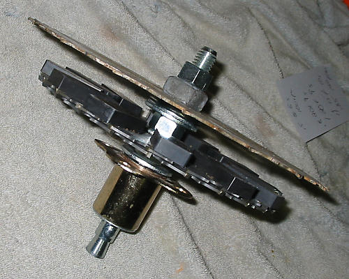

I did this backwards from normal - I made the stator and ran some "test magnets" on it... To get what test data I could, I cobbled together some rotors from ceramic magnets I had on hand and am now wondering if my test data gives any help or at least a guess as to what kind of neo's to use with it.

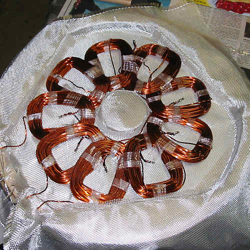

I had some left over wire and resin from my 10' mill so I built the stator that I asked about in this post...
http://www.fieldlines.com/story/2007/1/17/23030/2076
I had enough wire for 9 coils of #15 wire with 40 turns each.
Here's a picture of the stator ready to pour...
http://www.otherpower.com/images/scimages/6527/96_stator_02.jpg
The holes in the coils are 1"x2"; the resistance across two legs in star configuration is .6 ohms.

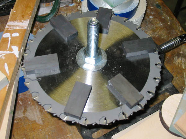

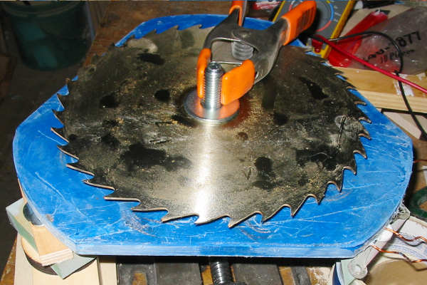

I cobbled some rotors together to test it. I only have some ceramic magnets right now, each rotor has six. They are .9" x 1.8" x .35". I estimate they have a max pull of about 1 to 1.5 pounds. Here's the bottom rotor made of two 8" saw blades.
The top rotor has 6 more ceramic magnets on a single 10" blade.
The magnets definitely link through the 1/2" thick stator; even before I put the top nut on, the top rotor would turn the bottom rotor as fast I could turn the shaft. (And the back of the blades don't seem magnetic so I think I'm getting about as good a flux path as could be had with these little magnets...)
Basically:
  1. x 1"x2"x3/8" ceramic magnets, 1.5 pounds of pull
  2. coils of 40 turns of #15 wire, 1/2" thick stator
.6 ohms across two legs in star configuration
air gap, about 3/32"
With this setup I'm getting about 1 volt peak to peak (.6 to .7 volts rms) at 120 rpm. Any way to tell (or swag) what I'd get with neos?

The only thing there that I intend to eventually use is the stator. I was wondering if anything could be inferred about the possible results with neos from the tests with the weaker ceramic magnets.
What am I trying to do? One of the disappointing things about my 10 foot mill is how heavy it is... I can barely manage to move it around. I want to explore making a compact and lighter alternator. As for the coil arrangement, my hope was that one magnet (or set of magnets) would energize two coils at once... I don't know if it works like that or not. I did look ad Ed Windstuff's arrangement but I think that would result in a larger and heavier alternator not a smaller and lighter one.
Getting "the most" out of my wire isn't my goal. I'm hopping for "pretty good" in a overall smaller size.
I'm not so much worried about voltage. I can make a voltage booster if necessary (thank you!) I am wondering what kind of power might be extracted from this stator and what size blade might be used. (I'm not expecting a "large" blade. With that I can then figure out the mechanicals: what I need for rotor plate, shafts, bearings and hubs.

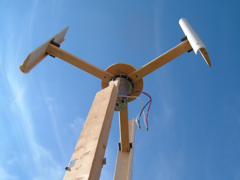

if you want a light weight mill..
 here you go..about 20 pounds ? good for 200+ watts or more--i chopped the blades ,,
 they were longer--didnt need all that power..keeps my motorhome batt. charged all night--with the furnace motor going--cold up here in the winter dont you now..:}
its powered by ceramics  with small neoes glued to the top of the ceramic mags..
check out test stand mill in my files --its all made from wood--so far its survide
45-55 winds --and its a few years old--still puttin out the juice,, stator is made from plywood with coil cut outs--its all sealed up with layers of varnich--and paint..
the rotors are sawblades doubled up..works for meeeeeeeeeeeeeee.......
if you want more info drop me a line.......hiker at adnmail dot com
« Last Edit: July 20, 2007, 05:47:45 AM by hiker »

Thanks Flux.
That rotor setup wasn't really doing what I expected... thinking "one magnet energizes two coils" at once, I expected 60 hz at 60 rpm but that didn't happen; in was 60 hz at 120 rpm. I placed the 12 magnets on one rotor
This way, I do get 120 hz at 120 rmp but only about .85 volts. Less than before but I only have magnets on one side. So (no surprise to folks that know, I guess) pound per pound, opposing magnets work best...
What about dollar for dollar? When I go shopping to replace the ceramic magnets, I can get 24 pieces of 1.5" x .75" x .25" (26 pound pull) neos for about the same price as six 2" x 1" x .5" (70 pound pull) neos... which setup would make more power?
(The test alternator is what I had on hand, saw blades and a wheelbarrow wheel hub. I will get real disks for the rotor and am looking at hubs from racing go-karts as we have a track two driveways down the road.)
